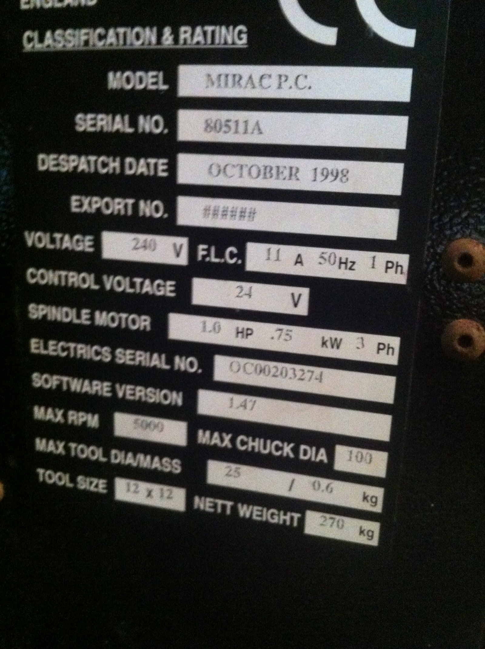

hi steve
i use lathecam only or write programs by hand.
it seems miracpc only accept ".mir ".
mirac software use actually usuals tools, rough, part, boring bar, but don't know internal threading tool.
it can used "g71 two lines" and "G76 two lines", so you can do manualy programs to internal boring and internal threading.
- IMG_mirac.jpg (1.05 MiB) Viewed 23724 times
Re: threading with lathecam
sorry for the picture size
gilles
