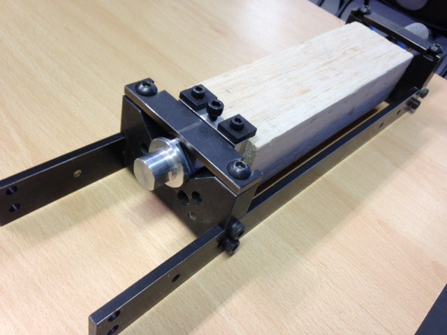

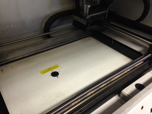

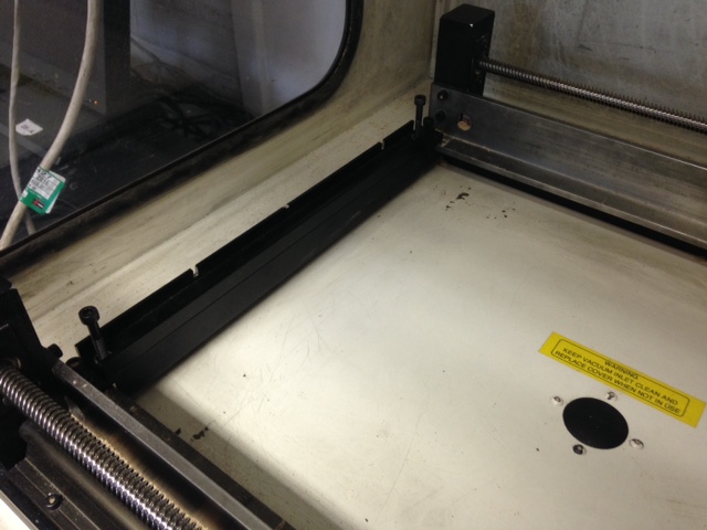

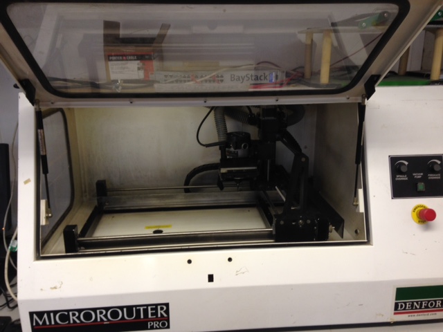

I am very new to the Denford Micro router and even newer to the F1 in schools programme.
We have an old Denford that we hope to use and the latest software loaded on a PC ready to drive it. We have successfully carried out some 2D milling so we know everything works as it should.
Regarding the F1 in Schools programme
Our school is very keen on taking part in this prestigious event but, like many, our budget is very tight. We have been lucky in obtaining an old style F1 jig that, with a little modification, we hope will see us being able to participate. However, our router is not fitted with a T Slot table/bed so I wondered if anyone has experience of fitting the F1 jig to a Denford router without?
The jig we have looks as though it needs a couple of L angle brackets (see images) which I assume we can purchase from Denford but what else would we need to secure it to our router? A description or a picture of how this is secured would really help.
I have attached some pictures of the various aforementioned in order to clarify what we are working with.
Any help or links would be appreciated.

- pic 4
- IMG_2561.JPG (83.78 KiB) Viewed 33250 times
- pic 3
- IMG_2560.JPG (89.84 KiB) Viewed 33250 times
- pic 2
- IMG_2559.JPG (88.8 KiB) Viewed 33250 times
- Pics of the equipment we have access to
- IMG_2558.JPG (99.32 KiB) Viewed 33250 times
Re: F1 jig and fixing to a Micro router pro without a T slot
If you take a look at the attached manual on page 37 you can see how the fixture is fitted.
If you can't find the original rails you may be able to modify the manual clamps you have. You may also need to cut down the side bars to suit the F1 car model block.

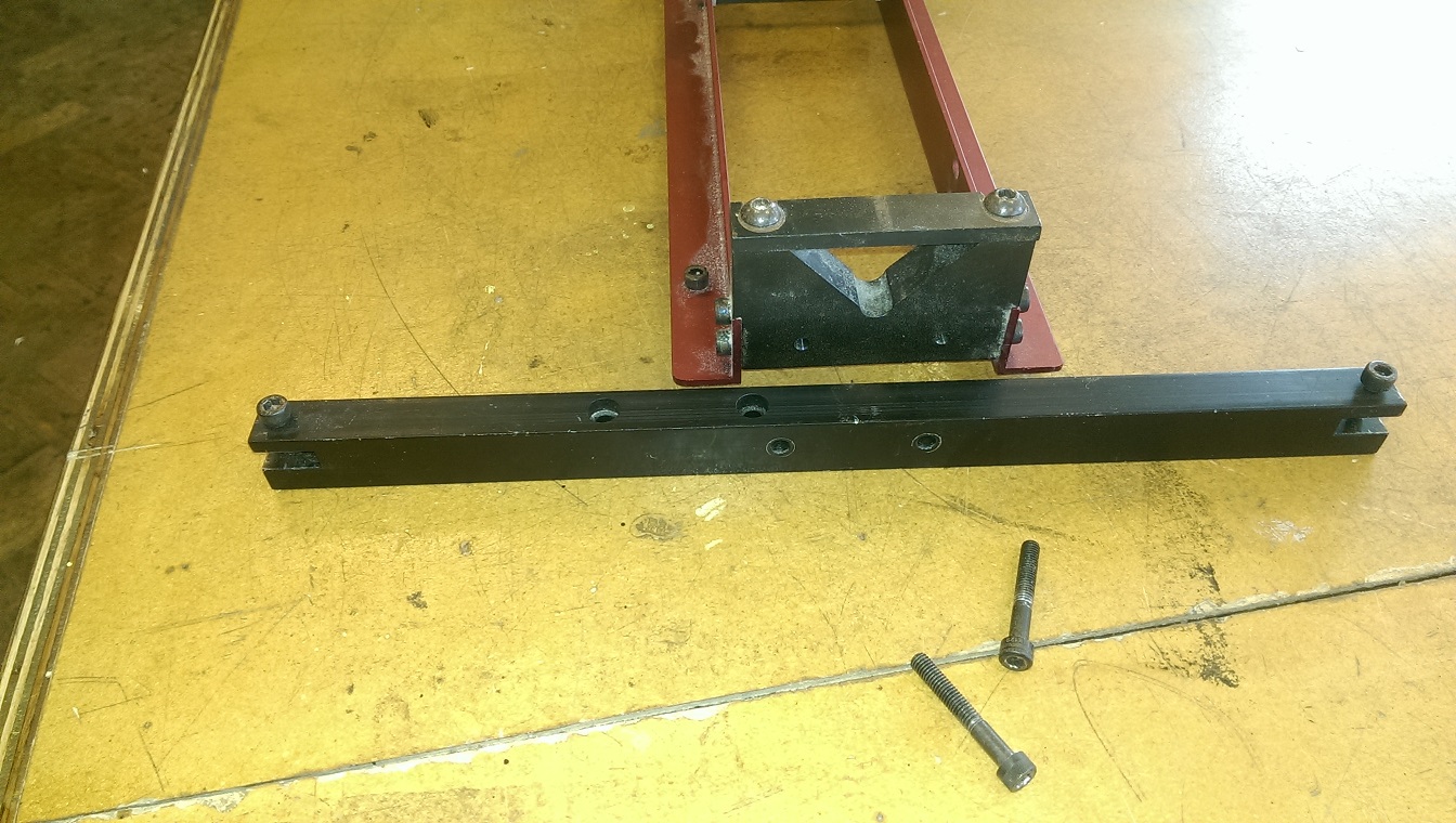

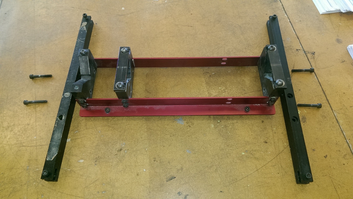

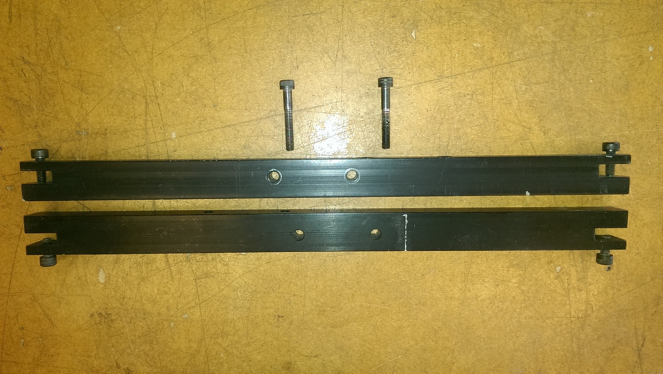

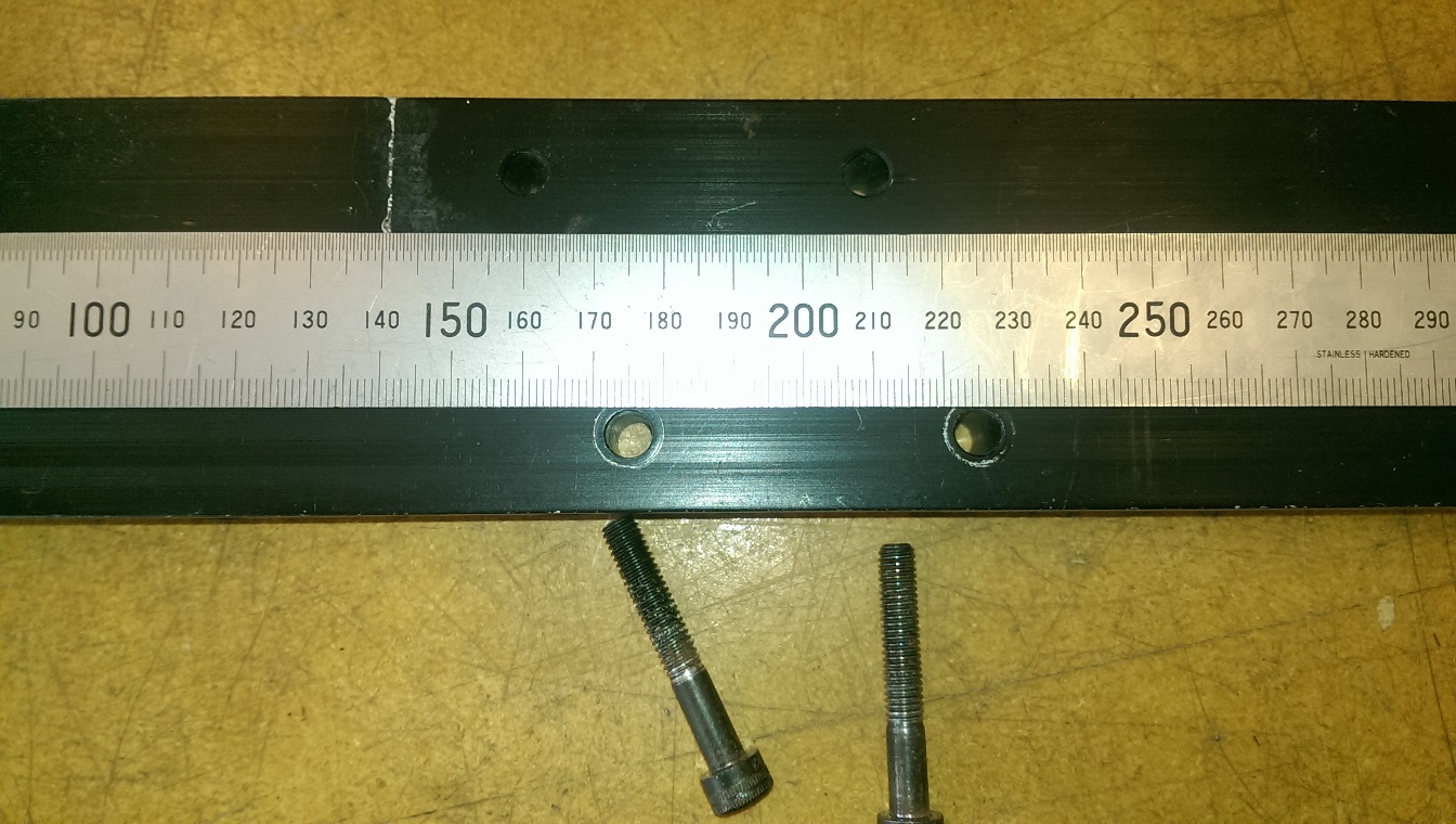

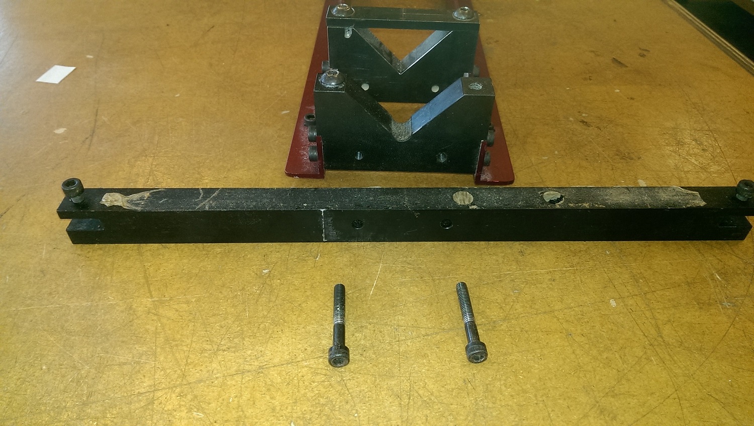

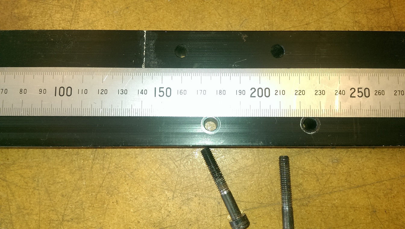

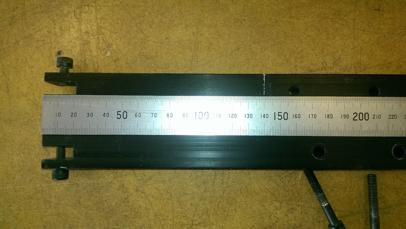

Here are the pics, My frame has an extra 'V' block, you could just cut down the L angle so you can fix direct to you blocks. For some reason the end bar mounting holes into the V blocks are not centred. I can't see this being an issue as you have to zero the cutter to the job anyway. In the microrouter where the end bars fit onto the aluminium rail mine has had t bits of aluminium glued to the top edge to make it easier to re align the F1 set up when it has been removed to do other work.
Hope it helps.
Hope it helps.
- IMAG0913.jpg (327.98 KiB) Viewed 33207 times
- indication of hole centre distance
- IMAG0912.jpg (386.94 KiB) Viewed 33207 times
- Indication of distance from the end to holes
- IMAG0911.jpg (356.29 KiB) Viewed 33207 times
- End rails showing offset to each other as one is flipped to indicate they are not centred
- IMAG0910.jpg (400.24 KiB) Viewed 33207 times
- Whole frame, you can see for yours you just need to cut the L angle down so you can mount into the V blocks
- IMAG0909.jpg (354.93 KiB) Viewed 33207 times
