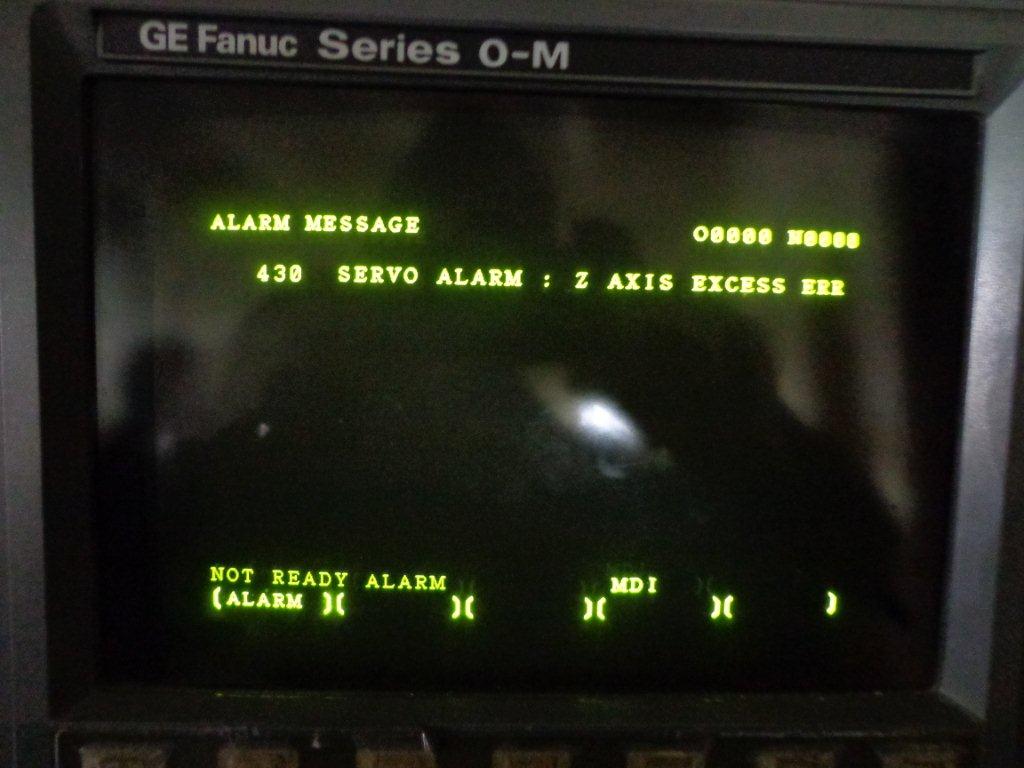

sir fist of all many thanks for providing me the parameters list.
i have entered all parameters according the list but i did not know how to call diagnostics on the control screen. second thing all previous alarms are cleared know but a new alarm message is appeared, i am sending you a photo of this new alarm.
i am waiting for a kind response.

You should have a button labled DGNCS/PARAM or similar that togles between parameters & diagnostics. You may need to be in Edit mode to change the values.

I have the same problem as pic attached By Mr. Jamil.
Kindly help me out.

Does the axis jump slightly when you power it up?
Also is the axis free to move? (Can you turn the motor pulley or leadscrew).
