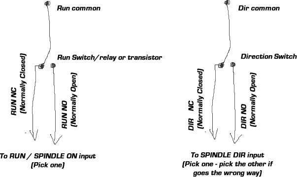

Re: Spindle drive connection
This sketch might help you visualise it
- spindle-run.jpg (27.37 KiB) Viewed 26795 times
OK?? Still little bewildered -
Something like this
Run
NO > No 2 wire spindle On
C > No 3 wire spindle On common
NC > No connection?????
Dir
NO > No 4 wire spindle Fwd
C > No 5 wire Spindle Dir common
Yep that sounds about right
