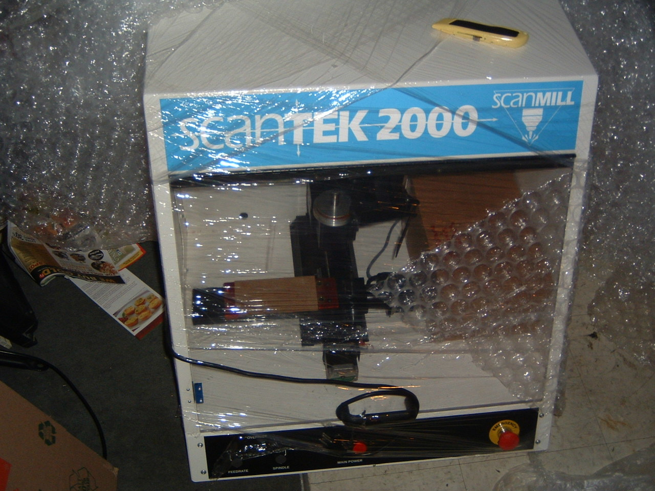

i was wondering who makes the controler for Denford micromill 2000NS so I know what type of post processor to use in bobcam when creating G code. does it use some sort of FANUC?

If the machine control hasn't been changed then it's probably a Baldor controller with the Denford VR milling software to control it.
If so, there is some post processor information here:
https://denfordata.com/bb/viewtopic.php?f=16&t=1370
