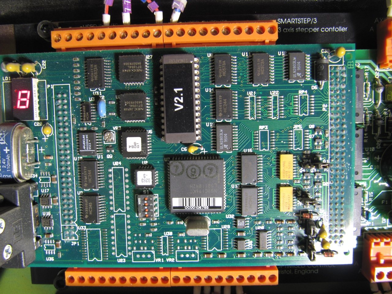

Before I do anything foolish ... do I remove the board on top of this, then make up a connector to connect to the aforementioned pins? As far as I understand it... (simplifying things) I need to bypass any of the Denford control stuff that interfaces with old Denford software, and get the PC's parallel port talking / controlling the stepper drivers, end stops, milling head, and so forth. Is there another post that I've missed that details this stuff? Has anyone used linuxCNC with the Novamill? Should I use other software? I have EMC linux installed and would be happiest using that if possible.
Any advice would be appreciated - if I need to move this post to the Novamill section of the forum, or similar, please let me know.

- Is this the board I need to remove?

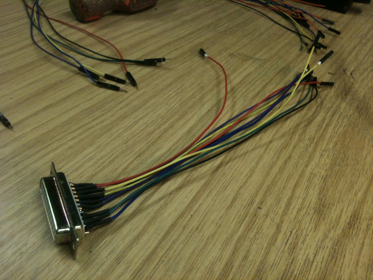

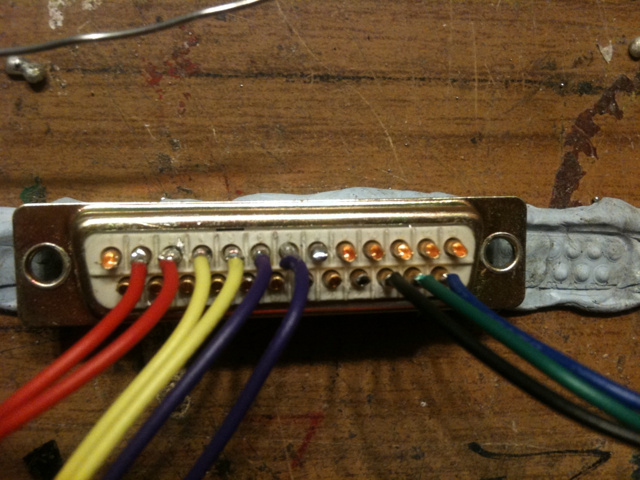

I removed the top board and de-soldered the original wires from the 25-pin chassis connector on the control box case.
Connected the X,Y,Z axis step, DIRs and GNDs as stated here viewtopic.php?f=4&t=2264
I used some nice jumper/connector cables to connect directly to the massive header - easier than sourcing a 96-pin connector!
Connected to LinuxCNC stepper test program - and, it lives!
Found that the axes didn't quite like the velocity of 1500 mm/s and accel of 150 mm/s2
Values of 150 mm/s and 150 mm/s2 seemed to wrk well - though each axis seemed to differ in how well it handled higher speeds. More testing required.

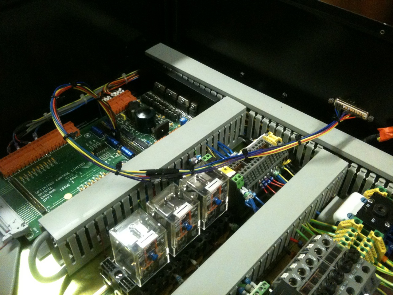

Hi all,
so, thanks to user RNR107 I now have my mill up and running.
Decided against computer spindle control - settled for an on/off switch and pot for speed control. This seems a lot easier than the computer controlled option!
Both the switch and pot were wired directly to the Sprint control board:
- switch across inputs 4 + 5
- pot across inputs 1, 2 + 3 (middle pot pin to input terminal 3 on sprint board)
