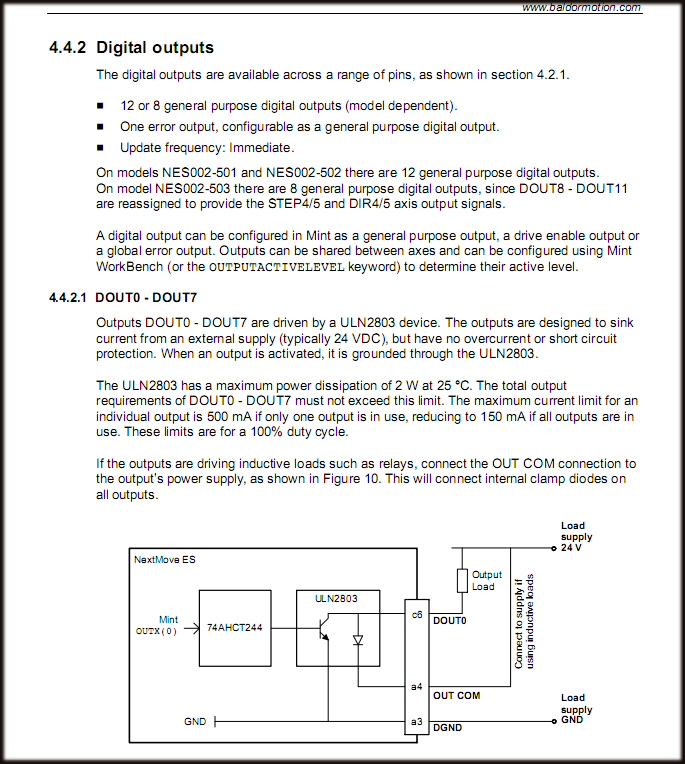

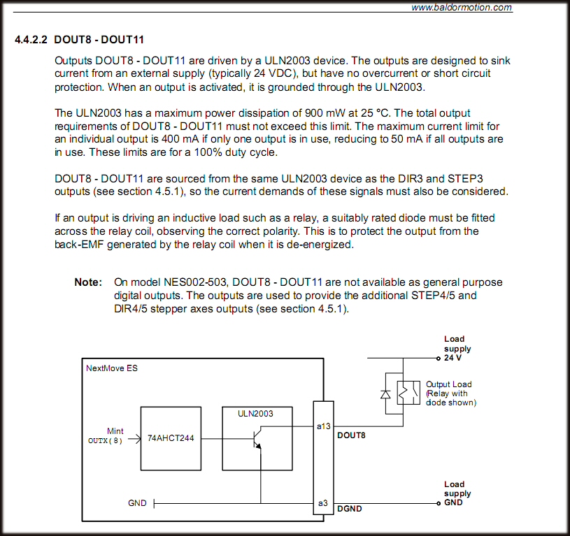

Re: Baldor Nextmove ES DOUT8-11
Hi. Does this help, on some cards the outputs are reassigned?
Tom
Tom
- Image2.jpg (331.04 KiB) Viewed 7862 times
- Image1.jpg (309.57 KiB) Viewed 7862 times
