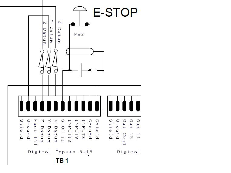

This picture may help. Hopefully is may be just a loose wire
Compact 1000 E stop.JPG (37.7 KiB) Viewed 6556 times
Post by Steve » Sat 21 Mar , 2009 12:44 pm
Bradders is on the right lines.
On the Compact 1000 we use 2 sets of contacts on the E-stop button.
One set controles the E-Stop relay. The other sends the signal to the Control card.
I assume the E-stop Relay is switching as you press and release the E-Stop?
If this is the case then the problem is with the second contact on the pushbutton.
I have seen the occasional button that is faulty but it could be the crimped connection on the button terminals or at the control card end.
If the relay is switching then I suggest you check the connections at the button end.
