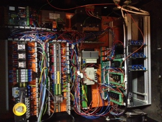

Hi, sorry for the late reply. Thanks for the suggestions. We checked the SGR and that was seated fine. Also, we took the top off of the motor and the brushes looked fine and there was no carbon build up. We are a bit stumped as to what to do next. I guess we have to fault trace from the control box but it looks a bit scary in there. Please find attached a photo of the guts of the control box.
There is a board in the top right hand corner labelled down ramp, min and max speed. It has 6 thin wires and 4 higher current wires attached. It looks more modern as it is all surface mount. The bigger wires are labelled 16, 17 19 N and 2.
There are four transformers and one power supply unit rated 24v dc. At the bottom of the box are the control boards for x, y and z axis. Above these are two homemade boards, one labelled op1 op2 and op3 and the other with 5 small relays. There seems to be a commercial board from DIY CNC.co.uk feeding the home brew stuff. In the main body there is the wiring loom, four power relays the SCR, SRR, ESR, then one called CCR lower down. There are four possible relays in a mount called: CIR CDR CBR DPR COR.
Many thanks for any help you can provide.

I think you're right, the T1 and T2 wires will be tacho...can you check that they are actually connected back to the drive though...Not all machines use the tacho for motor speed feedback - sometimes it just uses armature feedback. If it is just tacho then check that separately somehow - if it can be removed, run it with a drill and see if the voltage produced it steady.. it may output something like 30v per 1000 RPM, should say on the nameplate eg, 30v/KRPMBehind that is the motor and we see the following wires labeled: T1, T2, K1, K2, A1, A2. A1 and A2 are thicker
If the tacho isn't connected then check the drive command input is steady and that the brushes and commutator are all good.

It looks as though your machine has been upgrade to Mach.
You may need to measure the analogue voltage in to the sprint 1200 drive. You should be getting around 10 volts DC at top speed.
The Tacho should output 9 volt DC per 1000 rpm.
You can disable the tacho if you want to try without it but you would need to reset the drive first.
