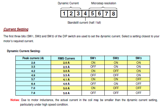

If you take a photo of the stepper drives in the back of the machine there is a current option on the Z axis that can be changed.
The settings are by default:
MSD880
1 OFF
2 ON
3 OFF
4 OFF
5 OFF
6 OFF
7 ON
8 OFF
5000 Pulses/Rev 4.6A RMS
I would just lower the rapid on all 3 axes to 4000mm / Min and all will be well.

Post by johnparker » Fri 10 Jan , 2020 18:24 pm
I am up to date with V5_68
My drives are set:
1 ON
2 ON
3 OFF
4 OFF
5 OFF
6 ON
7 OFF
8 ON
Which the datasheet tells me is 5.7 Peak, 4.1 RMS, so one setting softer than your default listing
Re: 1300 Pro Z axis brake applied on rapid home or toolchange
Post by Steve » Sat 11 Jan , 2020 19:02 pm
Set as our default should help.

I did the adjustments per Steve's posts and added the heater on lowest setting and now can home and toolchange without issue. I'm happy the G28 goes to top of Z before homing X and Y. Thanks both
