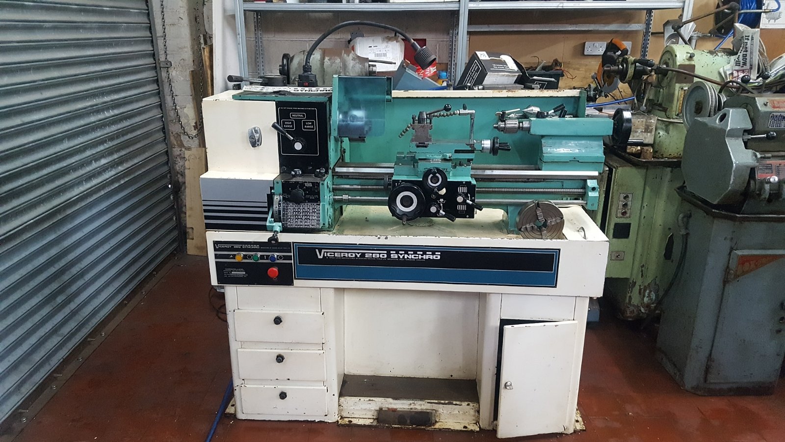

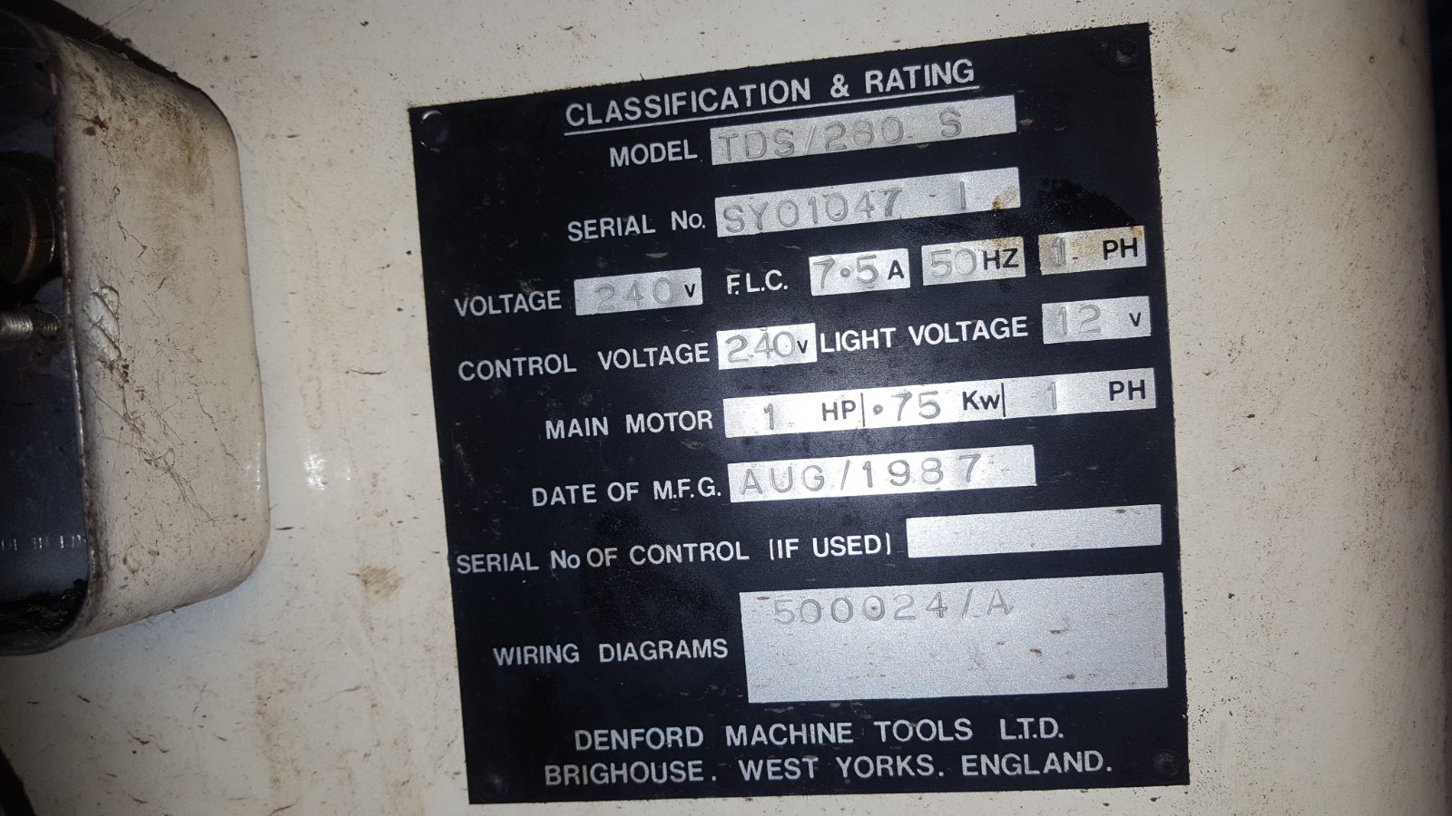

hello gentlemen and ladies, I have just bought this 280 synchro and looking for a wiring diagram it is a single phase machine and at some point it has been hacked by an electrician who replaced the motor, can anyone help also a manual would be great. I have quite a few original manuals for the tds and sharpedge plus drawings and would be happy to forward them to you for inclusion on the site if needed.
thanks Mark

Hi Mark,
I've added 2 wiring diagrams for the 1ph machines (2 motor options) in the post 'Synchro Wiring drawings' this thread : viewtopic.php?f=50&t=2960
I've not found a manual for the Synchro, but for the most part (slinging, installation, lubrication, gearbox and apron controls) it will be the same as the 280VS.
I've put a manual for that in the same thread.
There's another version of it (slightly different) which is too big to post, but if you pm me with your email address I can send it direct.
