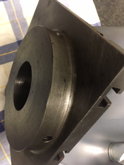

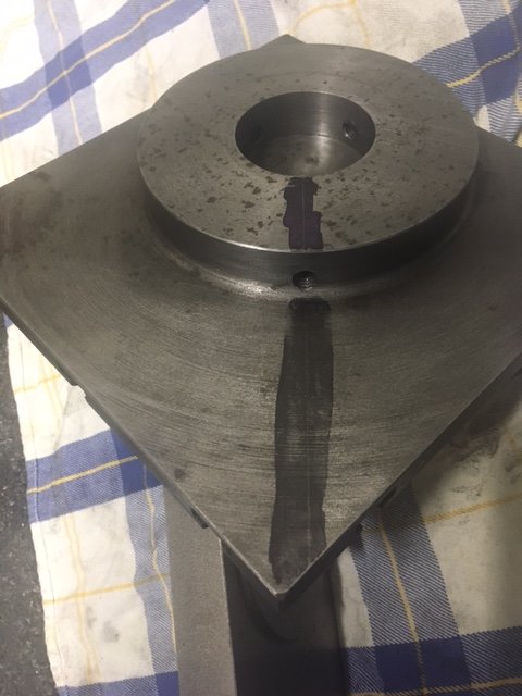

I have a boring table that came with the lathe which I believe is a Denford item, used it for the first time and whilst drilling from the headstock it rotated a bit and ruined the job !
The table replaces the top slide and fits over the upstanding dovetail spigot on the saddle, two hex grub screws push angled slugs onto the dovetail spigot - same as the original topslide except there are only two set at 90deg, not 3no as per topslide (90+135+135deg set out). I had tightened them as much as normal as I didn't want to damage the spigot surface etc but it rotated under moderate pressure - have to feed using leadscrew handwheel.
I can't find a drawing of the table to see if it should have a third fixing - anybody have a similar item / drawing ?
The catalogue pic shows a similar table but it has extended screws beyond the edge of the table.

I'd say that is a rare item. God knows even steadies are few and far between.
Personally I woud fabricate a post that locks into one of the saddle tee slots and has an arm with a clamp on the end that grabs the edge of that table to stop it from ever rotating. Those wedge pins are just not going to have enough grip.
Of course there's nothing to stop you from simple adding more wedges by drilling and tapping extra holes.

Yes indeed, the further away from the pivot centre the greater the forces trying to rotate the table. If you had your drill hole centred on the pivot it would not turn at all.

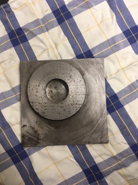

Well to close this one, I've added a third fixing to match the topslide i.e 90/135/135 deg set out.
As I thought drilling it was rather difficult as it was on the long diagonal - I don't have access to large machines etc but found the top slide was the correct drilling height for the dowel hole !
So clamped it to the slide, made an extended centre drill and found a long series 7.9mm drill (165mm long) that was just long enough !
Very restricted access for tapping the long 3/8" Whit thread.
Hope that has sorted it !
