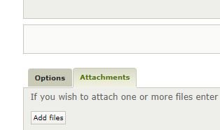

You don't need web hosting to add pictures on this forum - just click on the 'Attachments' tab below the message content.
or drag / drop a file.
