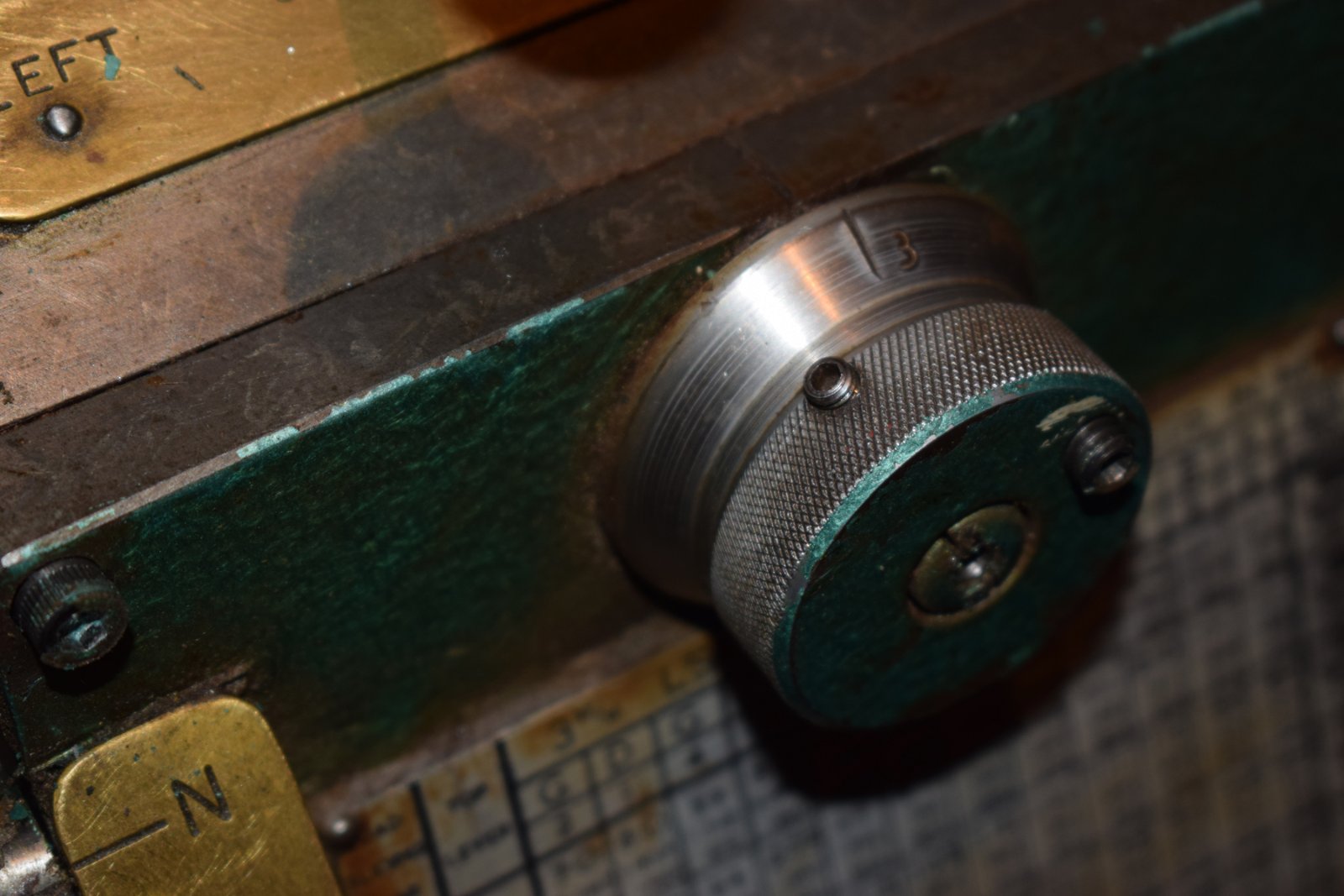

- Hi me again (not so smart Art LOL) After trying to get my head round the different feed setting. following the directions in the denford Manual my selector dial stopped turning and is now stuck I have released the two grub screws and the centre slotted nut but it wont budge. I think something inside the gearbox is jamming. My Q. is how to take off the front plate of the G Box and is this feasible. Any help welcomed

You did have the main spindle and the gearbox drive train running when you were trying out the selector knob didn't you, with the lever on the left hand end of the gearbox in neutral?
I've never done it myself but I understand from reading about the experiences of others on this site, that taking off the front cover and managing to reassemble it again isn't for the faint hearted, so is absolutely the last resort.

Have you put the lever on the left back up to the top position?
Until you do that, the dial selector is locked.

I would suggest spraying the gear selector knob with release oil, try to get it down the back to the where the shaft goes into the gearbox.
The lever on the left must be in the fully up position before you do anything else, as stated.
Make sure the gearbox is filled to normal working level with oil, check the sightglass.
Are the gearbox input and output shafts free to turn ?, if so turn them by hand using the drive gears, not motor.
Reassemble it and attempt to wiggle the knob, it might free off, do not use spanners or mole grips on the shaft.
Take things slowly, do not take anything else off !
As has been stated the gearbox is complicated and spares are virtually unobtainable.
Good luck,
Les.T.
Good luck,
Les.T.

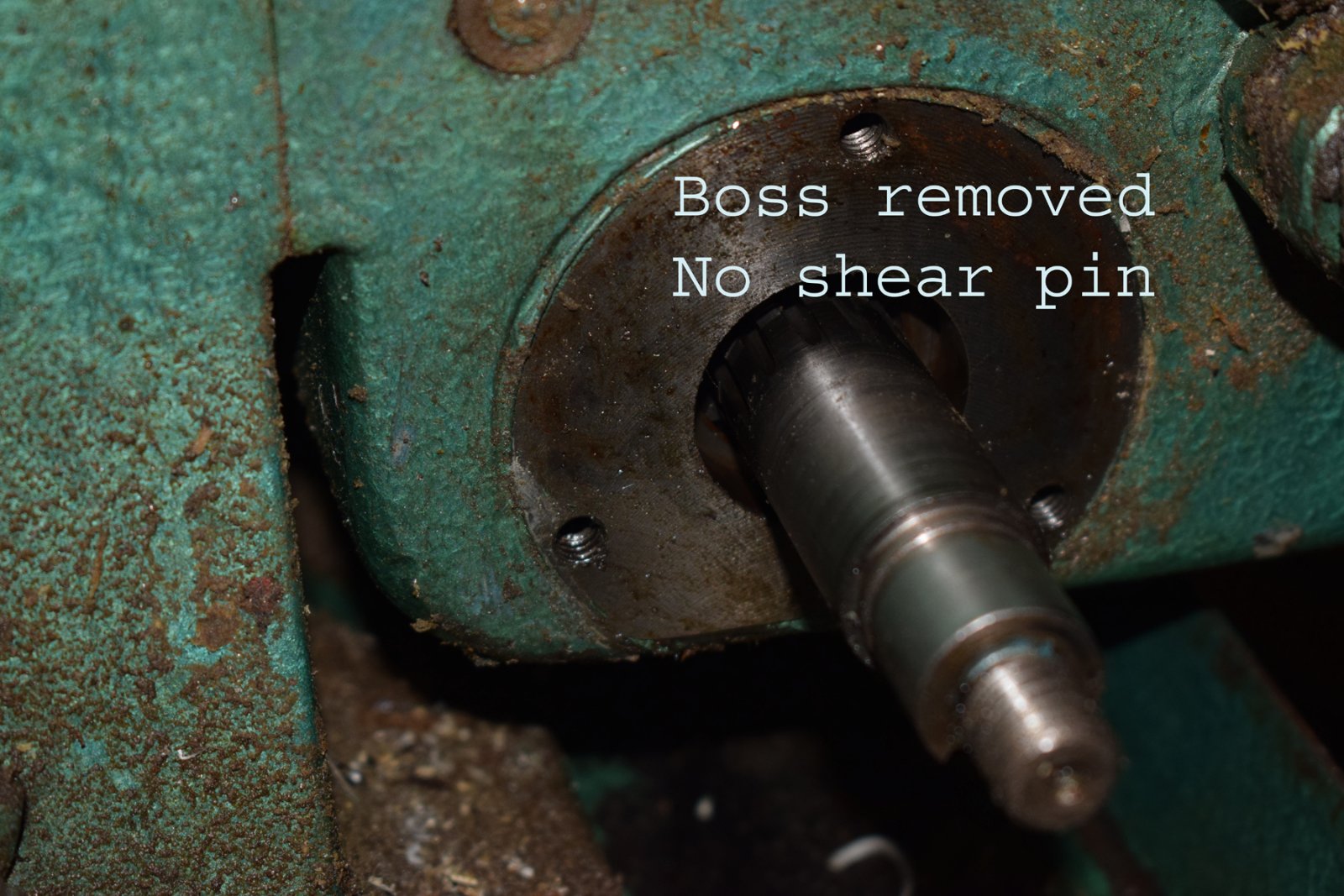

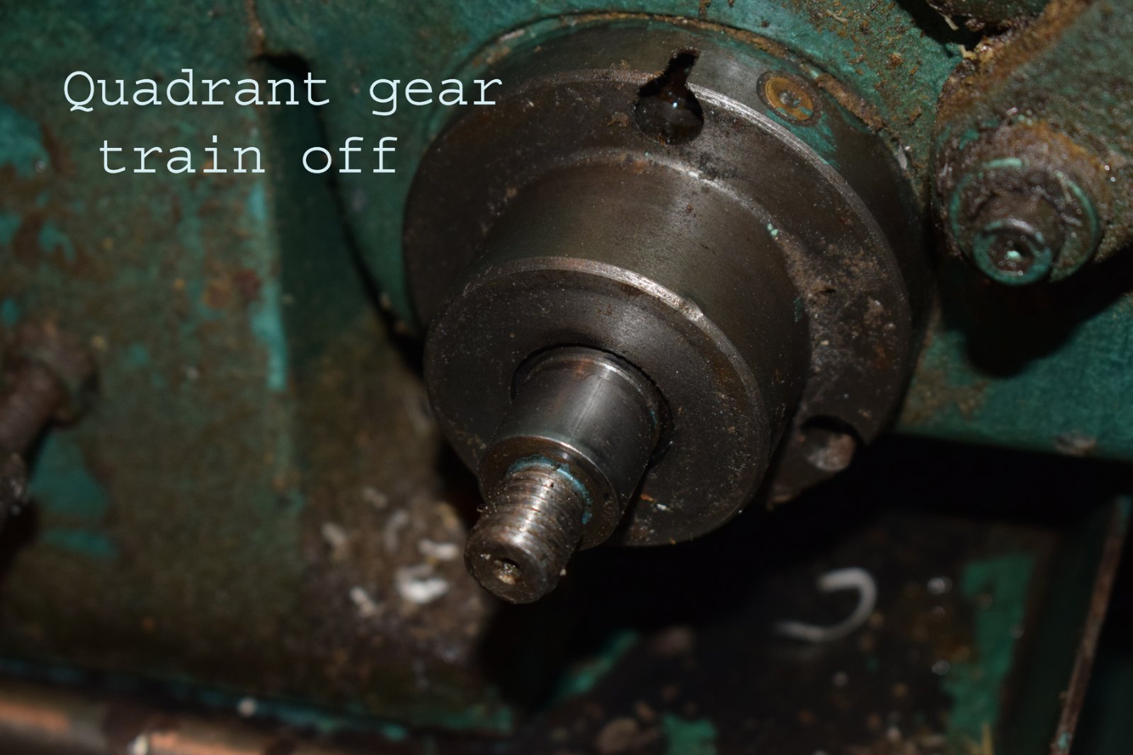

There is a shear pin in the drive to the gearbox, and its worth checking that before you even think about trying to take the cover off the gearbox.
You need to undo the screw in the middle of the gearbox input shaft and remove the 2 gears. You may need to remove the quadrant with the other gears in order to do so. The hub the 2 gears fit onto should have a 1/8" dia shear pin securing it to the gearbox input shaft. Shear pins like this are notorious, when sheared, for at times being able to transmit a light load, before slipping again. If the input shaft isn't revolving you will not be able to move the selector dial.

Hi Richard. Will check the shear pin but all the gear train is moving as should, the input shaft to the gearbox is rotating and the end of the shaft which is flush with the side of the gearbox is rotating (as expected)
I am meeting the vendor tomorrow and will be raising this with him.
Thanks once again
Thanks once again

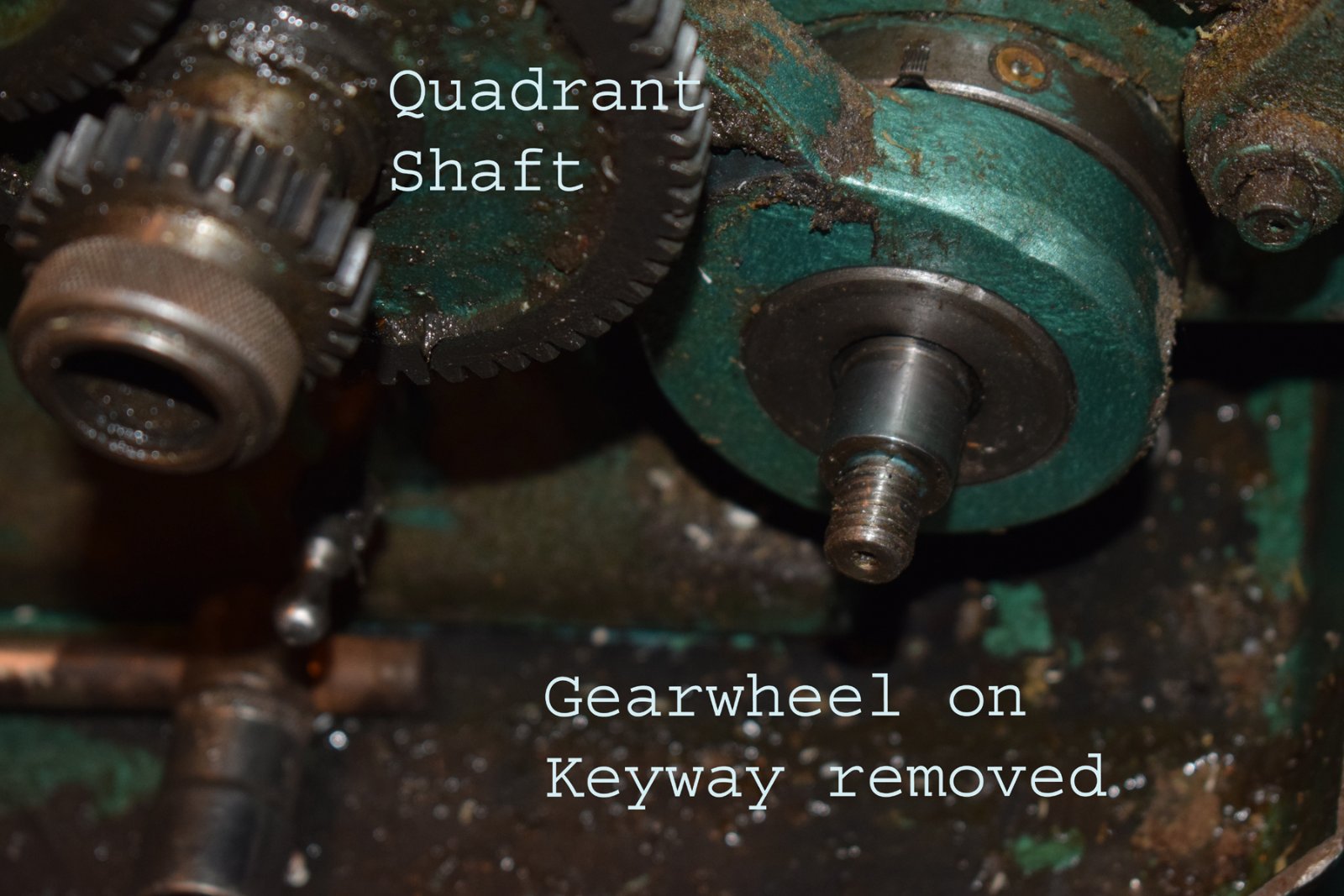

- Posts: 28
- Joined: Sun 15 Sep , 2019 14:47 pm
- Hardware/Software: Denfird viceroy lathe
- Location: Bolton lancs
Re: Selector Dial stuck
- Gear2.jpg (207.6 KiB) Viewed 13481 times
- Gear 3.jpg (180.42 KiB) Viewed 13481 times
- Gear 1.jpg (209.83 KiB) Viewed 13481 times

I can't see it in your photos, but the big gear you removed was keyed to the input shaft wasn't it? Some of them used the key as the shear device rather than a pin.
I'm getting desperate here, but when I was playing around with my gearbox this evening, I noticed that the lever on top of the gearbox which selects feedscrew or leadscrew has a small mid position in which neither shaft is selected, so results in no output from the gearbox. Might be worth checking the position of that lever.
Apart from that, I regret to say I've no idea.
