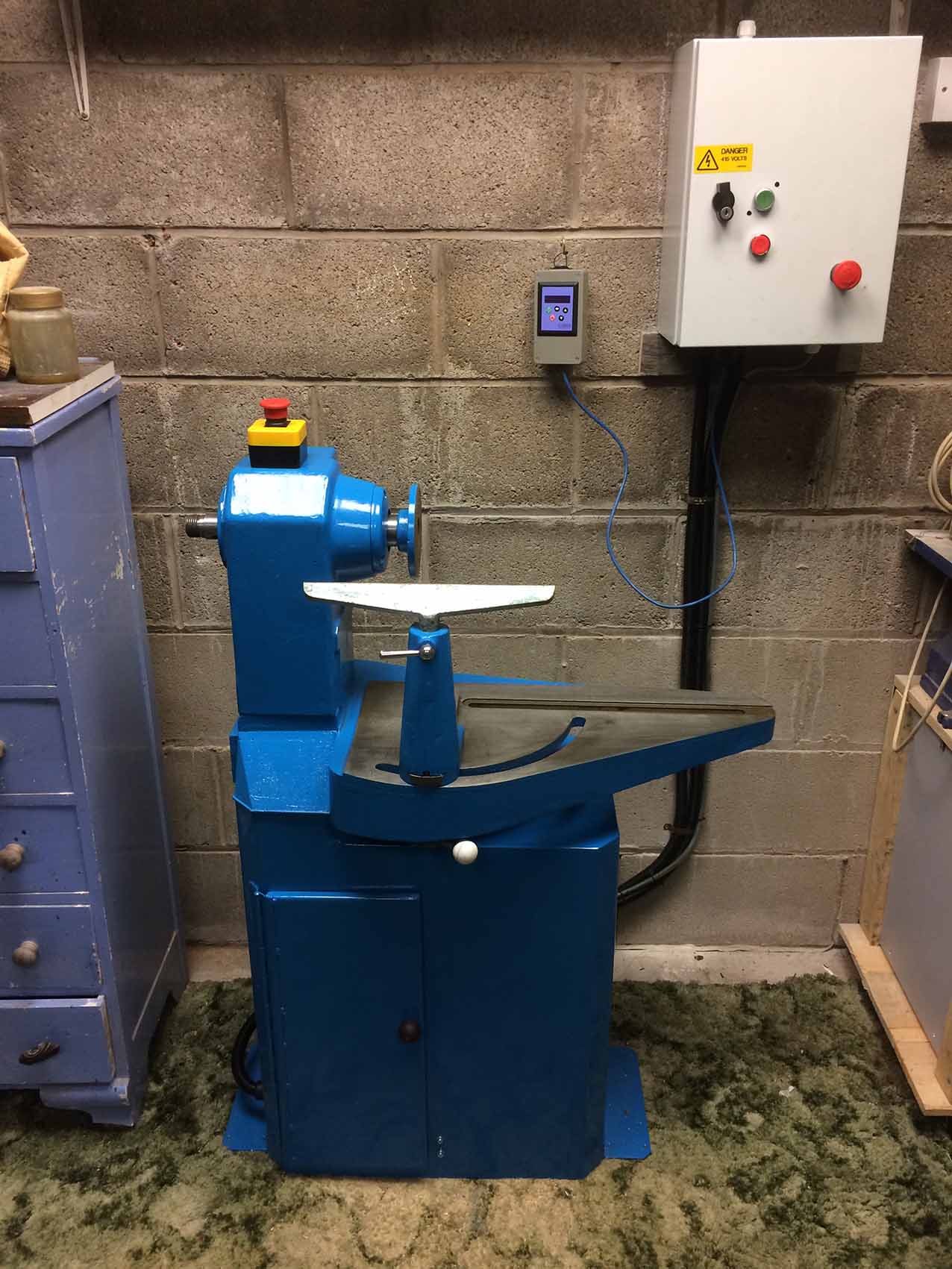

Hi all thanks for the experience, your probably correct I am over thinking but that's what I do, guess it's my engineering background and experience with working with computer systems for 25 years.
I think I will take your advise and use the built in ramp down to stop the lathe. With using the remote keypad for main control, start stop and speed up / down this would use the ramp down option to stop. I can indeed wire the emergency stop in to the stop circuit option so ramp down is used. I agree a controlled stop / ramp down is better than a free overrun
Will advise when I get it wired and tested.
Thanks for your advise experience
Re: Viceroy TDS6 Drive Belt

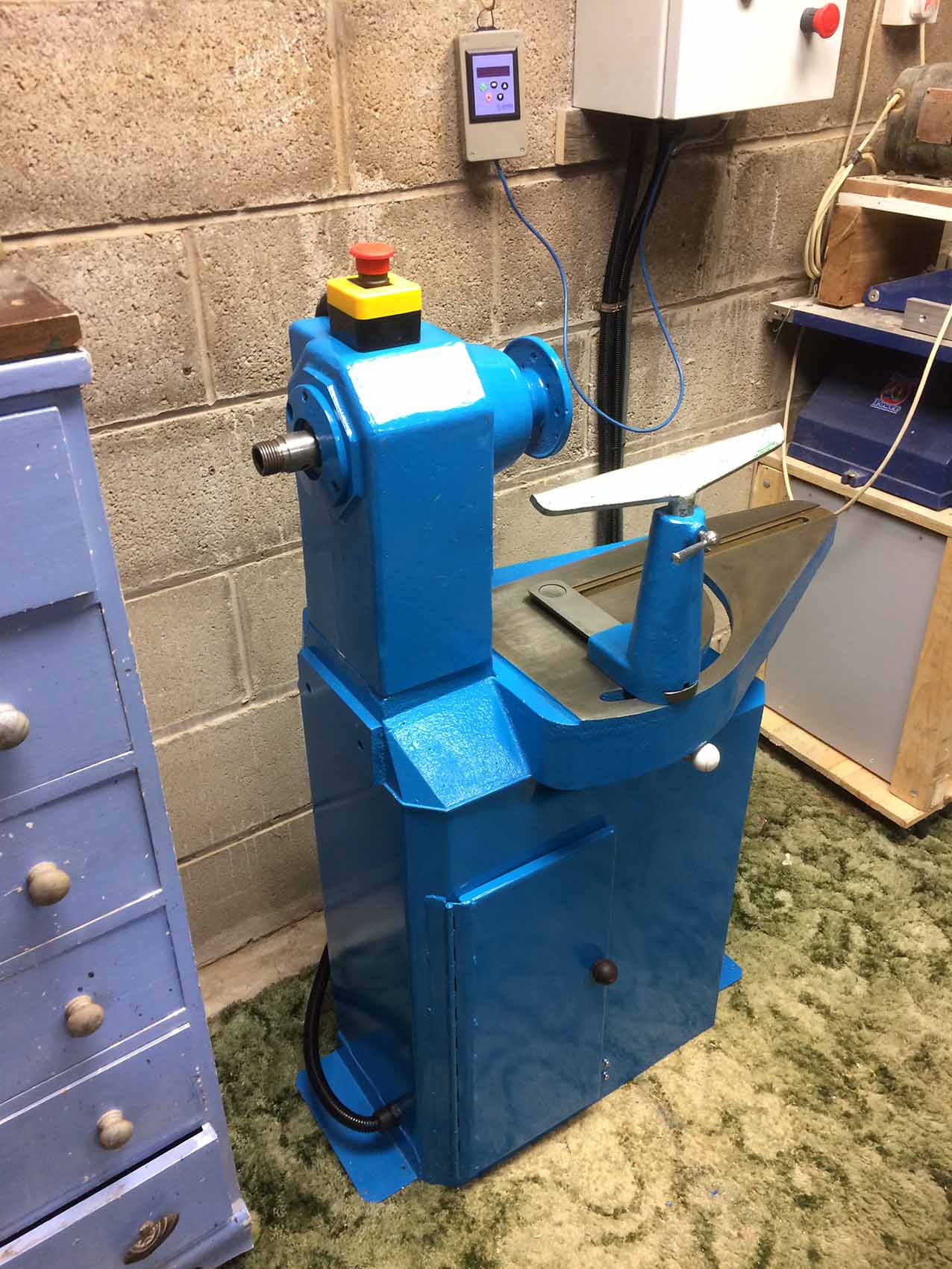

Hi all after trying various size belts I finally found an A51 was good for the upper belt and a A43 for the mid-speed pully to the motor. This gave a good adjustment position for future tension as the belts stretch. The mid pulley is on no adjustment and therefore will be ok as the upper belt beds in.
The new VFD works great. We are using the mid speed range pulley for 775 rpm. This give a speed range of 280 to 900 rpm running from approx 25 to 60 Htz. You can see the remote control in the pics. Two emergency stops using the VFD ramp down set at 2 seconds. One on top of the headstock and one on the electric panal at the RH side. Front door is also on a microswitch so it stops via the VFD also. The left start stop on the panal just pulls in a contractor for VFD power so if there is a power cut during use it will fail safe when power is supplied again needing a power on again.
As I have now fitted a 2hp 3 phase motor it only draws 3.8amp so the motor is not really under load. I have a pet project for it for a 40" bowl at some point so this motor may be more use later.
The 85 year old father in law is looking forward to using it now and I hope he gets much enjoyment from it.
Thanks for all your support and help with the overhaul it has been much appreciated cheers.
