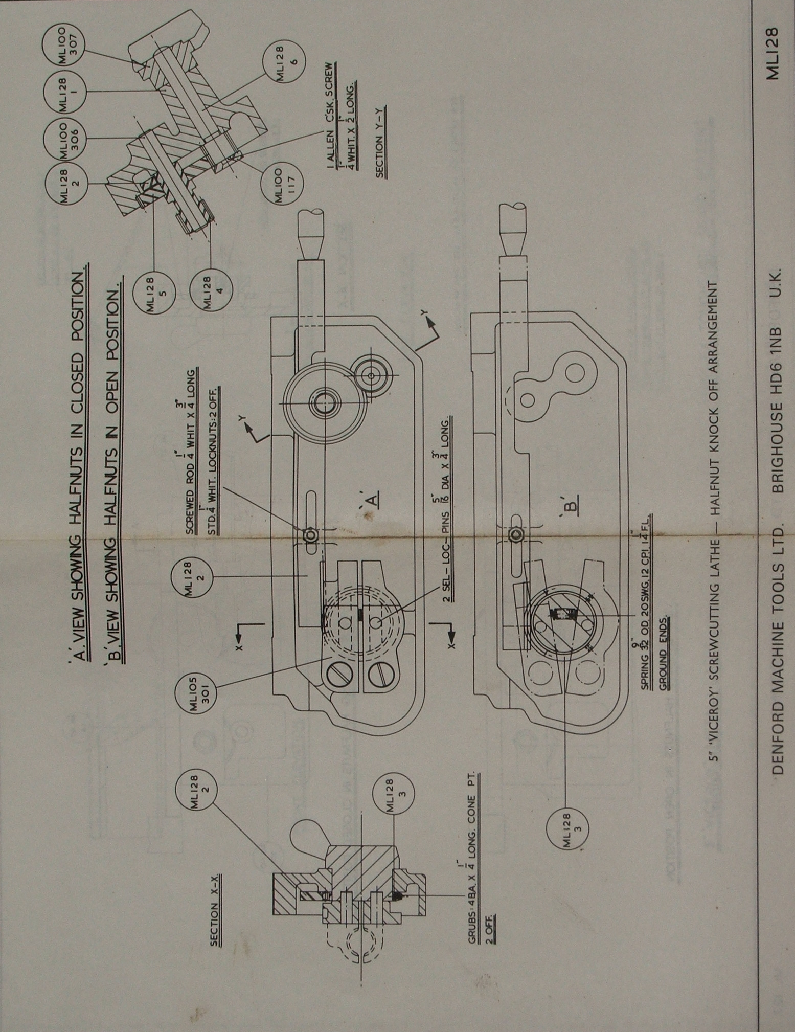

The last one, this has been a interesting project, i hope it is useful to as many people as possible. these may be of interest to everyone with a love of all thing mechanical. I am sorry but please do not ask for a photocopy of these, I do not have the time or facility to do so. I have not tested do download them, but you can right click and save the image, then rotate them. I have not tried printing them from the save imge, the images as I stated on an earlier drawing are from A3 originals, the only way for me to scan them in was by using a camera and cropping the images to fit the criteria of the webpage 1600 pixels wide by 3000 high. This is No 35.

I am sure that future generations of Denford TDS owners will appreciate your efforts.
A very useful reference. Much more information that is usually available for any lathe.
I didn't know that Denford made a chip screen. One of the few Denford accessories I don't have.
