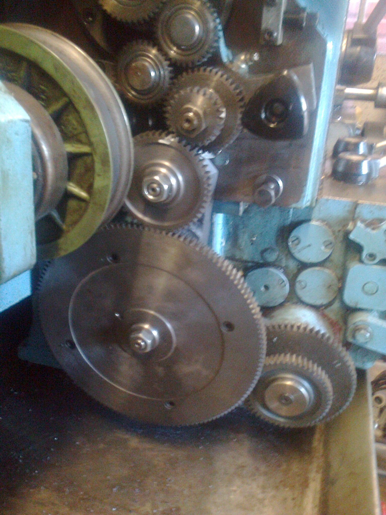

Set up on the lathe.

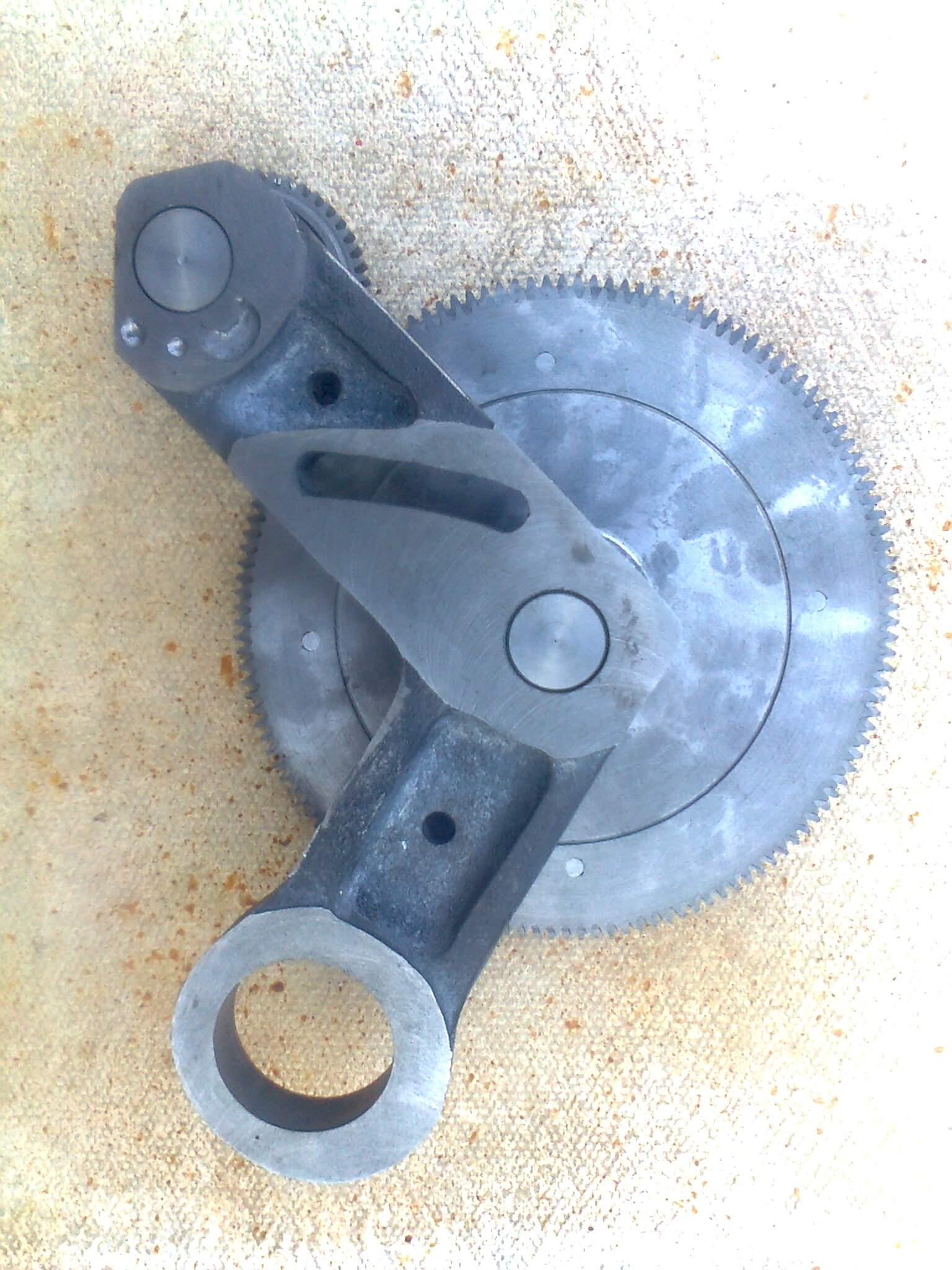

Bracket and 135T/127T gear from the rear

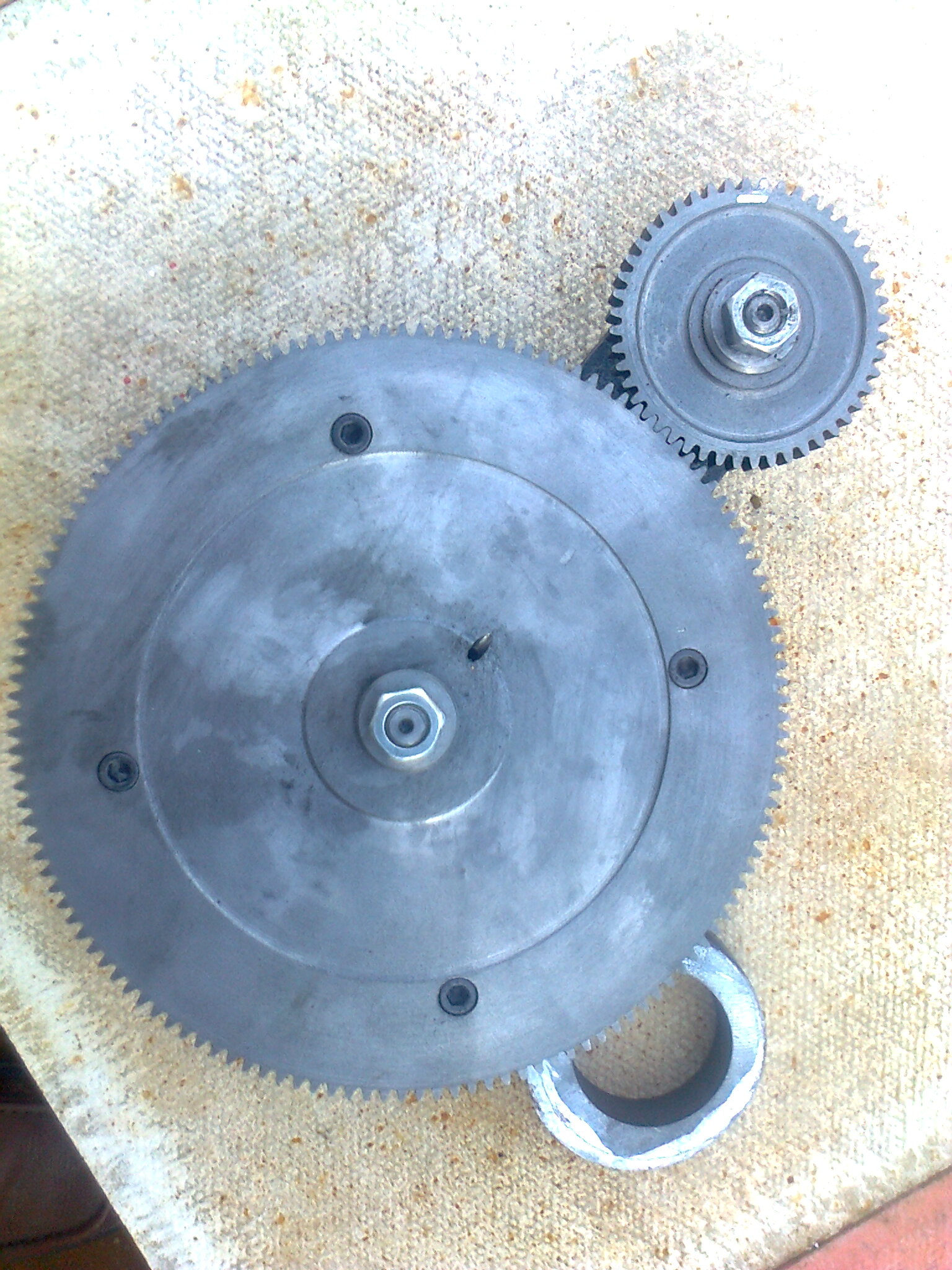

The 135T/127T gear from the front

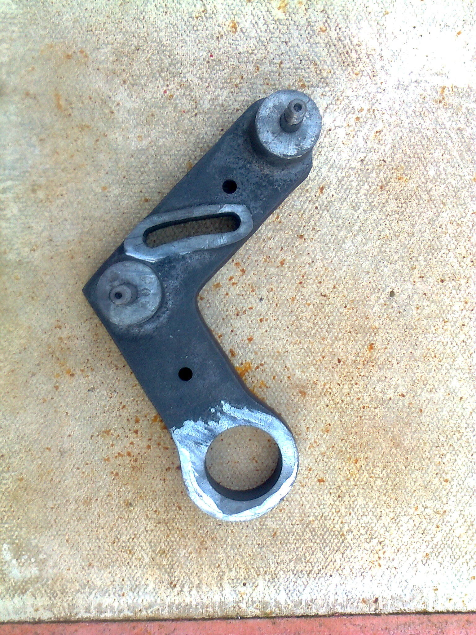

The bracket casting.
