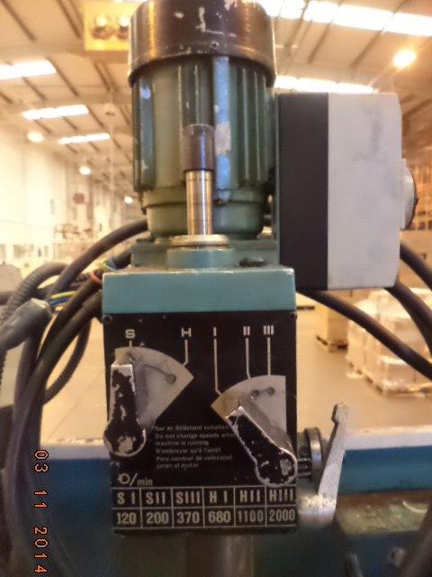

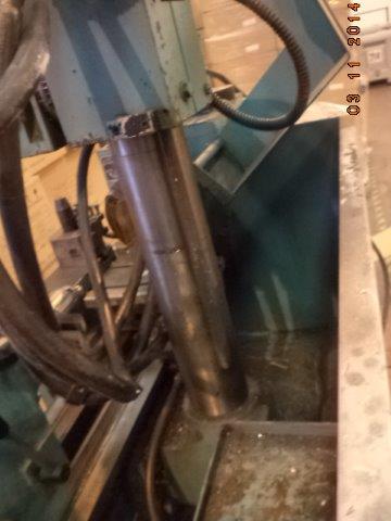

I email the guy for more photos and yes its a milling attachment. Which looks like a separate motor drive to convert if running 230v
I ask about the fault and the reply is "In terms of not working I understand its the electronics card."

That really would be something - since it has no electronics in it.Steve_S wrote: I ask about the fault and the reply is "In terms of not working I understand its the electronics card."

Yes, when I asked him, he said that his electrician had told him it didn't work because the electronic control card was defective. Puzzled me too.Pete. wrote:That really would be something - since it has no electronics in it.Steve_S wrote: I ask about the fault and the reply is "In terms of not working I understand its the electronics card."

I was so intrigued by this one that I went to look at it this morning.Pete. wrote:Never seen a Denford combination machine like this one offered on eBay. Was it standard issue or is th emillin gpart a later addition?
https://r.ebay.com/DMf7Io
It appears to be a standard Viceroy 280 Synchro, apart from the fact that there is a facing on the back of the bed,for mounting the mill. My 280 doesn't have that facing. Its an imperial machine, leadscrew, tailstock barrel and dials, has the 3 jaw shown in the photos, but no other spindle mounted equipment. There are 2 holders for the QCTP, a tailstock drill chuck and 3 spare change gears, plus various oddments of tooling. There is a 2MT Clarkson type collet chuck and 3 imperial collets which fit the mill head.
The vendor says there is an electrical card problem which stops the machine working. The data plate quotes the drawing numbers for the relevant wiring diagrams, so that probably isn't an insurmountable problem. Both lathe and mill head are 3 phase Its got the footbrake.
The vendor has now been told by his technician, who I talked to, that there is a problem with the traverses, and the technician says that the gears and racks in the gearbox are badly worn and chewed up. Thats a pity, because otherwise the machine looked pretty good, if in need of a good clean.
The mill uses a 6.5"x6" table forming part of the cross slide. It isn't what I'd call a 'handy' attachment to use, if it relies on the saddle traverse for movement in one direction. There should be a quick action movement for the quill, but the lever is missing, and I couldn't spot it in the drawers of the machine. Head elevating is by means of a handwheel on a vertical screw, and is best accessed when standing at the rear of the machine, which is why to me it isn't too handy to use. I couldn't see a name on the mill.
Its a lot of machine for not much money at present if someone fancies a 'punt' The mill head would probably sell well in its own right.
