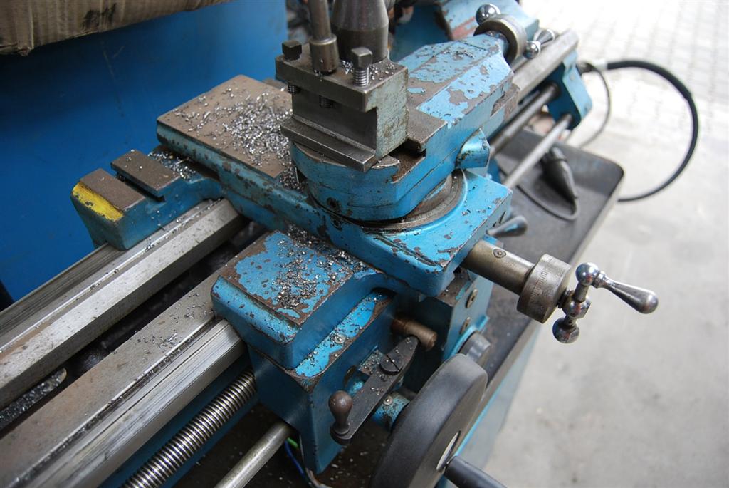

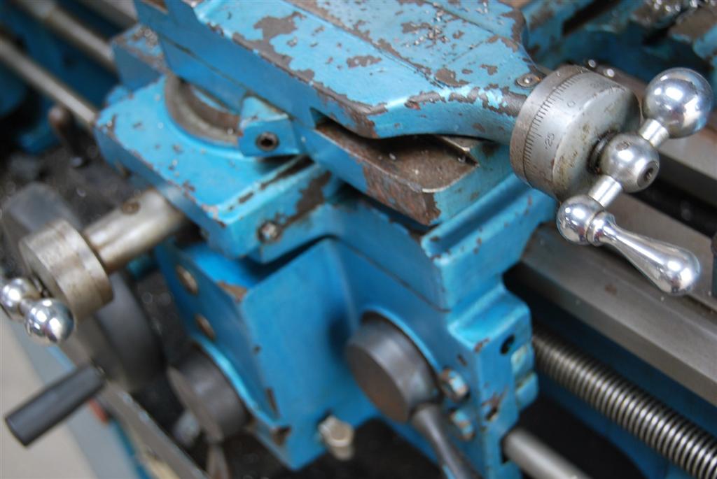

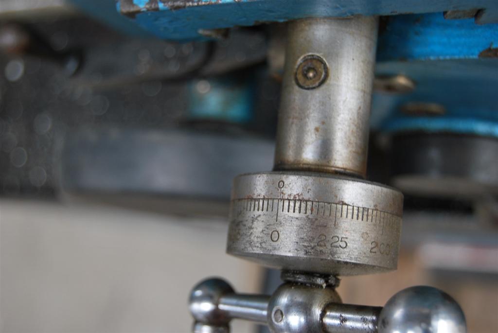

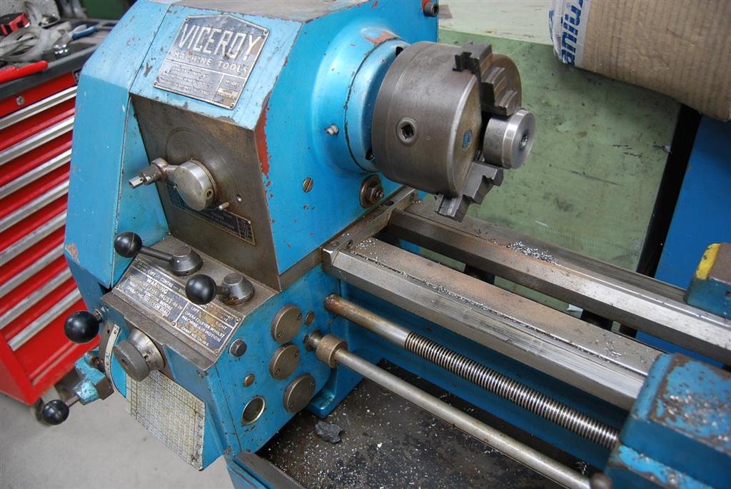

What really worry me is the bed ways condition - do you also see rust on the ways near the spindle? Also dove tails on both cross slide and compound rest doesn't look well:/ As you can see it is metric version but I have a question on cross slide and compound rest lead screws - are they metric or imperial? Dial scales says 2.50mm per revolution - it is pretty close to 10 t.p.i. lead screw (or 20 t.p.i. when talking about work diameter change per rev). So automatically I'm asking what about that missing 0.04mm (diff between 2.54 and 2.50)?

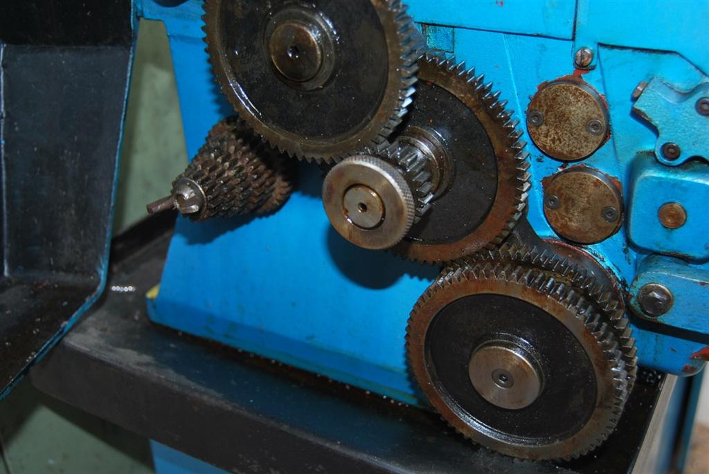

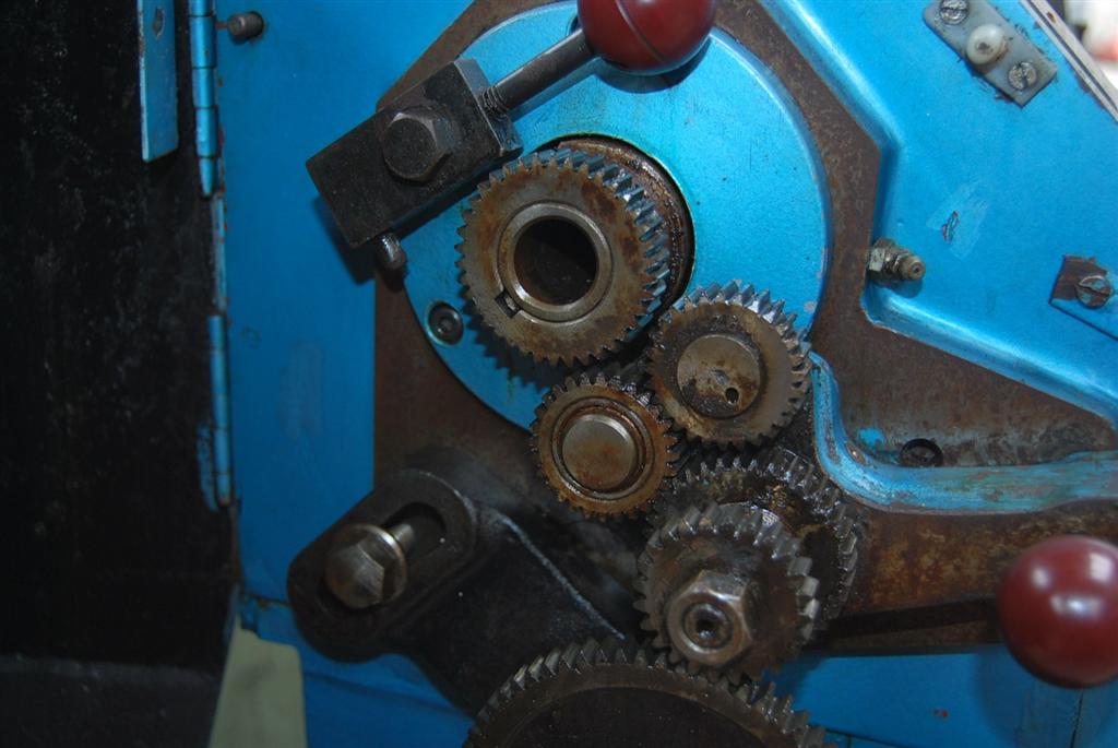

The lathe is sold as is - without additional accessories though I can see 6 change gears under the end drive cover - the 7th one is mounted on the gear train. I'm aware that steady and follow rests are near impossible to get on auctions and too costly because of shipping cost though rests are something I can cope with. But faceplate is very handy and it is not included:/ I've seen somewhere that there is some problem with spindle thread so it might be a problem to make my own faceplate and it is also hard to find accressory for TDS 1/1. The same about conversion set for imperial threads cutting.

2)What really worry me is the bed ways condition - do you also see rust on the ways near the spindle
I'm sure the bedways will be fine. Don't forget the near side Vee is only used for the saddle and the centre one only for the tailstock. How often do you have the tailstock that close to the chuck ?
3) So automatically I'm asking what about that missing 0.04mm (diff between 2.54 and 2.50)?
Don't understand the problem. Its a metric lathe, work in metric and everything is fine.

5)The same about conversion set for imperial threads cutting.
There are conversion change wheels available. Or else you can bodge a "nearly right" screw thread which would be OK for a short thread. i.e I did a 7/16 UNC thread and it worked fine on my metric Viceroy.
There is an Excel spreadsheet in the data stickies somewhere which gives you a help with this.

3) i was wondering what kind of lead screw is used, say for compound rest. I thought it was 10 t.p.i so dial show only some approximation (2,50mm instead of 2,54mm per rev) but that would be stupid:)

5) now i recall i've seen that XLS file already, thx!

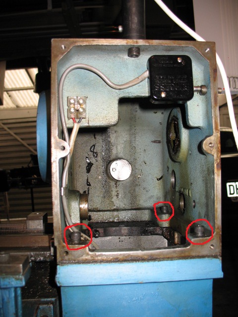

What do you guys think about it? Some pictures from Dazz shows that there are only 4 capscrews ( circled red in pic) that bolting headstock assembly to the lower part (bed?). Is this possible? How about alignment? Any setpins?
I've borrowed this pic from Dazz for illustration purpouses.
