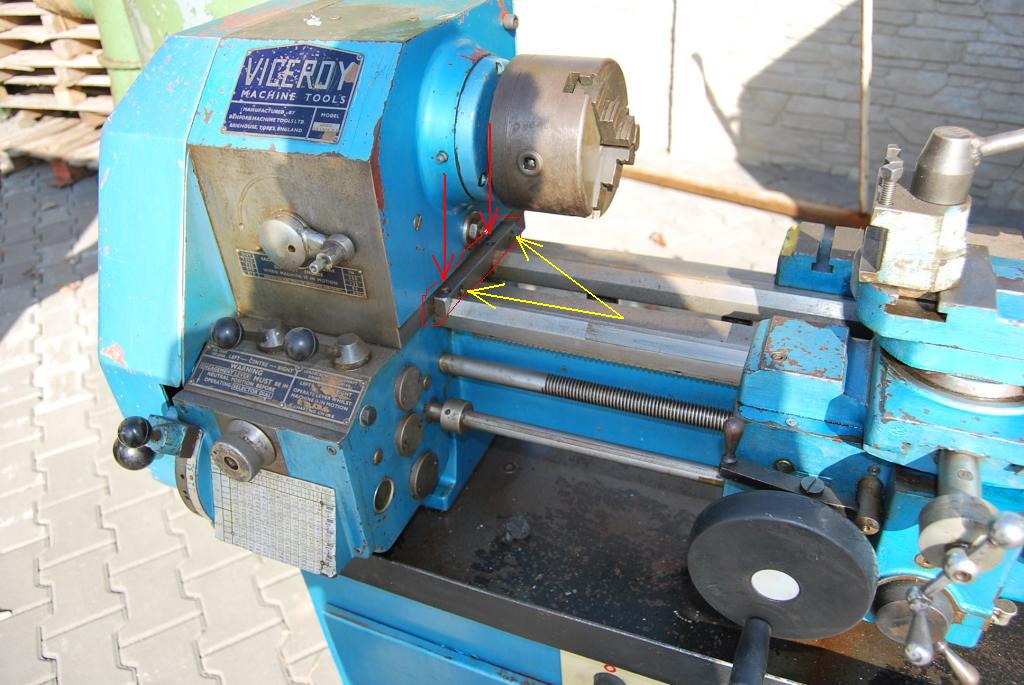

I bought TDS 1/1GBL last weekend and it seems that it has a slight headstock/bed misalignment... I turned test steel round bar and there is 0.03mm difference in diameter over about 5cm bar lenght (i used short stock bar not supported with tailstock)... So there is a headstock re-alignment need in front of me:(
I got some ideas about it: if you look at the picture below you can see that there is rectangular bar screw on to the bed and headstock by 4 capscrews. Two vertical screws (shown by red arrows) and V prisms of the bed secure this bar against movement. The 2 horizontal screws (yellow arrows) goes into the headstock. So if you loosen 4 capscrews located inside of the headstock (the screws that hold the headstock down to the bed marked red here: viewtopic.php?f=50&t=3808&p=14529&hilit ... ent#p14529 in Thu 19 Jul post ) you can align headstock by inserting shims between that rectangular bar and headstock. Then thightening all screws and making test cut, measuring and... re-alignment again until you get a perfect alignment. What you guys think about this? Does that make any sense?

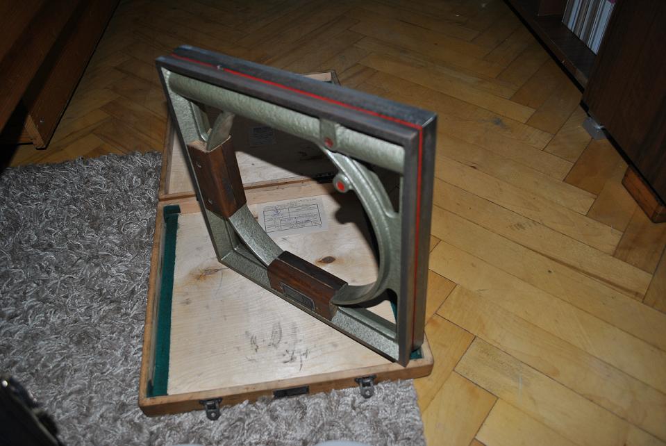

Thank you Dazz for your ideal. You're right. I'll not detach headstock from lathe bed. Instead i'll try to figure out if my bed is twisted. Unfortunatelly i can't use your laser method. I purchased a precission machine level (i hope it is a proper name) of class 0,02/1000mm. It means that level will indicate 0,02mm difference in level over the distance of 1 meter. I think that should be enough to check bed twist. I'll put the level on the cross slide and move carriage from head stock to tail stock and check if there are any differences in measurement. Does this approach ok?
