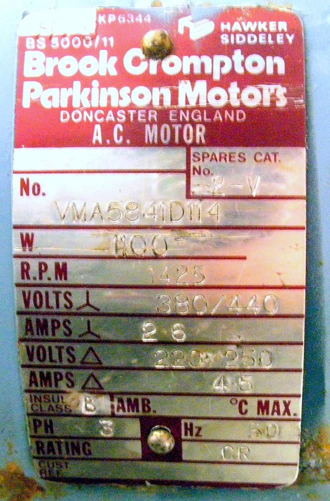

I'd try flushing the bearings out with oil or fresh grease. Even if you remove the spindle you might be hard-pressed to get all of the grease bits out. getting the spindle up to temp and pumping grease in would be just as good IMO.
Attached is the motor plate from my (slightly later) Viceroy.
- motorplate.jpg (168.25 KiB) Viewed 8859 times

Thanks Pete.
As well as that rating plate, I've also had a reply from a third party selling a Viceroy of the same vintage as mine on eBay with these motor details:

I've not been able to conjure up the frame mounting or shaft details from either of those [part numbers unfortunately.
Will carry on looking - one concern with the current 1ph motor is that it's clearly not lined up right (stepped pulleys don't match exactly - they are one step out), I won't be able to tell until I pull it out if that's due to the shaft length, the mounting points, or even a bit of both.... It'll have to come out at some point as the electrics are truly shocking (although thankfully not in all senses of the word!)
