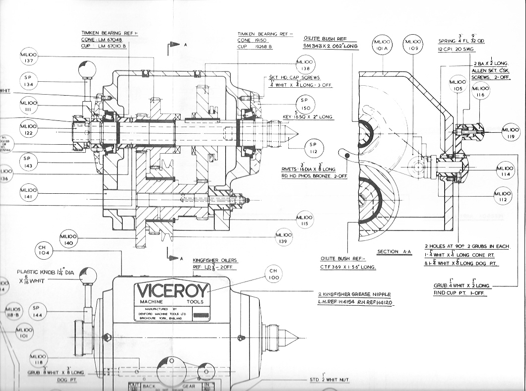

Trawling through this site I have found a drawing for a Gear Shifter Fork (ML100/109A) which looks similar to the one installed on my lathe. On both fingers of this selector there is a 3/16 dia. hole but no indication as to whether something should be fitted to the holes.

Hi I found a drawing which might help.

- Part of Drawing ML100/100B

Hi Les,
Thanks for the drawing.
It seems to confirm that the two phos. bronze rivets in my lathe are not doing what they are meant to.
I will have a go at removing the gear shift lever gaining access from the rear panel next weekend.
If this fails I think it will be a head stock removal job.
Bob
Bob

A Viceroy re-build article provided by the 'CNC Apprentice' has been a great insight and help in sorting this problem out. Many thanks to CNC for that.
The two phos. bronze rivets (see CNC's photo) on the back gear shifter fork (ML100/109A) were found to have worn allowing the inside of the fork to strike against the back gear.
Replacing the rivets and dressing them with a file to ensure that there was an equal gap on both sides of the fork arms has enabled the fork arms to maintain a centralised position about the back gear. This has now brought the noise level down to an acceptable level.
Bob
Bob

HiLesT wrote:Hi I found a drawing which might help.
Regards,
Les.T.
Do you have a detailed drawing of part ML100 141, the counter shaft? I specifically want to know if the shaft is machined eccentric to adjust the gear spacing.
Dazz
Dazz

Hi,dazz wrote:HiLesT wrote:Hi I found a drawing which might help.
Regards,
Les.T.
Sorry all I have are some assembly drawings. No drawings of individual parts. I don't think the shaft would be machined eccentrically, (at least not on purpose !), If your headstock is a bit noisy try using thicker oil on the gears (top) oilers.
