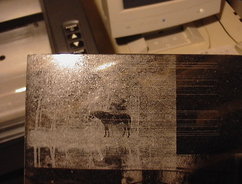

i got ugly horizontals lines all over my picture, and also outside of the picture area.
do you know the problem?

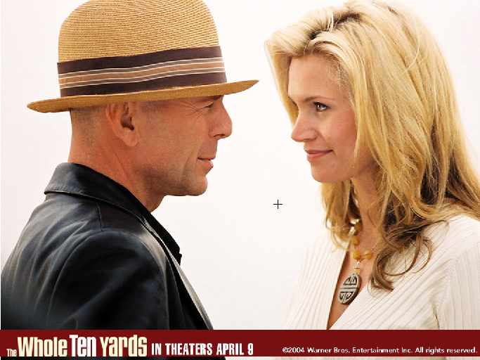

As an example:
Original colour image:

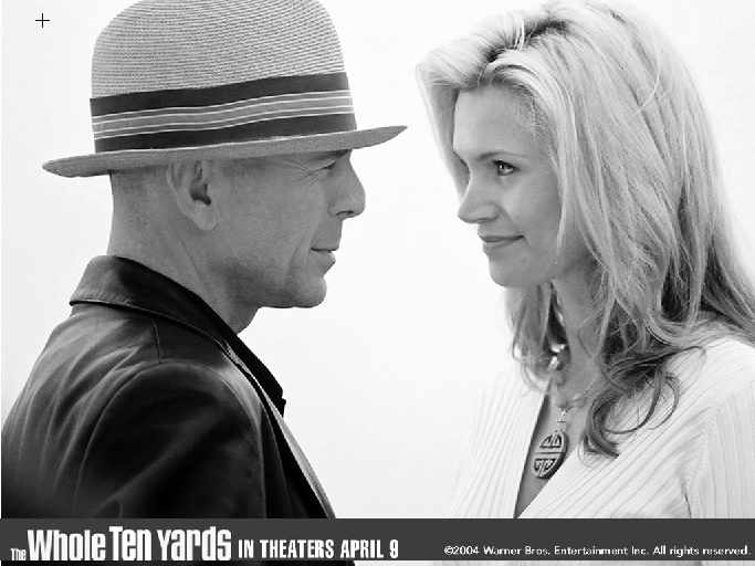

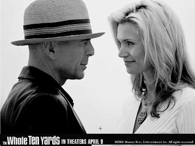

Then convert to Black and White (IMAGE, MODE, GRAYSCALE)
Adjust the Brightness and Contrast (Image Adjustments Brightness and Contrast)

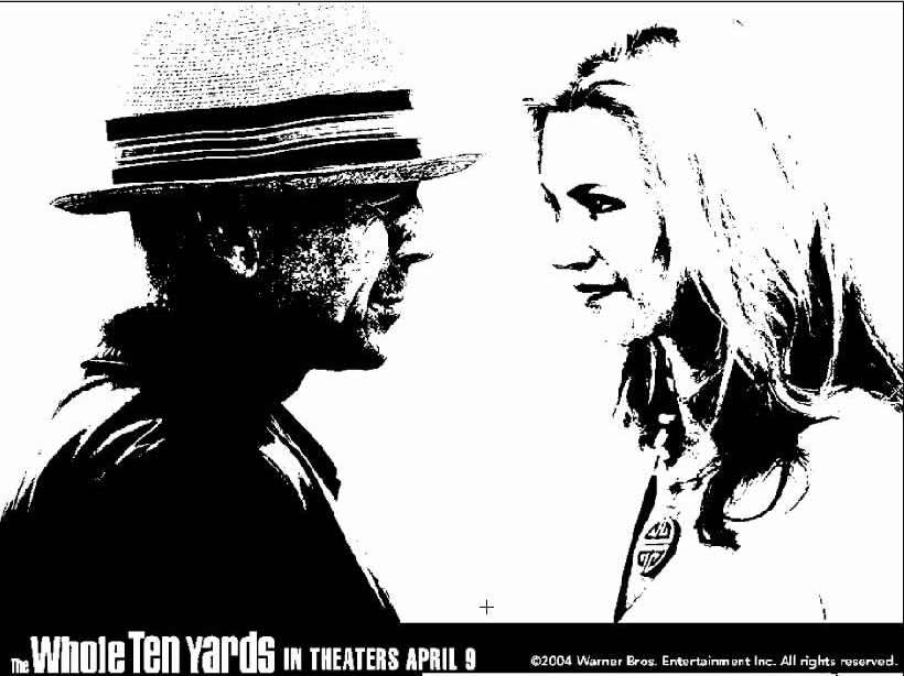

Then convert to Bitmap (Image Mode Bitmap) Set to 50% Threshhold.
This results in an image that is Black and White so the laser is on at full power where the picture is Black and off where white.
I got ugly horizontals lines all over my picture, and also outside of the picture area.

Can you post a picture attachment of the results - I don't understand what you mean by horizontal lines outside the picture ?
If you are laser engraving a photo, then you normally need to clean up the picture first and alter the contrast.
You will always get "artefacts" when using lower quality compressed JPG images, which may be more visible when lasered.
HERE IS THE picture attachment of the results
- 2.JPG (97.8 KiB) Viewed 25416 times
It seems like the laser is not switching off fully - looks like the laser tube is losing control over the output power.
Looking at the image, I would still try to create a black and white high contrast image to work on - all that fine grey detail will be asking a lot of the laser.
Nextly, I would try some different material settings on the same actual material - go for something very soft, which will use lower power settings, then try something harder (which should run the machine slower) and compare the results. Also try another (physically different) material with the correct settings and see what happens.
Other than that, I believe there are some tickle adjustments which may help - Martin will be able to advise on that.
If none of these help, then it could be your laser tube or control board has a fault

I contact versa laser and the are sending me CPU and HUB-USB I am going to try that we try to play whit the switch on the laser tube but its not working so we are going to try this part first I will send you my result the machine is new under warranty
