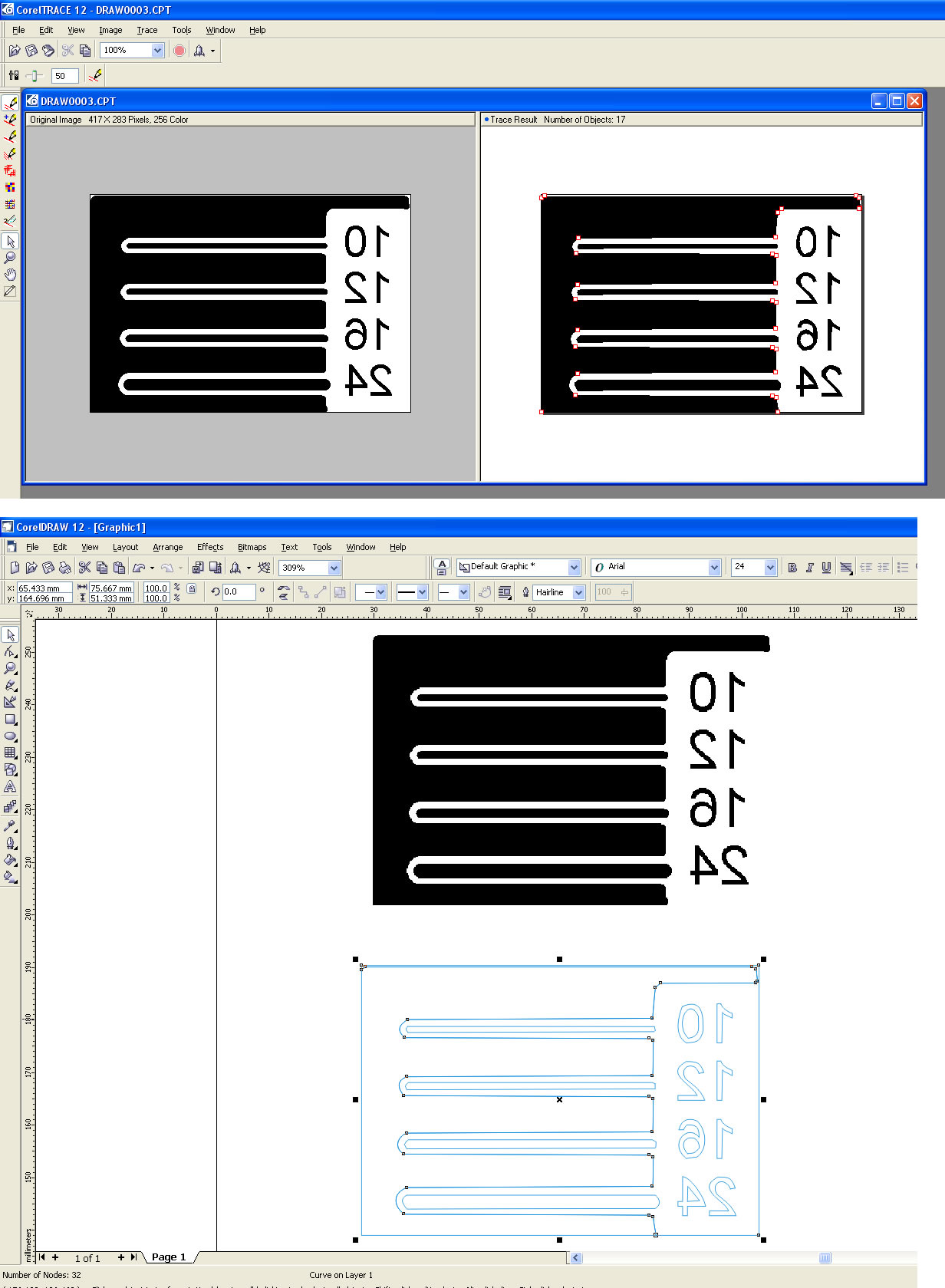

To get a good result i need to go to corel and use trace-> technical drawing. Still it is not what i want. If i print the png from eagle cad, it does not matter how thin i make the black lines, they still are printed as thick lines. How can i influence the thickness of the lines?

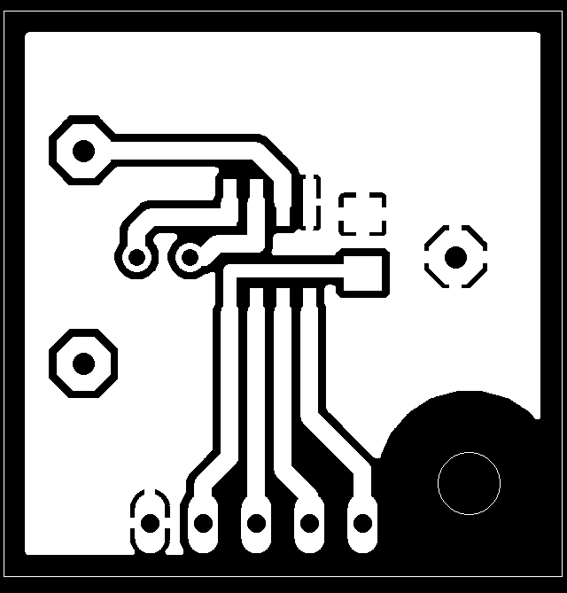

I do not use EagleCAD for printing the image. I export it as a PNG, than put it in Corel Draw and after that i print it. I do not get any feedback if i change the line thickness, it doesn't matter how thick the gap between the lines is, the laser always prints the same distance. If i import the picture to corel photo and use a 1-bti conversion and there i use one of the methods would i get a better result?
What other method should i use for paint removal from metal. In fact this is what i am doing. Frying the paint and then cleaning it with a toothbrush, so i get the bare coper and i can etch the circuit.
In the picture you can see a test that i made. I draw some lines, 10, 12, 16, 24mil. Then i used the method from above and printed the lines. 24mil looks like 12mil. The gap between lines and the big black part are to big in the test compared to exported picture.
- How it should have looked.

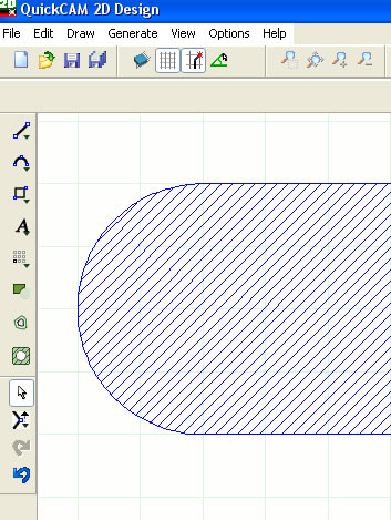

I'm sure vector cutting (red) or vector marking (blue) will be better than rastering as the beam will only go around the shapes once.If i change the color to red and i am vectoring it, would it be better?
When rastering, the beam is going backwards and forwards over pretty much the same area - which may be causing more paint to be blasted away (like you are seeing)
PS You can still vector-cut areas or shapes by filling them with a vector hatch pattern, eg:
- vector-filled-shape.jpg (70.08 KiB) Viewed 21131 times

Just use Coreldraw and Coreltrace like this.
You have to make sure the colour is 100% red (ie, 255 Red;0 Green;0 Blue) or 100% blue for the standard VLS driver to reconise whether you are vector marking or vector cutting. This may not apply to your machine or driver combination - all it did on certain drivers was to adjust power and speed of the laser to allow for vector cutting (red) or vector marking (blue) or raster engraving (black or grey)
I just removed the fill from the resulting trace in coreldraw, and set the line color to blue, and it's line thickness to 0You have to make sure the colour is 100% red (ie, 255 Red;0 Green;0 Blue) or 100% blue for the standard VLS driver to reconise whether you are vector marking or vector cutting. This may not apply to your machine or driver combination - all it did on certain drivers was to adjust power and speed of the laser to allow for vector cutting (red) or vector marking (blue) or raster engraving (black or grey)
