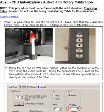

Versalaser CPU Initialization auto Z and rotary calibration
Download the Versalaser CPU Initialization auto Z and rotary calibration pdf from here:
https://www.denfordata.com/pdfs/versalas ... ration.pdf
** Please note that this information is provided as is, and we take no responsibility for events arising from its use or mis-use **
Re: Versalaser CPU Initialization auto Z and rotary calibrat
Hi Just reading how to reset and am a little confused at Step 4 on the pdf. It says if you have purchased proceed to step 6. Which wants you to set the 1.5 lens up. Surely this should read If you have not purchased other lens kits, skip to step 6
Or do I have it wrong?
