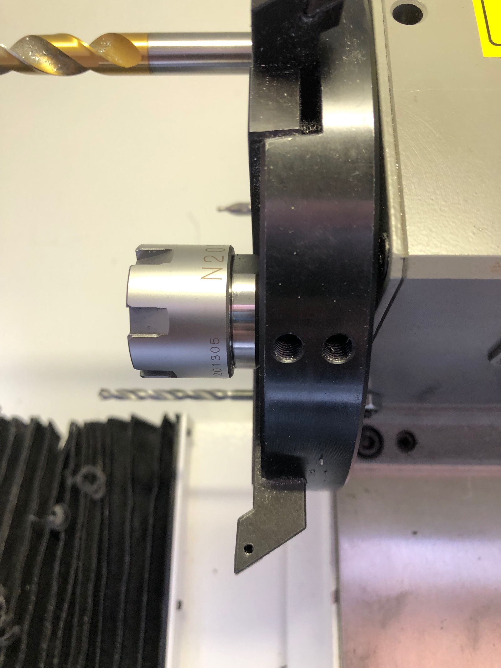

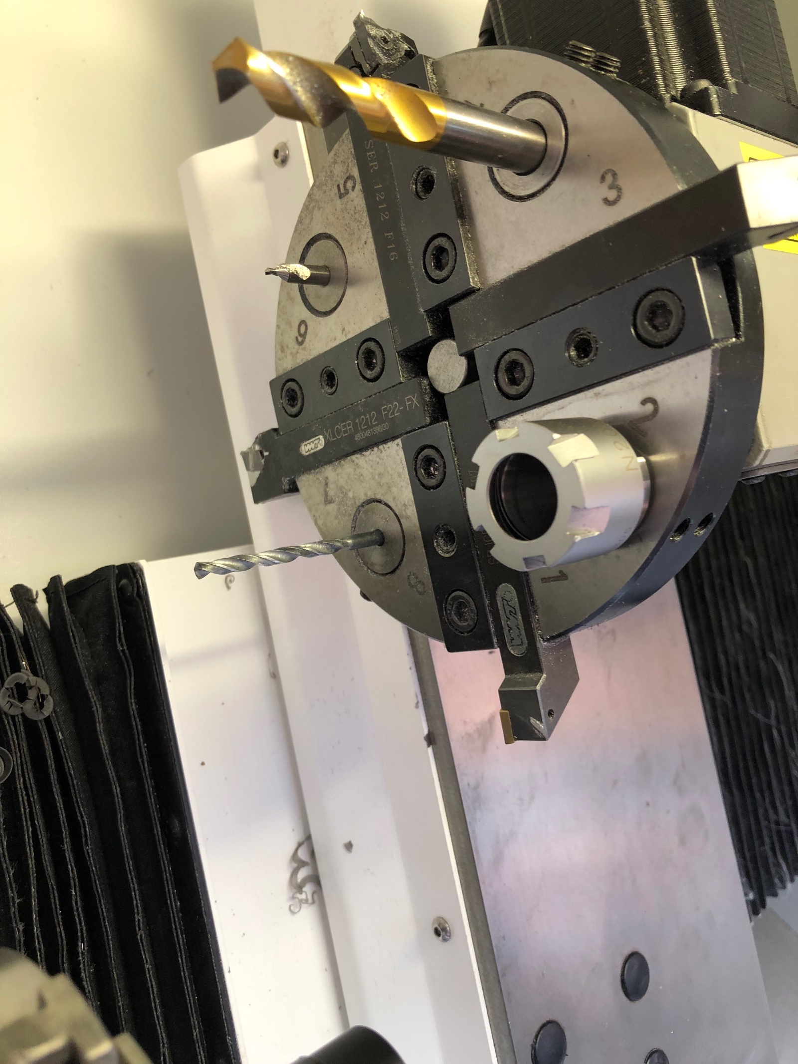

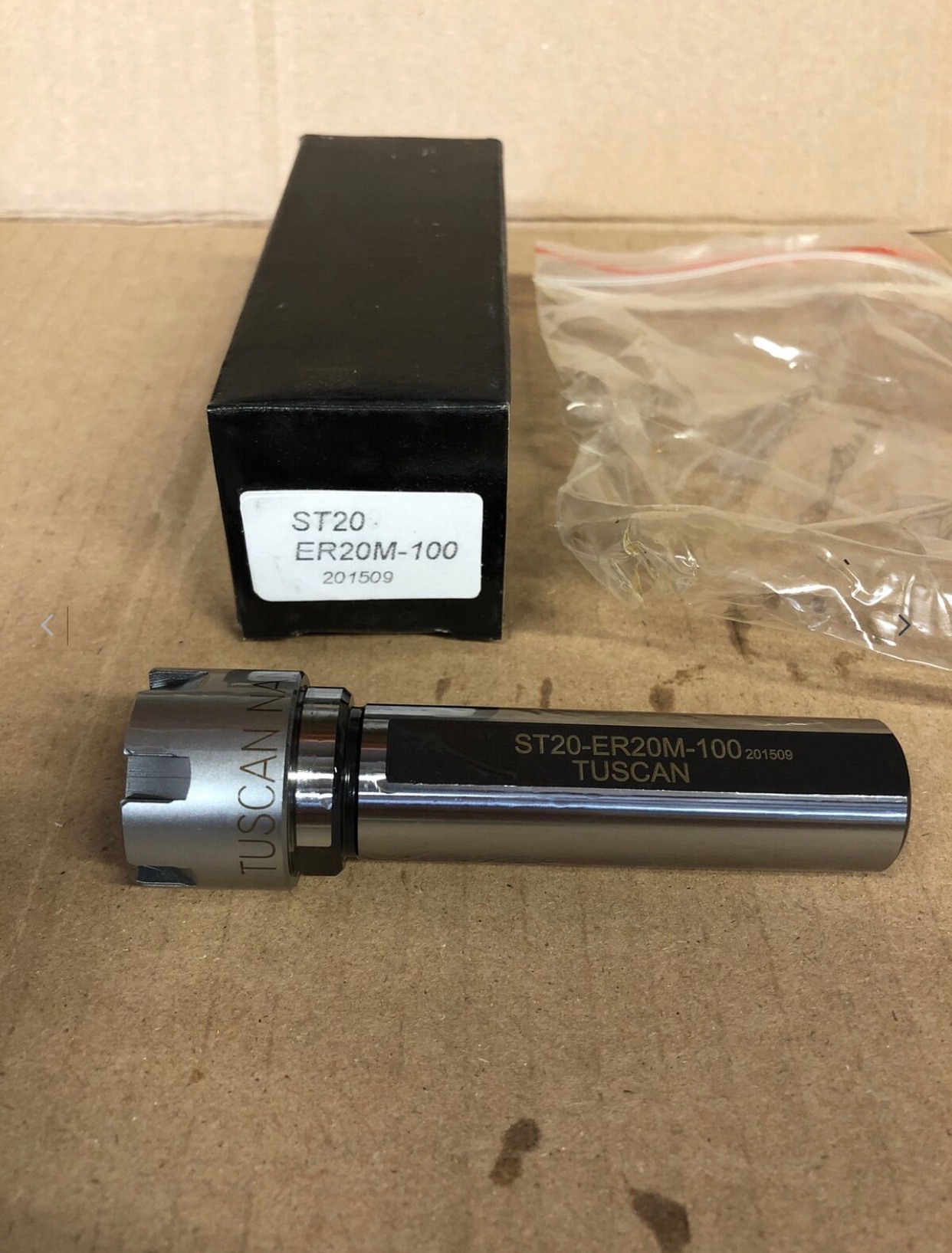

-Has anyone fitted ER Collet chucks and Carbide micro/mini boring tools? I don’t really like the drill holding setup so I’ve bought some 20mm shank er20m collet chucks to turn/grind down to 19mm and shorten (19mm seems a very strange size to make the internal tool pockets on the turret). I’d like to get some smaller bores machined so I was looking at making up some carbide boring tool holders to fit the turret.

I can't help with the Turn 270 questions but regarding the internal tooling pockets they sound the same as on my Orac toolchanger and I believe 3/4" ID as that's 19.05mm. 3/4" round bar is a spot on fit although I haven't used them so far.

1 down 3 to go.

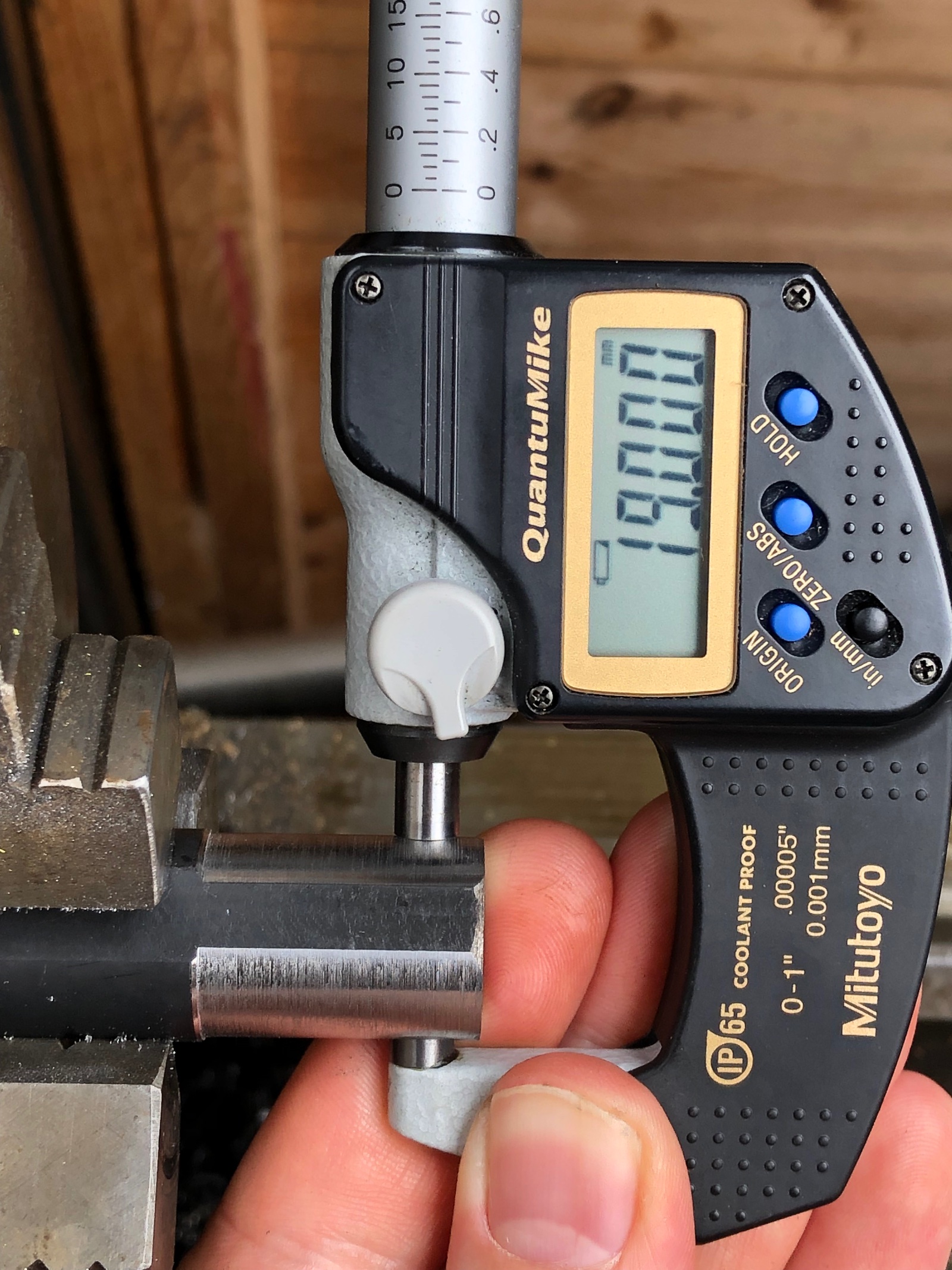

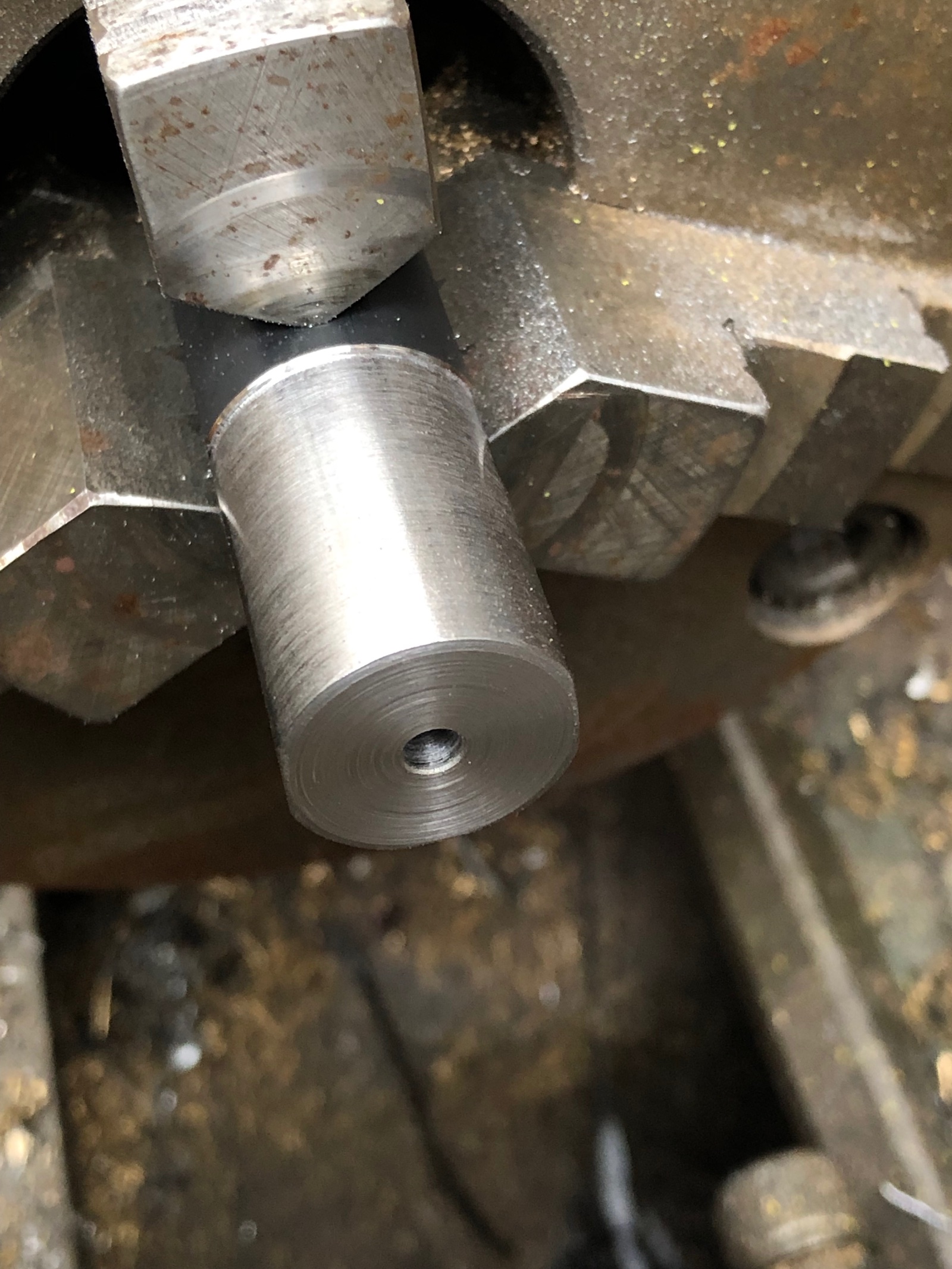

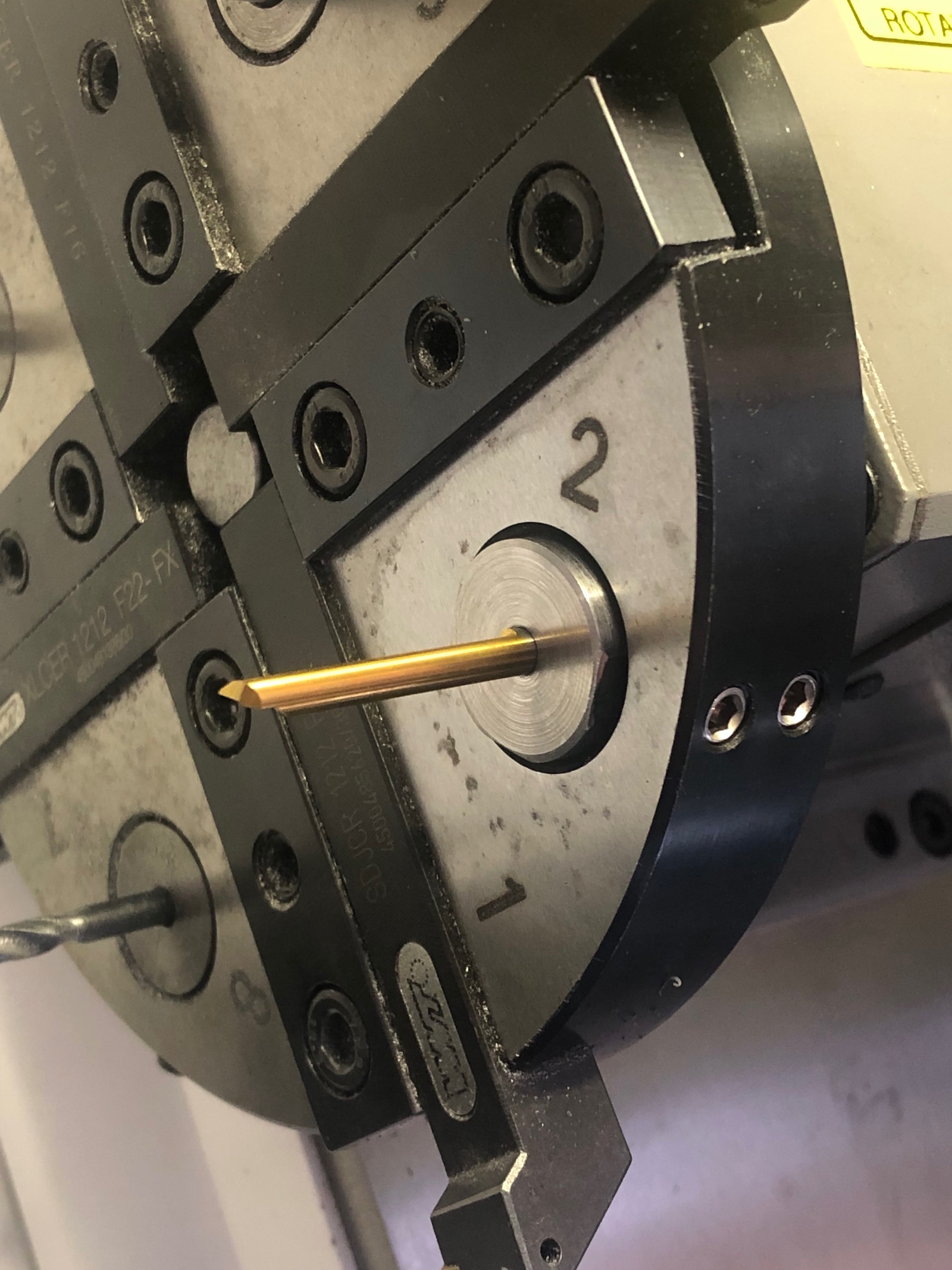

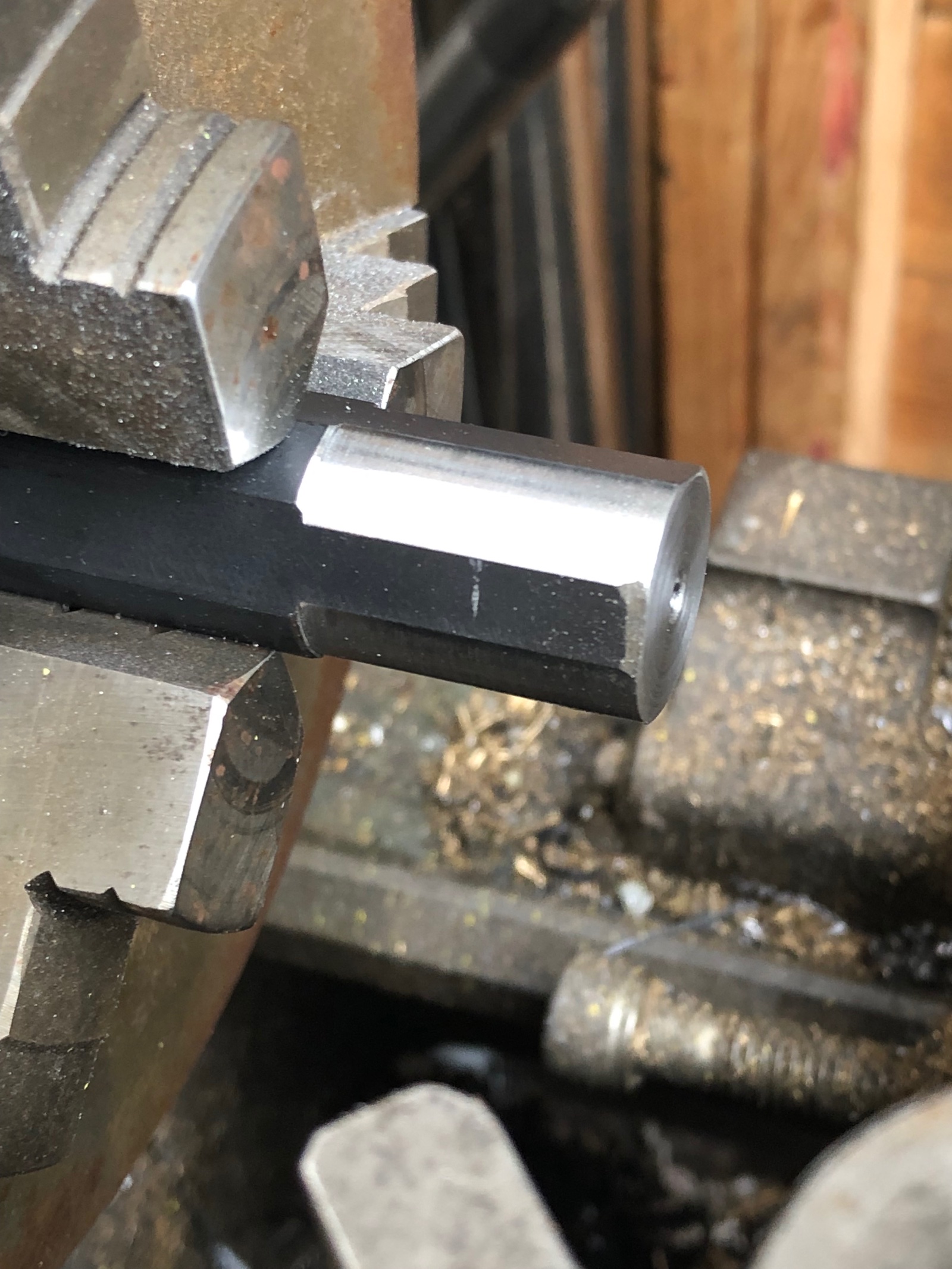

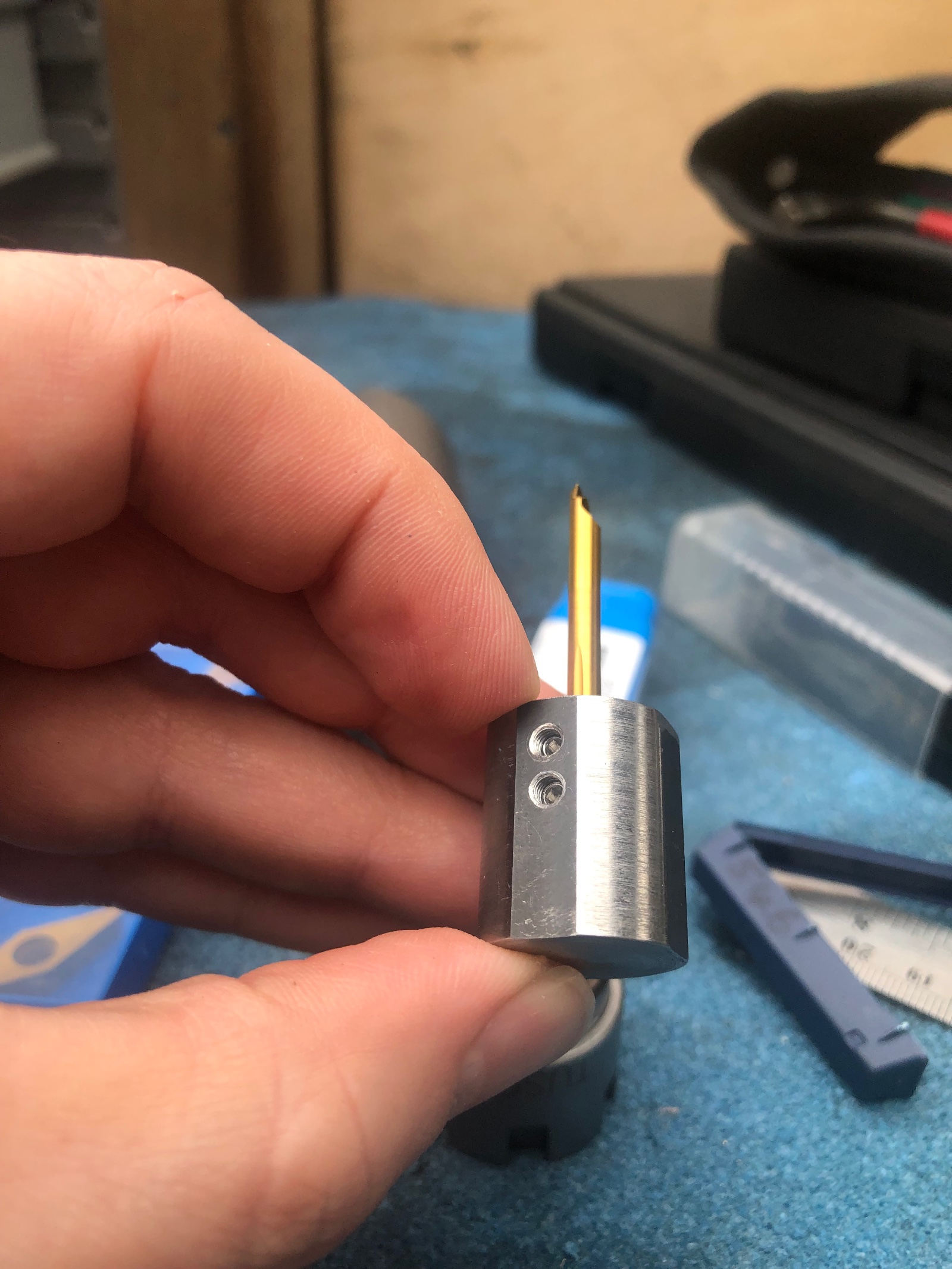

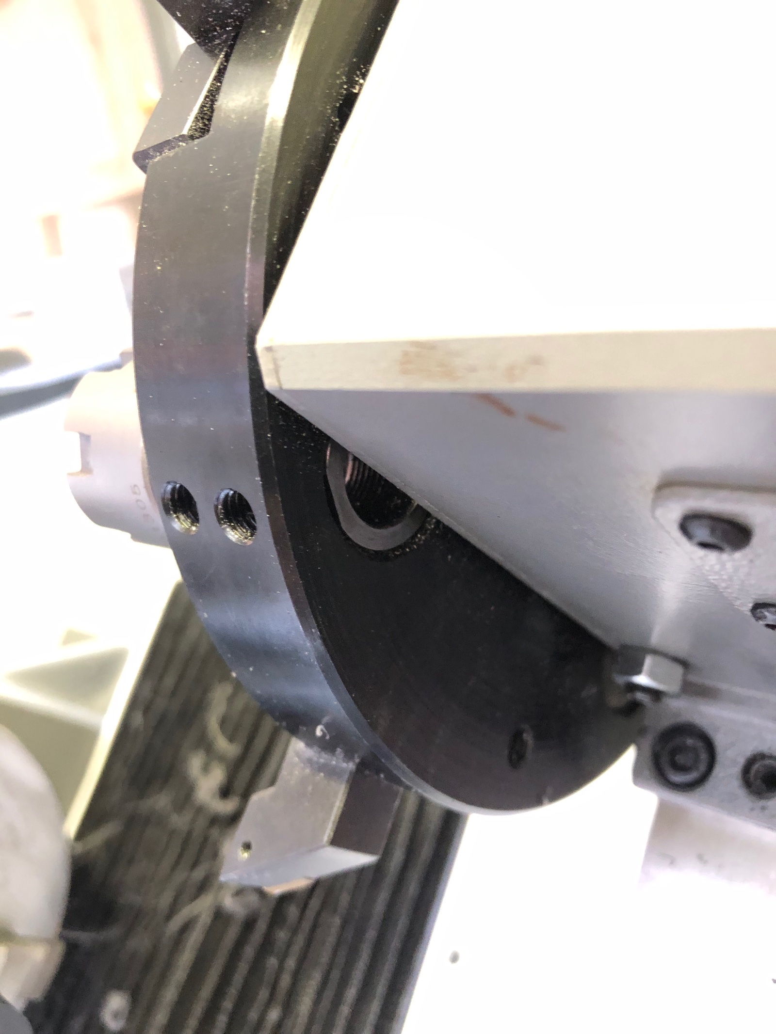

Managed to get a micro boring bar holder made up, I might have gone a tad overboard taking it to 19mm 🤣. Made from an old offcut of 20mm boring bar. Hopefully I’ll be able to get a few test pieces made up over the next week off work…

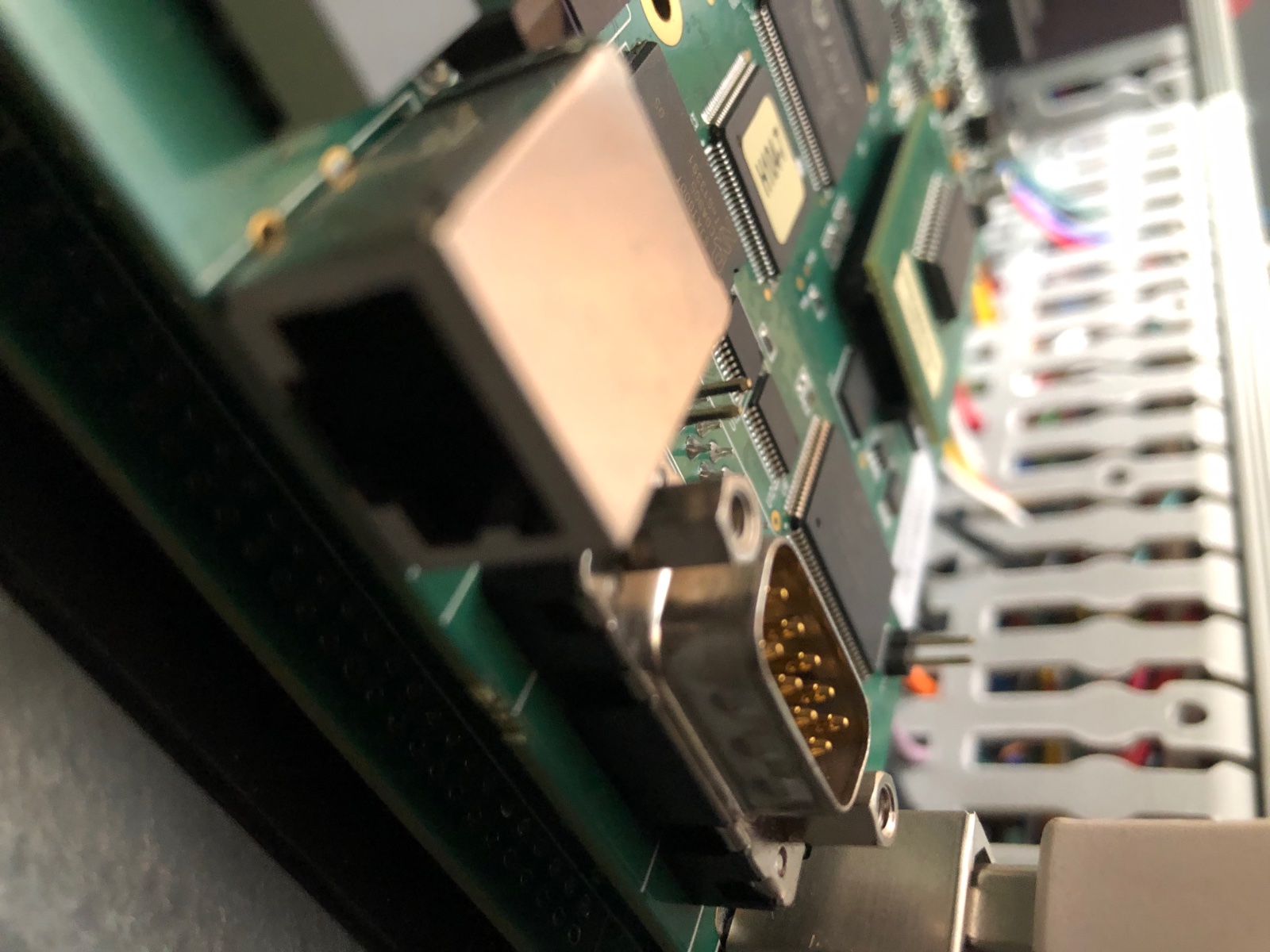

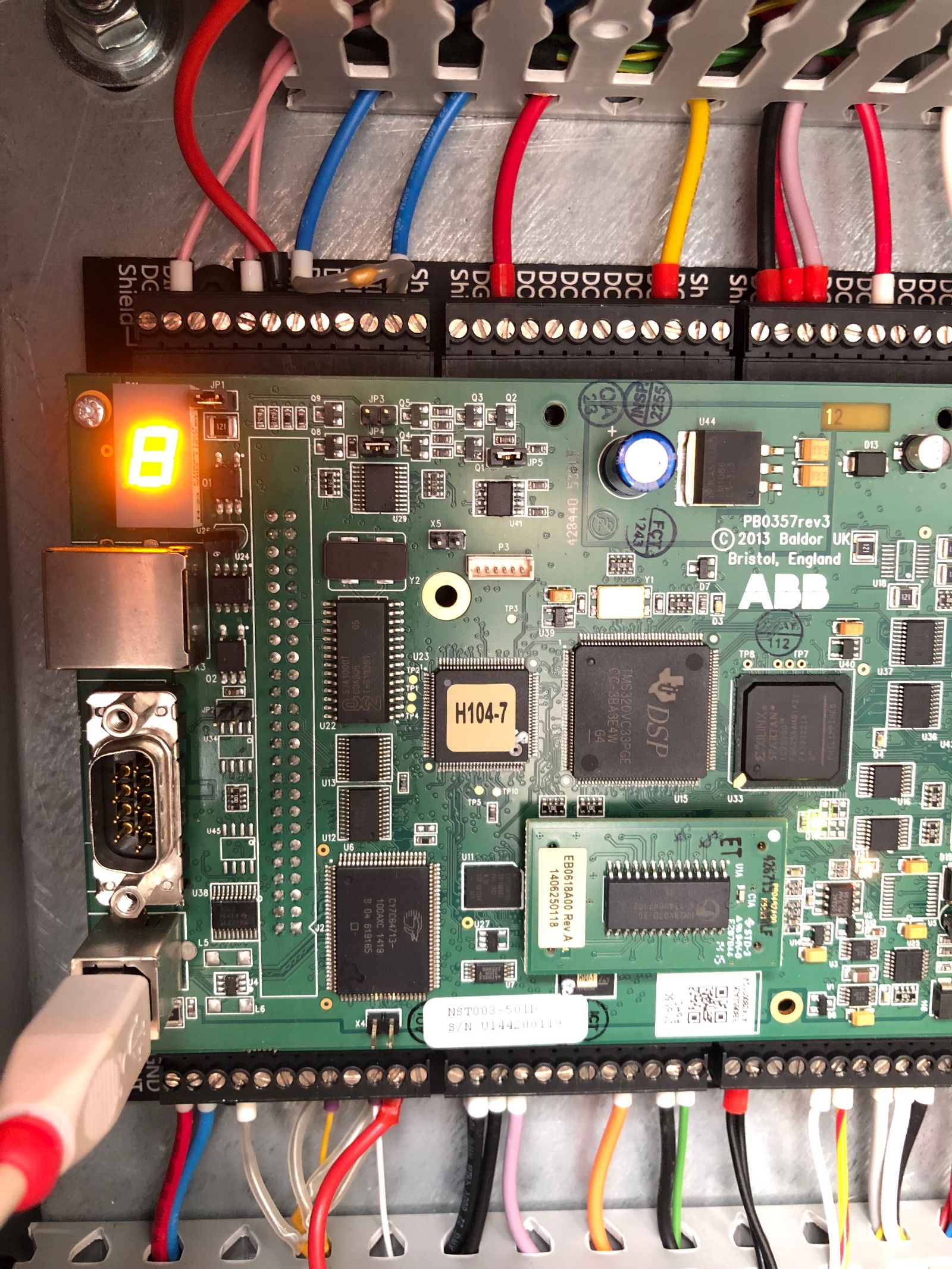

I was thinking back to the connection process and remembered seeing there were 3 ports on the control board. One USB-B which is connected to the bulkhead pass through to run the machine, a serial port and an Ethernet (RJ45). Can the machine been connected via the other ports (more specifically the Ethernet port)?

No we have never used the ethernet port.
USB & Serial but USB is faster.
