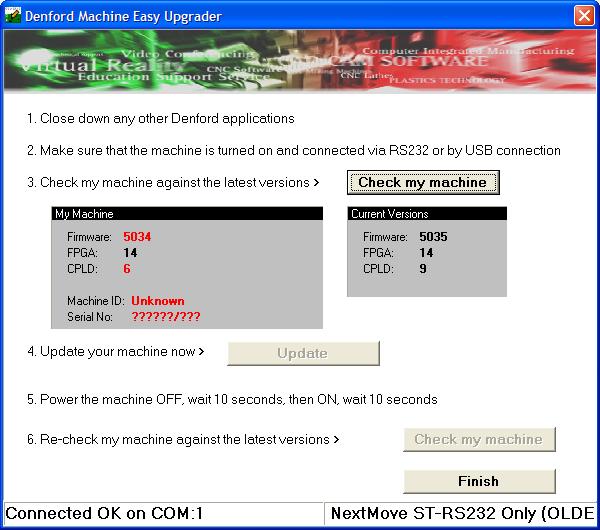

We are trying to update the NextStep control card (RS-232 only) with Easy Upgrader.
What do we need to do to update the CPLD and the bootloader?
Attached are screen shots of the current settings in Easy Upgrader and the warnings that pop-up.
Can we upgrade to VR Milling v5.24? Or should we stay with v2.31?
Thanks for the help.

Post by Denford Admin » Fri 17 Oct , 2008 8:55 am
Unfortunately you will have to organise an exchange board from the UK.
Maybe the full USB top board and V5 milling upgrade is the easiest solution in this case ?
