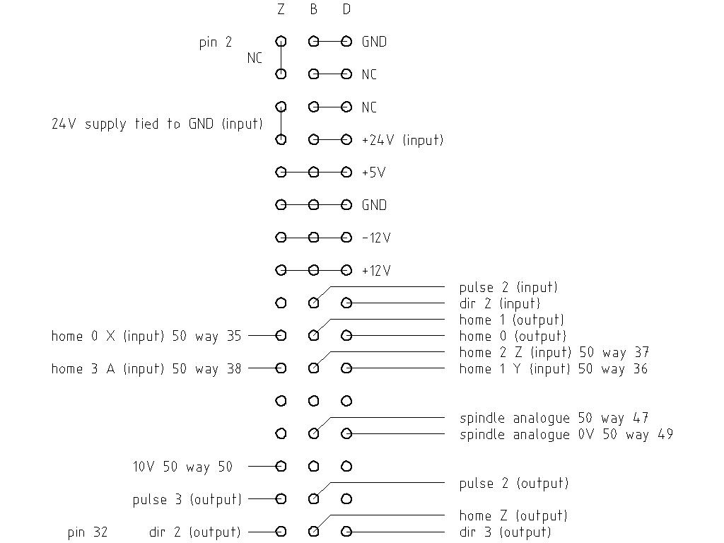

I am planning to do a similar conversion using a CNC4PC C11G BOB likely mounted to the box where the current DB25 is and trying to utilise the existing stepper drivers and hardware on my June 1995 Triac PC. I intend to also make plug in replacement boards to get the signals from the BOB to the backplane and provide any level shifting/conversion/isolation. I'll be trying to use the NAMUR proximity sensors used on the original and have traced the simple circuit on the custom card used to convert the current level to suit the Baldor card requirements which will match the C11G by the look of it. I have seen similar circuits on the web. As mentioned earlier the Baldor card details are available on the BB as are the wiring diagrams for the various Triac models and between them a lot can be figured out. I have traced what I require and attached a drawing of the custom card wiring connections I traced. The custom card seems to have been intended to be supplied with AC to provide the various power supply voltages required but in my Triac it is supplied with 24V DC from which all the power supply voltages seem to be derived. In the drawing pins 2z and 4z are connected but I listed them as NC but they seem to connected to one of the main custom card electrolytics so likely a power supply voltage but it only seemed to be connected to the RS card option for the 4th axis so I didn't think I needed it. The Baldor card only supports 3 axes so for 4th axis support the custom card takes in pulse 2 and dir 2 (Z axis) and I presume saves the Z and A axis states and multiplexes between the two to provide support for the 4th axis, not required with the C11G but the output wiring to the backplane slots is required if making interface boards. I have the electronic parts but haven't done the full circuit or board layout yet. Next step is to get the Triac mounted on a stand but have been getting side tracked and so haven't built it yet. Things should progress faster when I have a machine requiring just electronics and software to play with. BTW I was intending to use LinuxCNC for the control as I've been using Linux for years now.
