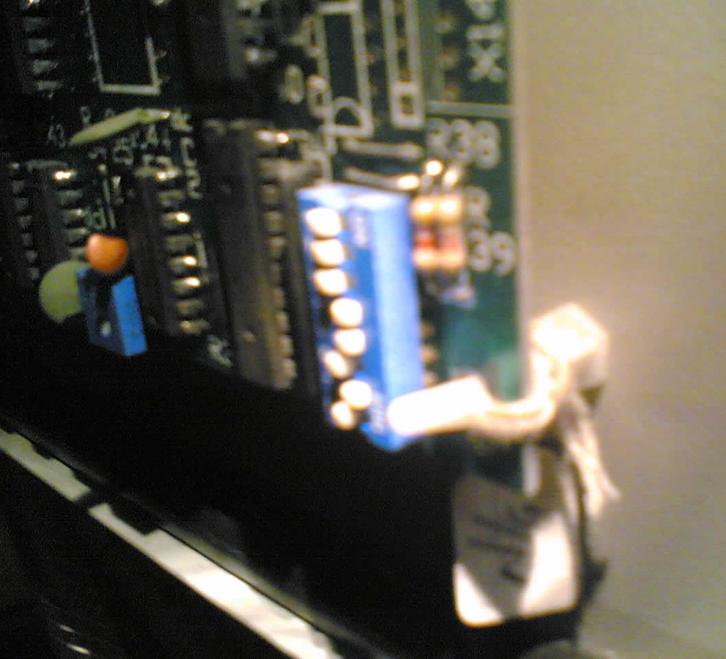

i have stupidly accidentaly knocked the dip switches
for the tool changer- it is for a TRIAC ATC 1990 PNC3 control. the switches are ranked 1-8 if anyone could tell me the correct settings that would be great... cheers...
I haven't managed to find any info on the toolchanger board used in the Triac, but it was a special variant of the North East Electronics SMCU controller that talked to the main Triac controller through it's own special serial link.

thanks
thanks for finding all that - much appreciated- will try and make sense of all that.. unfortunately the dip switch settings as they are at the moment have effected the tool changer so it no longer works..TOOL CHANGER ERROR!!!!
If anyone has the same machine (TRIAC 1990 ATC) i would like to try their settings for the dip switches and hopefully they would work???
cheers everyone...
cheers everyone...

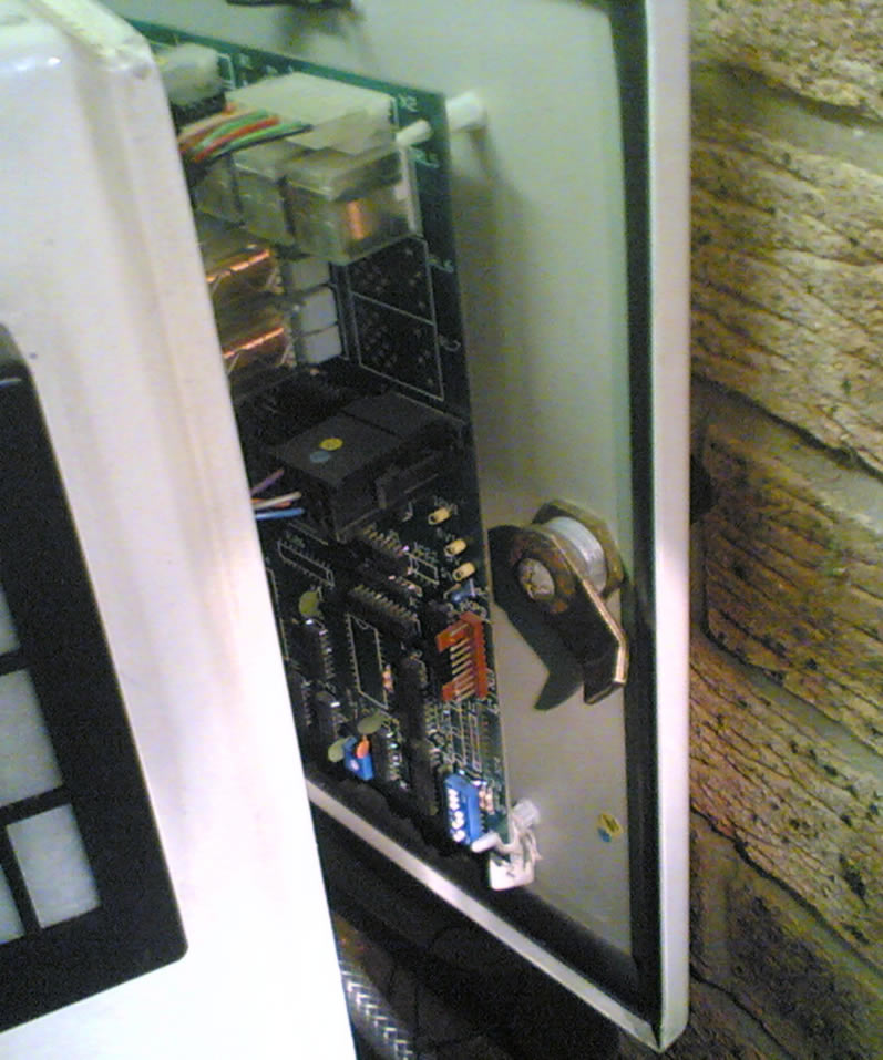

dip switche problem - tool changer...
the dip switches in the rear electrical box under the external monitor only seem to effect the tool changer- its these i need to reset.. the info you gave me does not sort the problem out- i could do with the factory default settings or someone who has the same machine to let me know their configaration..
thanks for any help......

red light
red light flashes continously with no breaks or pauses. everything worked ok till i knocked the switches- could this have corrupted the memory?? any way to reset?? the machine does not remember the tool in the spindle- it asks after datuming..
flashing LED sounds like the pcb is healthy (i was confusing triac atc with starmill re battery backed ram)
i have had another look around for info but have none. i hope someone out there can reply who has a similar unit.
just a thought... are the cables between machine and atc control box all seated ok?

dip switch location
the dip switches are located in the rear electrical box fitted to the inside of the door. the switch housing is blue and they are ranked 1-8 - 1 being at the top.. note pics below..
cheers...
cheers...
- dips1.jpg (120.17 KiB) Viewed 23221 times
