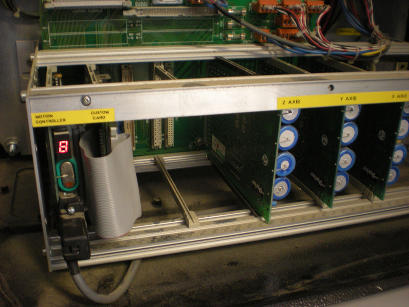

Inside the black control box the motion controller has an 8 showing on start up. After trying to start the spindle the 7seg display changes to L and the decimal point flashes.

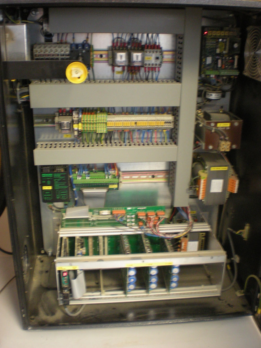

I have just checked the stepper motors and they can be spun when the machine is powered, the e stop button is not active and the machine is connected to VR Milling. I guess there is an issue with these not receiving power hence the not homing. I assume that all three steppers for each axis are supplied by the same power source.When it's powered on,estop is out and you're connected to VR milling, you will not be able to spin the stepper motors by hand.
It is a rack system. I have checked the seating of all the cards and these seem fine. I have also attached a photo of what I am seeing when the machine is powered and connected to VR milling. On start up the card shows a L then the decimal point LED flashes and it then displays 8Is this a rack system ? (is the Baldor card with the red 7-segment LED slid into a rack on the left hand side?)
- DSCN2087.JPG (299.21 KiB) Viewed 17823 times
- This photo is taken with the machine powered and connected to VR Milling
- DSCN2088.JPG (213.04 KiB) Viewed 17823 times

there are 3 fuses located on the rack base plate, just to the left of the orange stepper connectors. i have had these blow on one occasion causing the steppers to fail. the cause in my case was powering up the machine with one of the steppers disconnected and the driver board still in the rack
Re: Homing Problem on Triac
I agree, The power LED on the Sprint 1200 spindle drive is on so the E-Stop relay must be enabled.

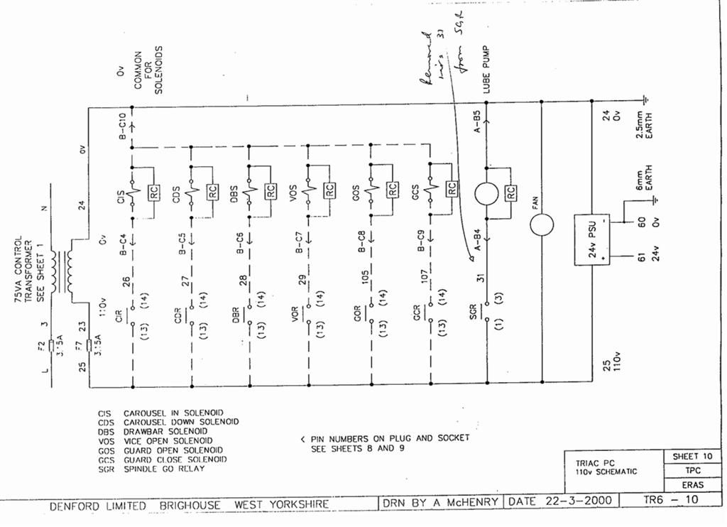

Thanks for your help so far. I have had a look at what could be causing the shorting out of the SGR SRR and through a bit of trial an error I have narrowed it down to wire 31 that comes out of the SGR. Without this connected the machine will connect with VR Milling and on M3 (Spindle Forward) wires 60 and 61 do not drop to 0V. The SGR switches but nothing happens due to this wire being connected. VR Milling stays stable and responsive. What I haven't been able to determine from the wiring diagrams is what wire 31 connects to. I have attached a copy of the wiring diagram that indicates it may be the lube pump but have not been able to locate any other instances of wire 31 in the cabinet. Any ideas on how to go forward from here? Thanks again.
- img-5251556-0001.jpg (76.1 KiB) Viewed 17773 times
Wire 31 would normally be part of the 100volt line which as you say would power the lube pump. It would also power any solenoids fitted, the fan in the cabinet & also the 24volt DC which is what is dropping off.
It may be worth testing the continuity of wire 31 from the SGR to the lube pump on the back of the machine.
