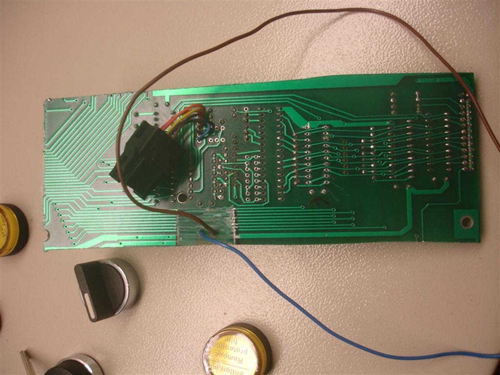

Thanks for the information, but if you search the Internet there is no info about the sensor.
So is there anyone who knows what type of sensor, data and wiring. It looks a bit poorly on the image

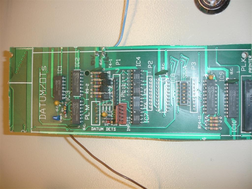

Ha ha it was creative!
my card looks like this.
you can find where to solder the cables.
is there anyone who knows?
