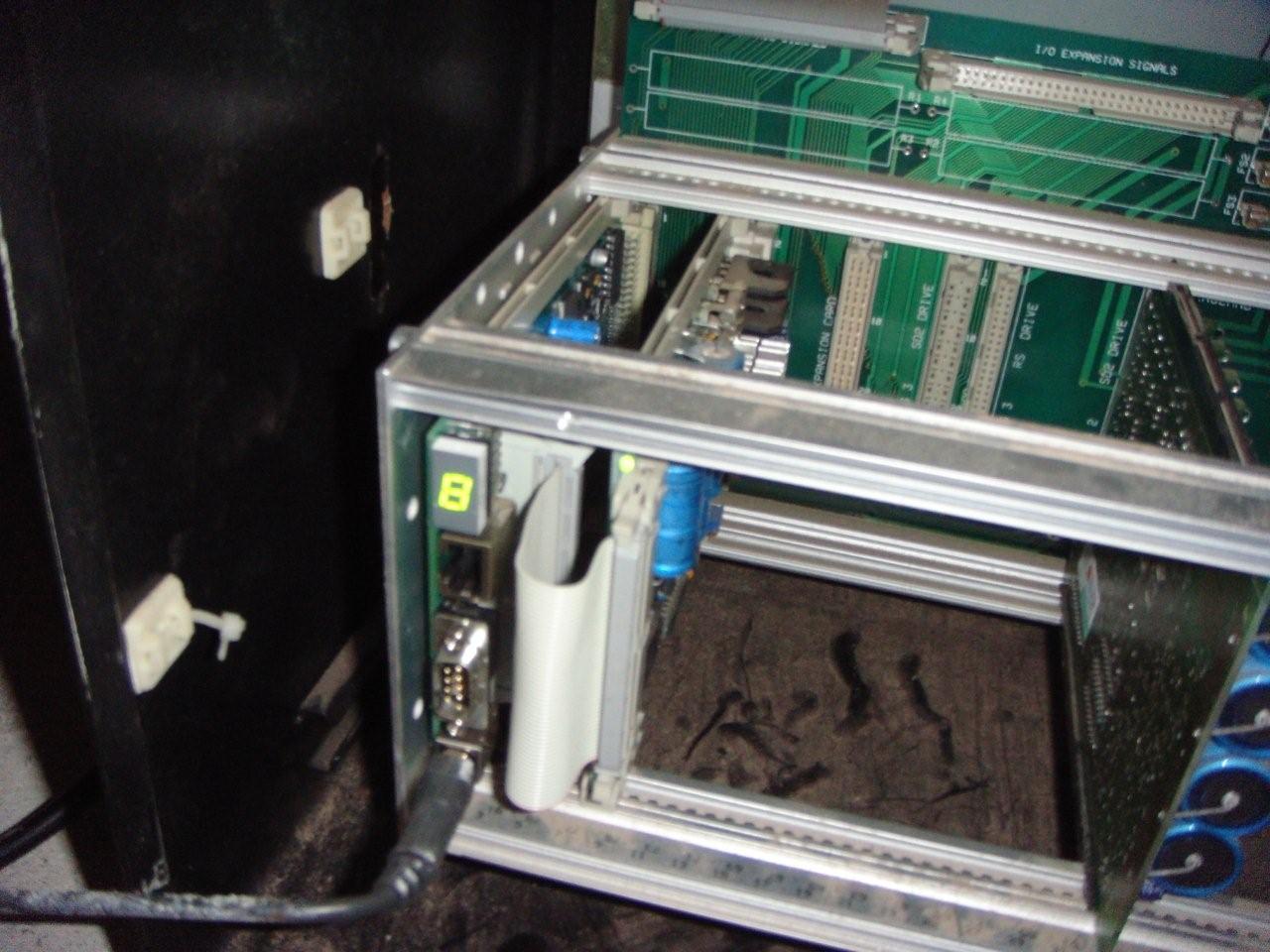

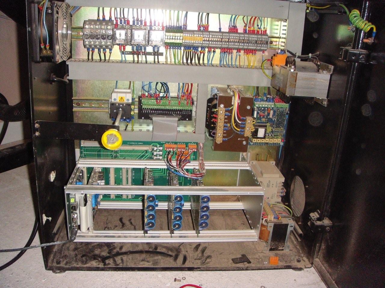

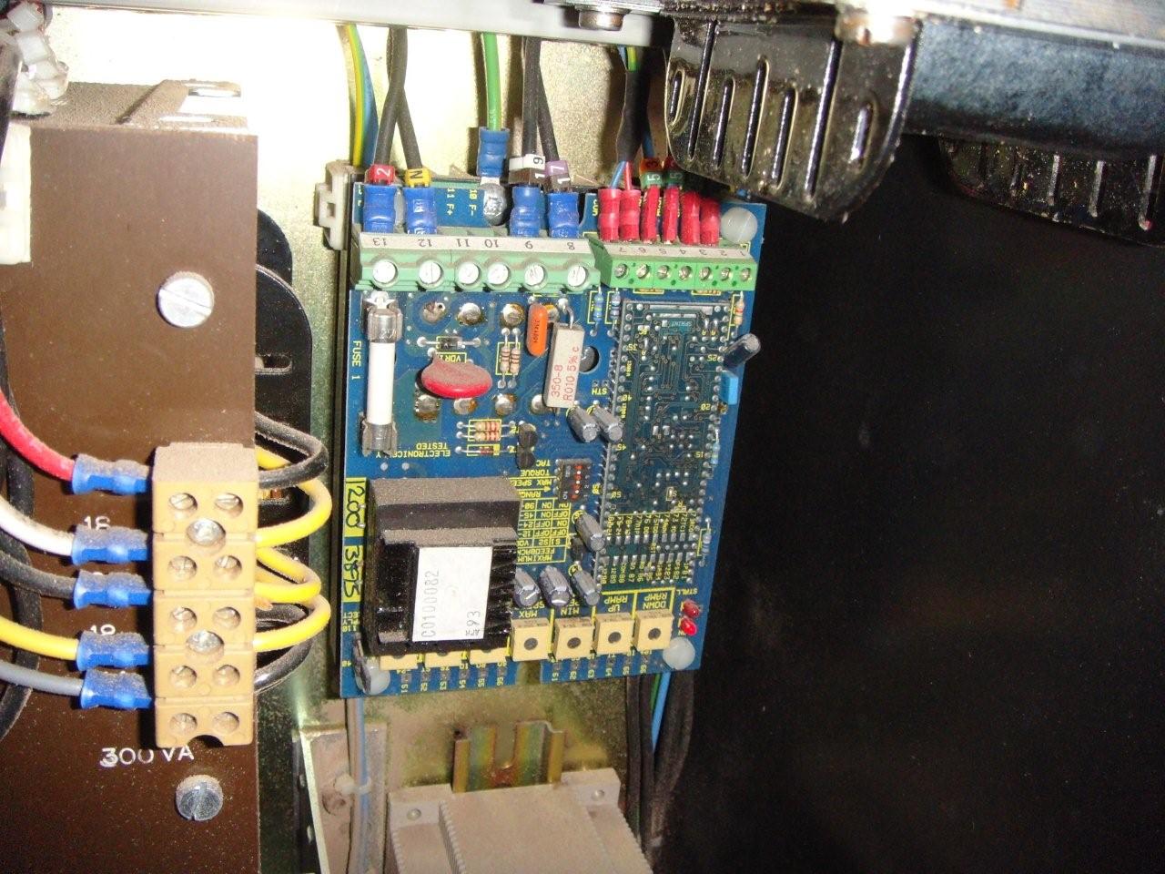

I have attached some photos of the controller hoping someone here can help me before my wife finds out I blew £2k on something broken :-(

Is the analogue control card the one next to the Baldor card connected by a large ribbon?....i.e 2nd from the left on the rack in my picture?
- Yes
And this picture should help:
viewtopic.php?f=15&t=634

Just to let you know I spoke to Sprint, really helpful guy (Jim) suggested I check between 1 & 4 for 10v, there wasn't anything (about -.3v) so we have concluded the spindle drive is indeed faulty. I have ordered a replacement (nice to know they still make them!) for delivery tomorrow.....along with a 10k pot to get me going manually.

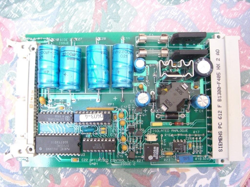

The card that is located next to the Baldor USB card does have an area marked out in the lower right next to the edge connector (not the ribbon end) that says analogue on it, no idea if that would be the drive analogue though?.

The analog circuit is on the card next to the one with the 7 seg display Linked by the ribbon.
Not sure if we can still get them repaired but we may have a spare removed from an upgrade.
Lets see where you end up with the spindle drive first as I am not sure on this rack version if the analog should be present offload.

Here is a picture of the card, it may help identification.

It's working again! :D but only with manual control :cry:
I fitted the new sprint board copying the dip switch and pot settings from the original and away it went.
After a satisfying myself it was all fine I decided to take off my 10k pot and try the analogue connection again.... as soon as I went to start the motor it took out the RCD in the house!.... which I have to say surprised me some what ...anyway I wasn't prepared to try that again so I went back to the pot and all is well.
I'm thinking that maybe the the analogue failed first and took out my sprint with it.

On the card photo you can see in the bottom right a section screened as Isolated Analog.
The spindle drive unit is not isolated. The Analog input floates at 240V. The control card should provide 0-10V that is isolated from earth.
It sounds like the card has failed which has resulted in the mains voltage shorting through this circuit and being connected to ground.
I would just try and trace the red and blue wires from the rack to the drive and check they are not trapped somewhere or shorting to ground. If it is a screened cable check the screen is not touching one of the cores.
