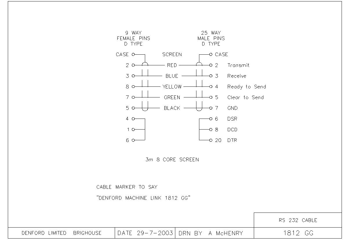

Yes originally I connected the 25pin RS232 to the 25pin LPT port (I have a taig mill that I converted to CNC which runs through an LPT port) but realising it needed to go to a com port I got a 25pin to 9pin adaptor, then on reading Lone_Ranger's post, the usb option sounded good from a reliability point of view as I will be doing some 3D work and so will need to drip feed. Then on reading Martin's post I thought I would have a go at making up a cable myself although I am confused by the wiring diagram, particularly the connection that seems to go across others to "case".
I have also tried to source an "off the shelf" cable but these seem very hard to find so the state of play at the moment is still one of utter confusion!!! :?
Posts: 1924
Post by Martin » Tue 05 May , 2009 20:43 pm
It`s the screen. The cable is made from a length of 4 core screened cable.

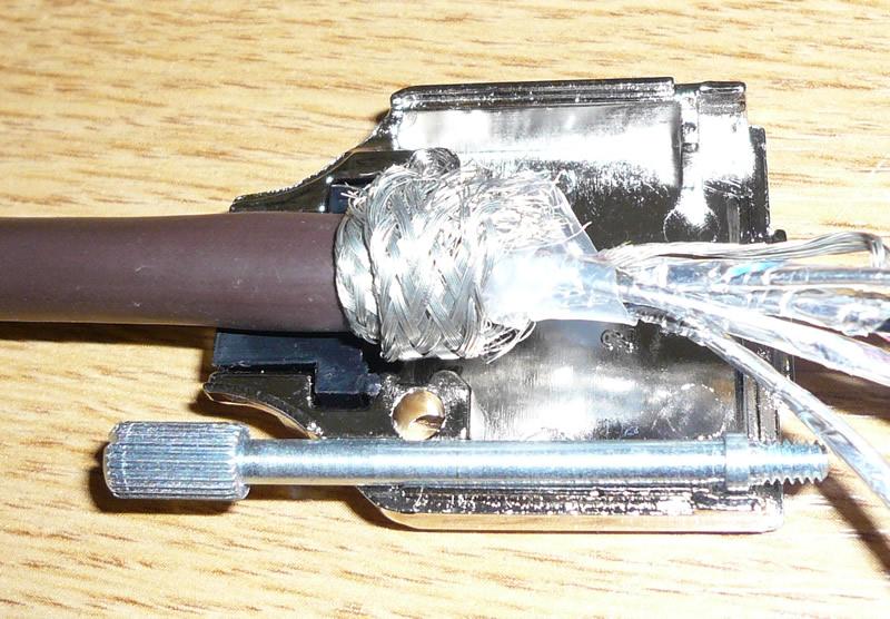

Post by Denford Admin » Wed 06 May , 2009 9:11 am
The dotted ring around the cables is the braided sheild.
This is normally clamped to the metal case/shell of the connector (see pic) with a metal spring clip which tightens up when you close the shell together. It's to provide noise screening as (hopefully) the metalwork you are screwing the connectors into at each end are both connected to Ground/Earth
Sheild connection would look a bit like this
