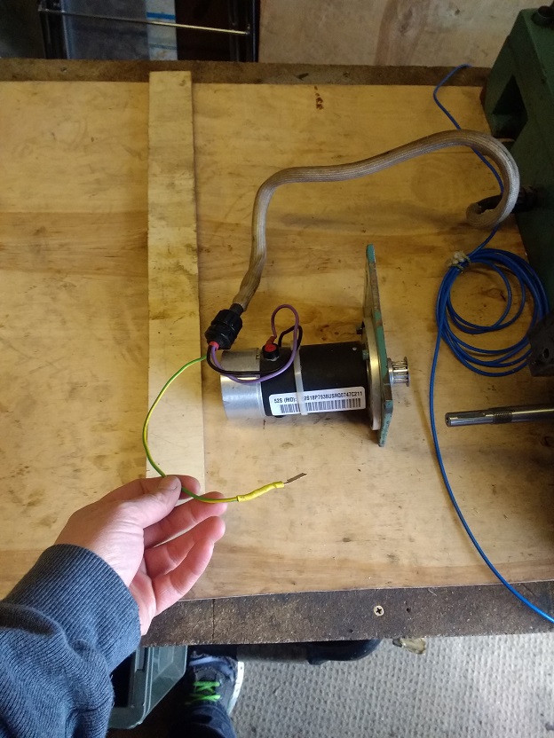

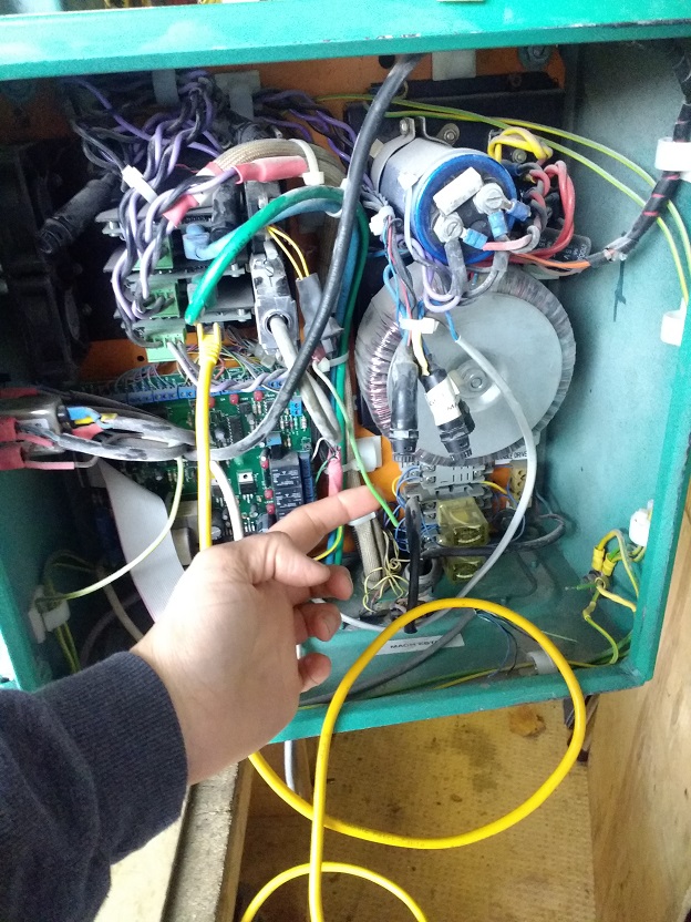

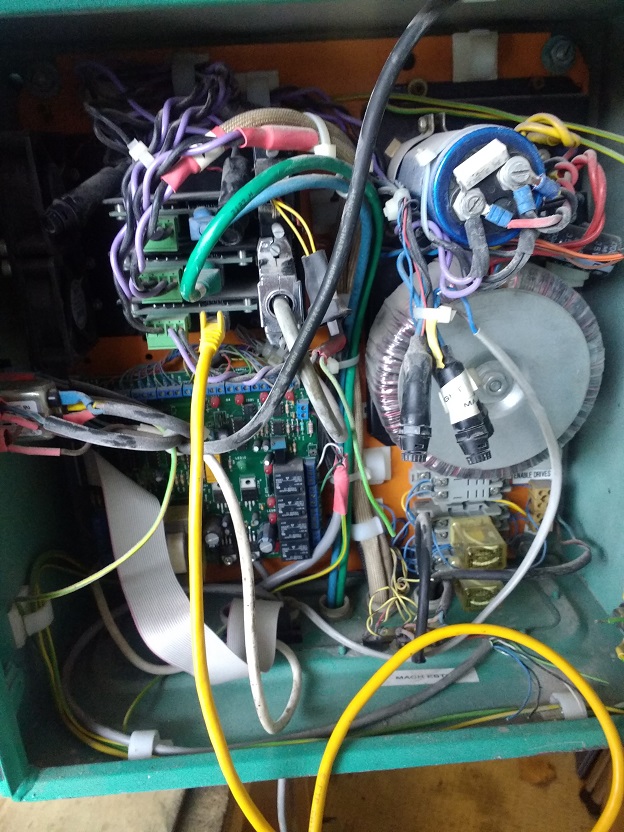

Hi Colin,
I do have a question if you don't mind answering?
Earlier in this thread there is a picture of the control box and there is a earth free (as in not connected to anything in the control box) from the Y servo - it is also free at the servo too. When I got the machine it had been connected to the servo mounting plate. I believe this isn't necessary as A - the other end of the earth isn't connected to earth and B - the motor body itself is connected to the machine so earthed through that anyway.
Electrickery isn't my strong point so just wanted to double check. I'm assuming all is good as the machine moved before I bought it but tripped on the Z and X when moved for a while which I think was mechanical more than anything (X ball screw very stiff and Z jib moving and jamming) - both are I think sorted now so hopefully I will get the machine up and running this weekend when it's all back together... about 10 years since it was converted :)
A few pics:
Loose earth - control box:
Control - finger earth.jpg (1.19 MiB) Viewed 19108 times
At the servo:
X servo.jpg (1.13 MiB) Viewed 19108 times

Without my finger:
Control box.jpg (1.18 MiB) Viewed 19108 times

Post by Rgvbaz » Sun 04 Mar , 2018 20:04 pm
Got everything sorted and back together...
Fired her up and she moves and everything. Next step is to sort the limit switches and cut some metal :)
Did a short video of her running:
