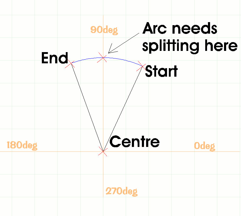

It's also worth mentioning now, that this vintage of control will probably only accept arcs within a 90 degree quadrant (see image)
Then you will be able to find out information about arc start point, end point, radius, centre etc.. from the CAD system quite easily.
- On early controls, arcs had to be split at the 4 quadrant points
- quadrant-arcs.jpg (56.26 KiB) Viewed 7502 times

Cheer's for your advice regarding the 2D CAD.Denford Admin wrote:You should be able to use a free 2D CAD package to redraw the shapes from what you have been given (just type "free 2d cad" into google!)
I have looked through the manual that came with the machine & it says that the triac will cope with any kind of line to arc or arc to arc intersection except where no intersection is possible, it does not say anything about needing to split the arc whilst programming it.
