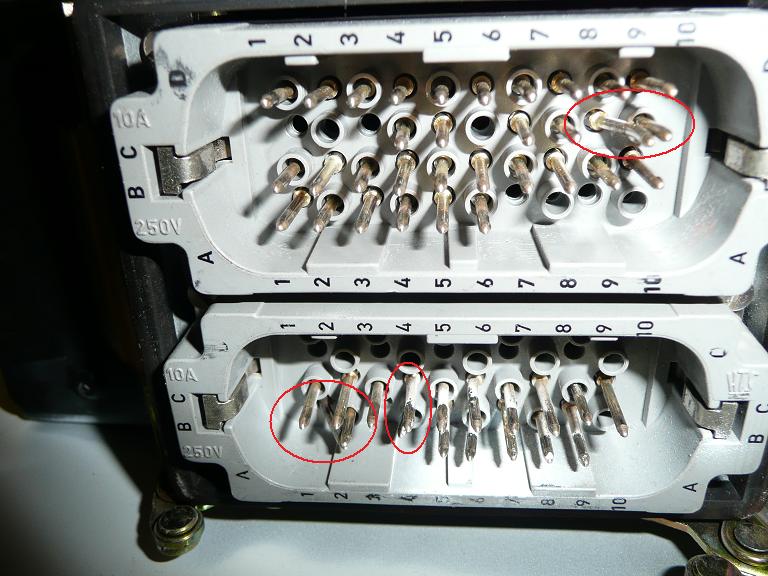

It may be something as simple as a pin in the Harting plug on the back of the machine. I would disconnect the connector & check all the pins visually. The male pins often bend but normally can be bent back quite easily.

Exactly!!!!
Not one but 3 pins were bent
They may have been bent when I got the machine or I probably bent them! One of the bent pins went to the x-axis motor - so no wonder the motor did not know where to turn.
Looking at the plug wasn't something I could easily do as the mill was wedged against the workshop wall! Which meant I could not see the pins of the Harting plug.
Bending the pins back means that the mill now homes correctly and all axes are operational.

This is what bent pins on the Harting connector look like.
This caused the errors above and I hope has not caused any other damage! With care the pins bent back to their near original position, though I was somewhat apprehensive at bending them - a broken pin on that connector would not have been welcome!
