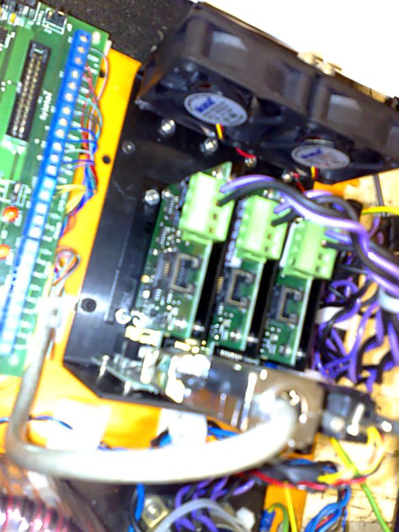

Sorry it took so long, as you can see it is still very much "on the bench" but its getting there, I am cutting the apertures into the cabinet now so i should be mounting the drives onto the machine shortly.

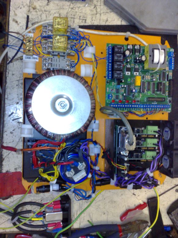

- drive boards and breakout
- 01042008254small.jpg (105.48 KiB) Viewed 27512 times

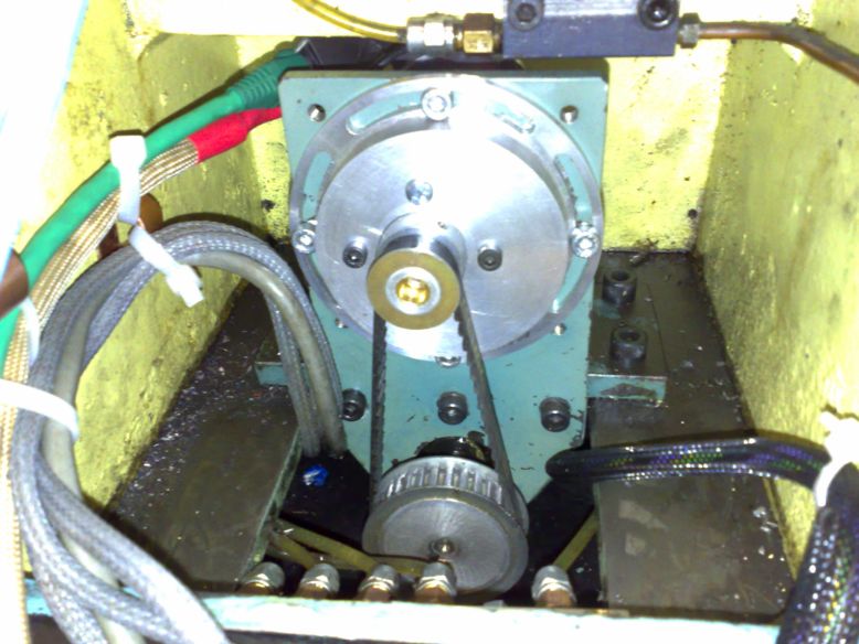

- X axis motor
- 01042008257small.jpg (84.06 KiB) Viewed 27512 times

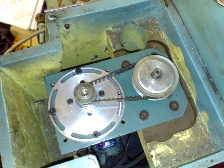

- Y axis motor mounted
- 01042008258smll.jpg (84.37 KiB) Viewed 27512 times

Wow, nice work.
What kind of encoders do you use, have learnt that there are a range of different types other than optical?
Are the excentrical placment of the motor in the bracket to be able to adjust belt tention?
I see three Rutex drives but two motors, I guess that you left the Z motor out in the pics?
How will you control the spindle, mach and an additional frequency converter?
Interesting project, keep the good work up.
Per

The encoders are hp 512 ppr optical with a mechanical gearing of 2.5-1 on the motors, this will give an resolution of 4um if i don't use the encoder in quadrature.
I could, sacrifice rapid speed for resolution but i think it will be quite good to see it doing 6m/min and 4um is not that bad.
You like the eccentric idea for belt tension,the motors are placed 5mm out of centre.
I will be using mach 3 and there is a frequency converter onboard the breakout board to control a vfd.
The power supply is 55v and the motors are 60v max, so this is going to limit my fast travis a little but i should still reach 6m/min if my maths are correct.
I could do with about 70v to really get the best out of the motors, maybe I will come across another transformer sometime.
I'll keep you posted.

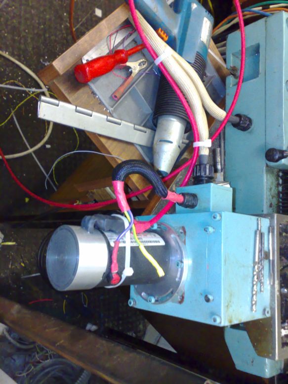

- Z axis motor
- 01042008259sml.jpg (81.94 KiB) Viewed 27482 times
Ahh, theres the Z-axis.
But as you mention 4um, how are you ballscrews doing? I have about 0.02 - 0.04 mm backlash in my axes (is that the correct plural form of axis in english?). From reading some in this forum the backlash could, and often are, source from the axial bearings rather than the ballscrews. Have you measured this, and have you made some effort to get rid of this?
I follow the progress with great interest.

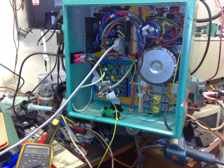

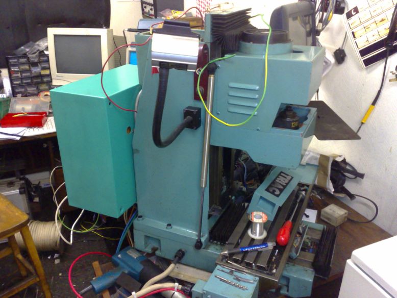

I mounted the drives in the control box and had the axis running using the tuning software
- drives in control cabinet
- 15042008286small.jpg (95.36 KiB) Viewed 27336 times
- cabinet mounted to machine
- 15042008288small.jpg (82.27 KiB) Viewed 27336 times
- Axis wired and run from tuning software
- 15042008289small.jpg (102.34 KiB) Viewed 27336 times
GOOD WORK!
I would love to see it run.
Myself, I was running stepper and old PNC3 today... it really starts to tick me off. Next big proj may be this servo mod. You made it look so simple:-)
Will be interesting to see a test report on accuracy and repetability and so on in the future, and also if you find the torque enough and just the general machining feel of it.
But as said, good work!
P.-
P.-

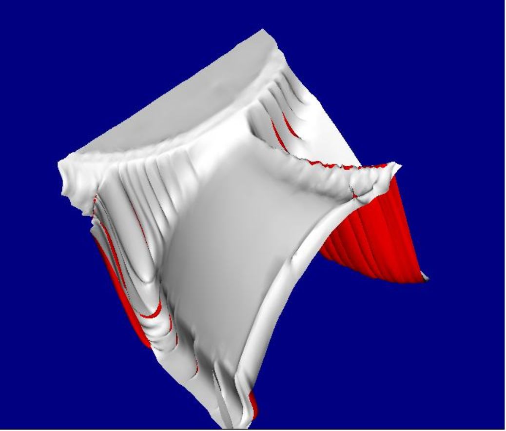

Here is a video of a digitizing program running in mach3 on a fan blade .
I will try to post a picture of the model created from the point cloud. Its not perfect as the fan was moving slightly and i used quite a large stepover but you can see the possibilities .

- Fan blade model
- fanblade model.jpg (53.64 KiB) Viewed 27188 times
