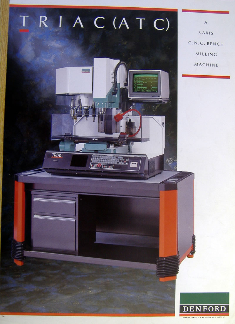

Roy
Posts: 104
Joined: Tue 30 Jan , 2007 20:20 pm
Hardware/Software: 1986 Triac modified & running Mach 3
Location: Bucks, UK
Post by Roy » Mon 23 Jul , 2007 12:51 pm
If your machine is as pictured (drawer underneath)
Then its the PNC 3 Control you have
Roy
russhop
Posts: 12
Joined: Sun 22 Jul , 2007 18:15 pm
Post by russhop » Mon 23 Jul , 2007 13:02 pm
Roy wrote:If your machine is as pictured (drawer underneath)
Roy
Looks like you have been in my garage this morning and taken a picture of my machine. I guess that means I have a PNC 3 controller
