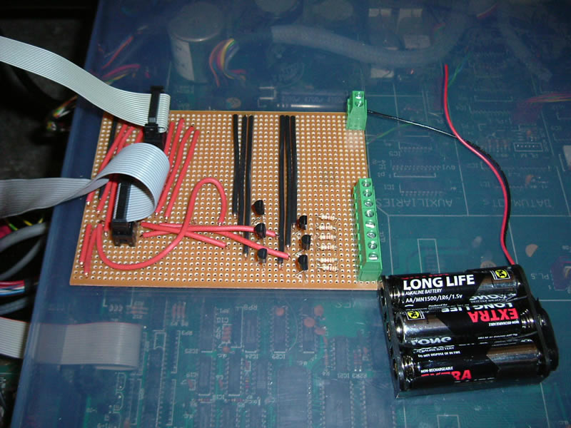

Problem 1) came about when I did a continuation test between drives motherboard and 16pin ribbon cable. By mistake I connected 24v to 0v ouch! No wonder I kept blowing fuses.
Problem 2) was due to the X,Y, & Z fault pins needing a 12V signal from the main machine borad to the drives board to allow them to run.
The machine feeds 24v from the motherboard into the main machine board where it is regulated to 12v and then, via logic, fed back though the 16pin cables X,Y &Z fault pins, to the drives motherboard enabling drive.

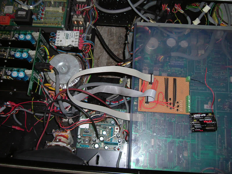

I have attached a couple of pictures of my circuit board. The bottom ribbon cable is feed from the drives motherboard and the top cable is taking 24v to the machine PCB and 12V back. The pins that are needed for this are just linked together between the two scockets on my board.
It is a bit untidy but it does work and has proved I can get movement. Once I have set up Mach3 and driven the axis from the remote computer I will probably build another board and put a regulator on it so removing the need to daisy chain bwtween motherboard and machine board. It will also allow me to move the board outside the Denford machine cabinet.
