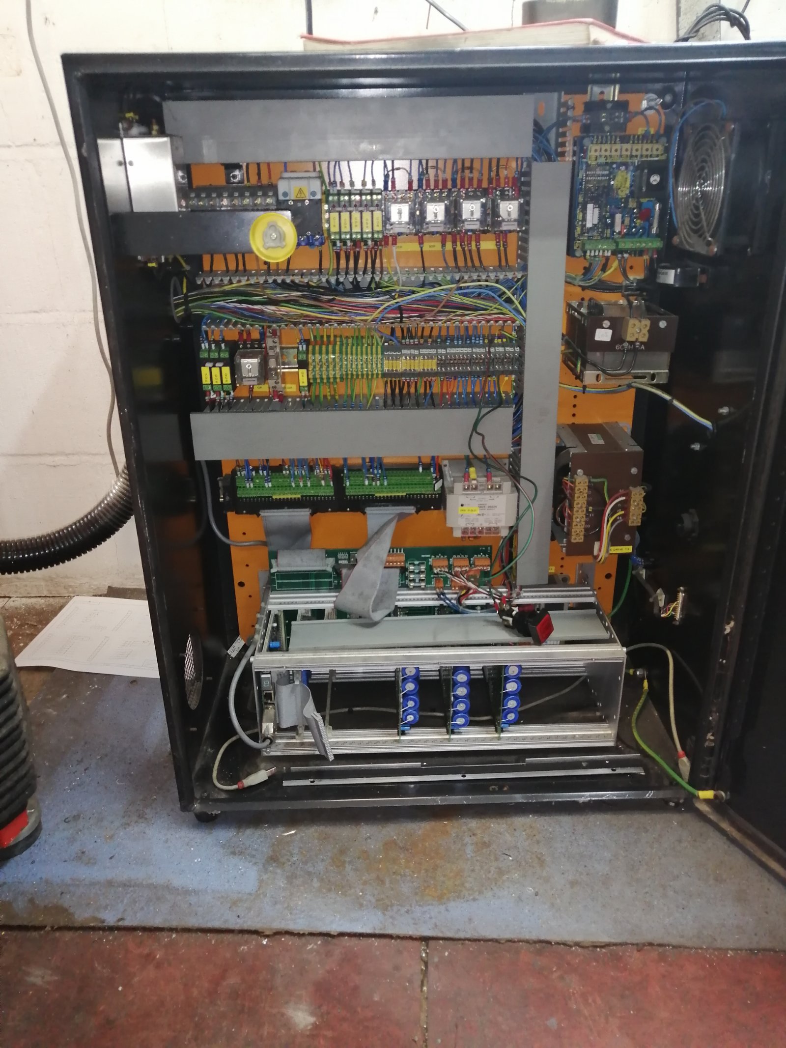

Here is a picture of the inside of the control box the extra temporary switch sitting on the bottom rack was fitted to simulate the machine E stop
circuit that we thought was missing this did give us the 24v supply to the control that we needed but unfortunatley it also seems to have disabled
the limits / home functions so when an axis was sent to reference it would not stop and would crash at the end of travel

Post by DavidB » Fri 15 Aug , 2025 17:46 pm
