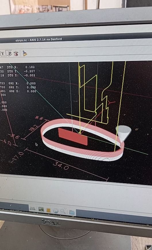

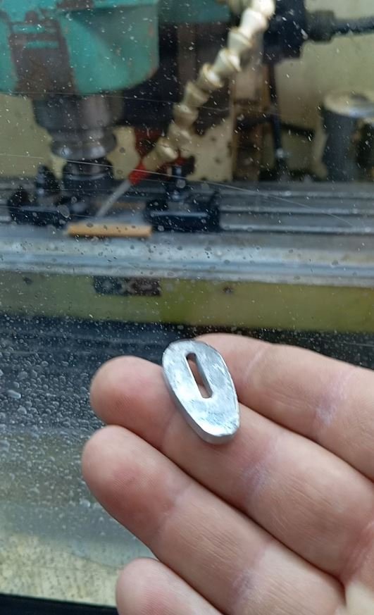

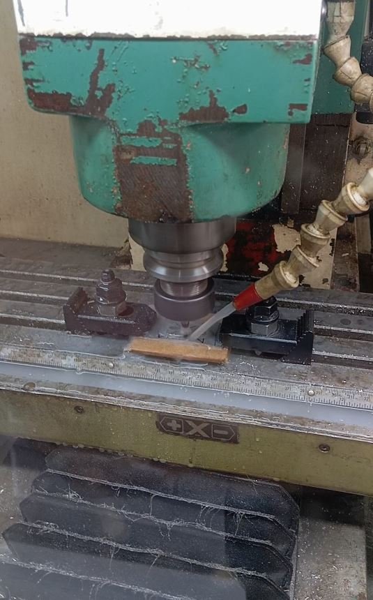

Post by MotoJack » Tue 24 Jun , 2025 18:57 pm
Thank you all very much for your help.
I decided it would be better to make a new control (DM556+LinuxCNC)
I am very happy that the machine works.
