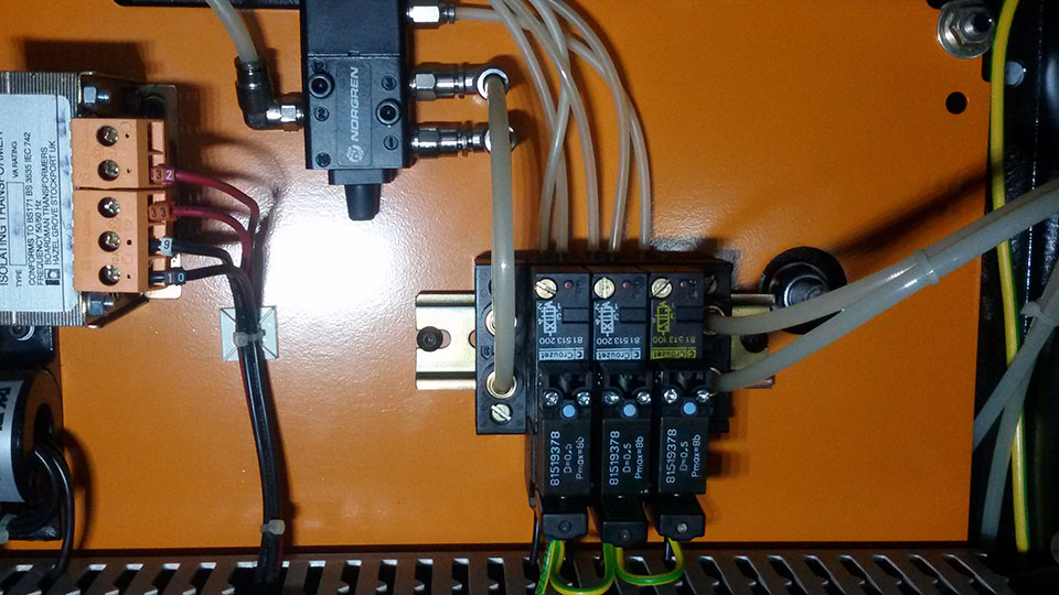

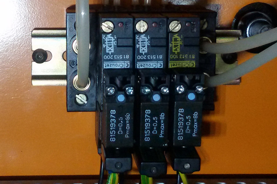

Re: Fanuc Triac - ATC Problem
I inverted the pipes to the cylinder last night, the carosel moved forward to the spindle, but when i inputted a M20 to retract it, i still failed to retract.
Put the pipes back on as they should be, then watched the soleniods. When i used the M20 an LED on the centre solenoid lit up but when I used a M21 it didn't.
Don't know if this helps, the machine looks like it has been in storage for a while, so i guess some oil could have gummed up the valve.
Am I right in thinking that test indicates a problem with the cylinder?
I guess I should check the seals on the cylinder to see if any air is escaping.
