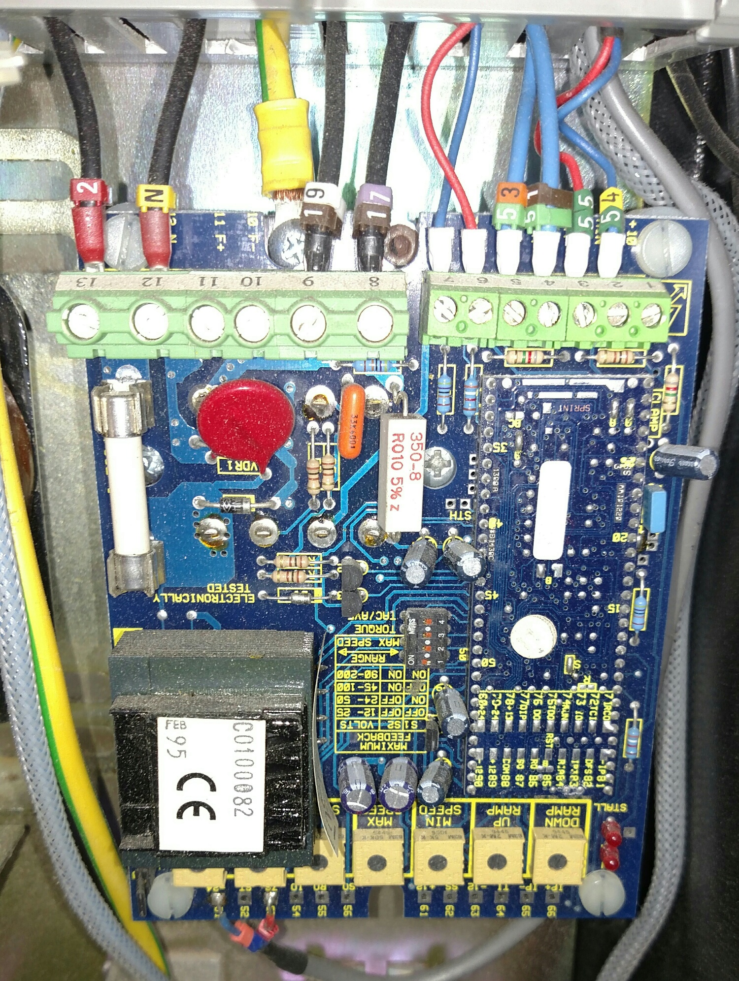

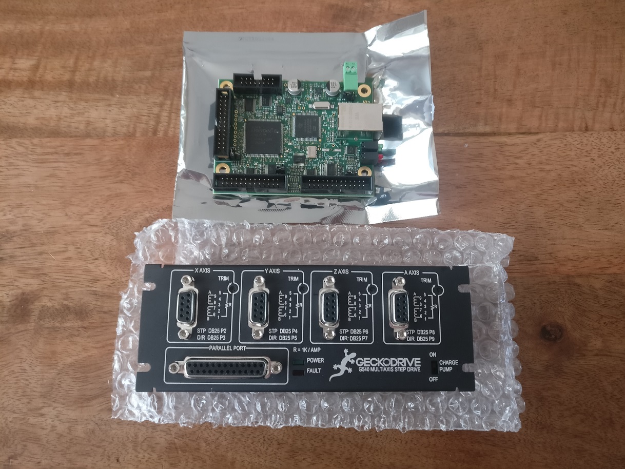

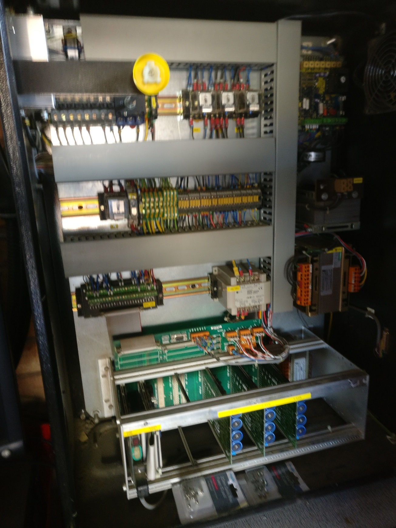

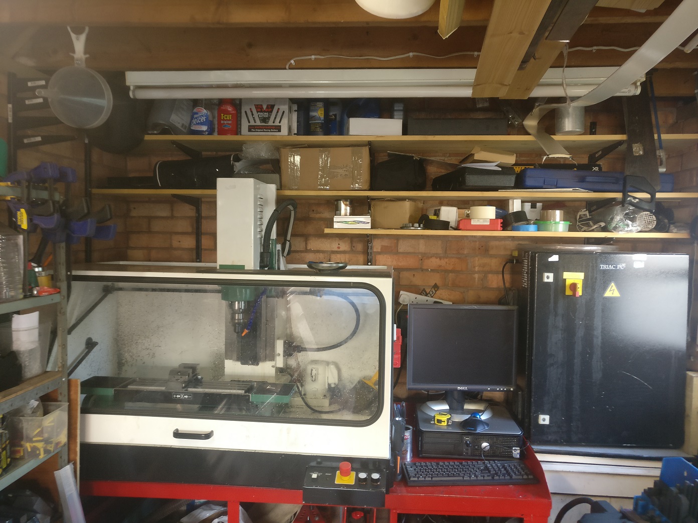

I'm starting to upgrade my Triac to Mach4 using a smoother stepper (ESS) and a Gecko G540.
I am hoping I can document the conversation here to help other in the future.
- triac.jpg (580.75 KiB) Viewed 22986 times
- ESS_Gecko.jpg (536.98 KiB) Viewed 22986 times
- Electrics.jpg (720.38 KiB) Viewed 22986 times

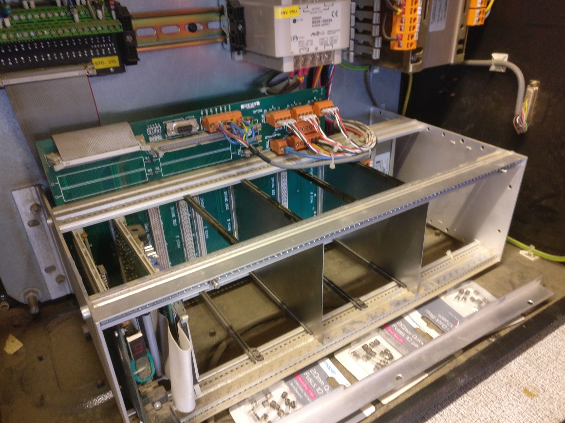

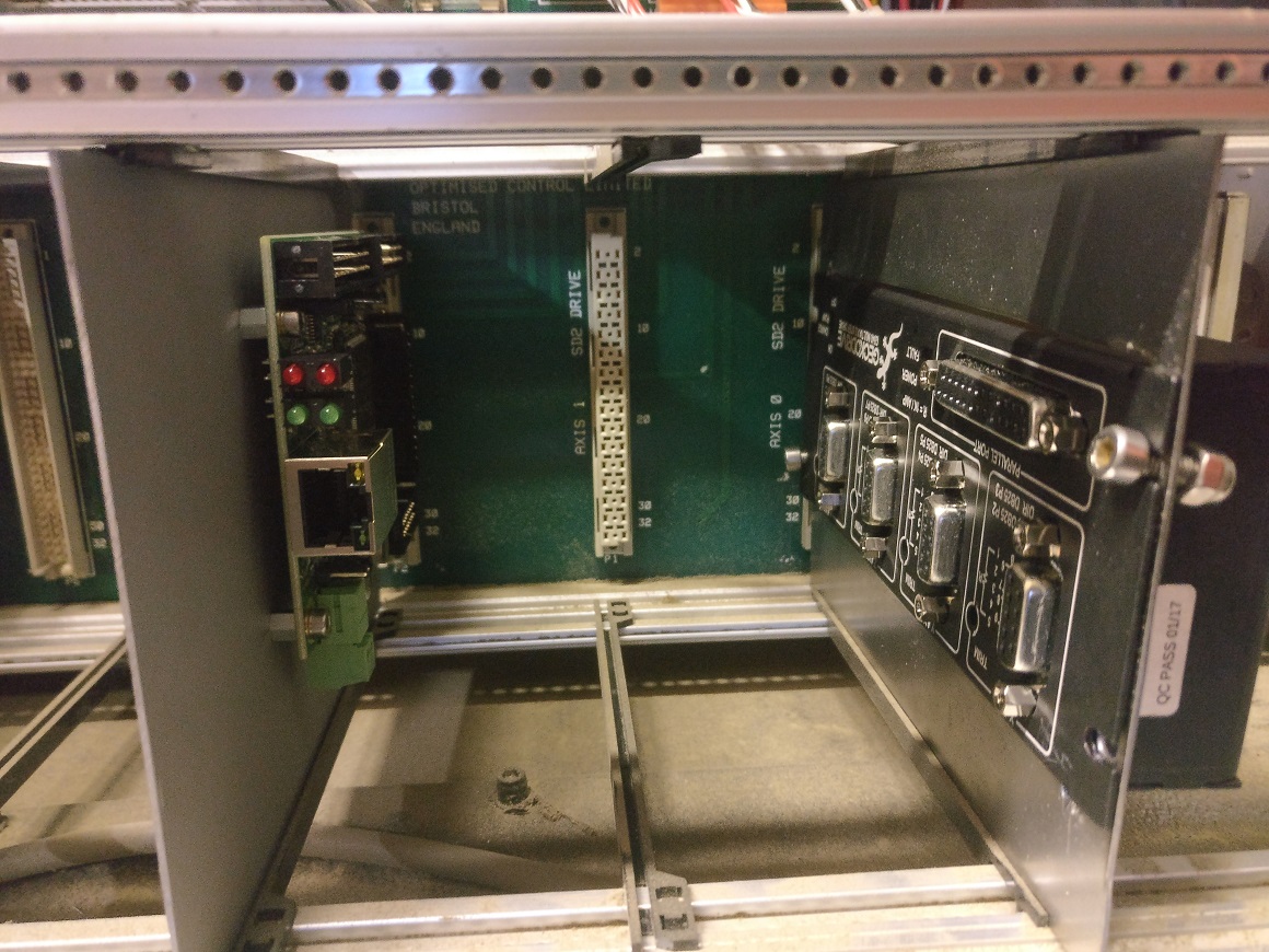

Update:
- Made some blanks to replace the original stepper drives.
- Blanks1.jpg (508.7 KiB) Viewed 22975 times
- This is a test installation of the new controller and stepper drive
- Installed1.jpg (520.1 KiB) Viewed 22975 times

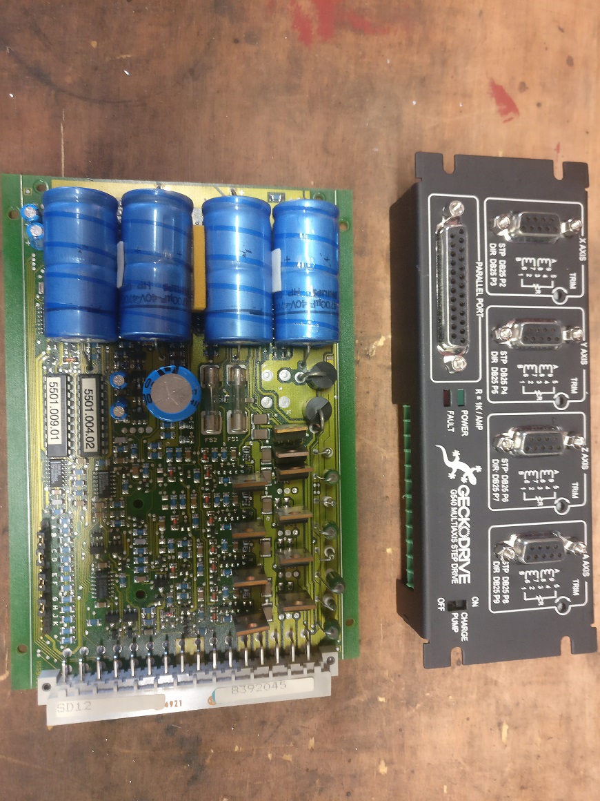

- Comparison of the original parker driver and the new Gecko drive
- stepper1.jpg (547.43 KiB) Viewed 22975 times

I have the X axis wired and working and I have moved on to the spindle and I have run in to some issues.
There are 2 outputs on the Gecko G540, these are wired to the Spindle Go Relay (SGR) and Spindle Reverse Relay (SRR).
The spindle speed is controlled via PWM on the Gecko, with feeds from the sprint spindle board. Reference, +10v and input speed.
When the spindle is activated in mach with a speed of 500 rpm the SGR relay is switched and there is a voltage of 1.25v at the spindle board as expected, however the spindle doesn't turn.
If I try to run the spindle in reverse the SRR is activated and there is 1.25v at the sprint board input and the spindle runs just as expected.
Have I missed something?

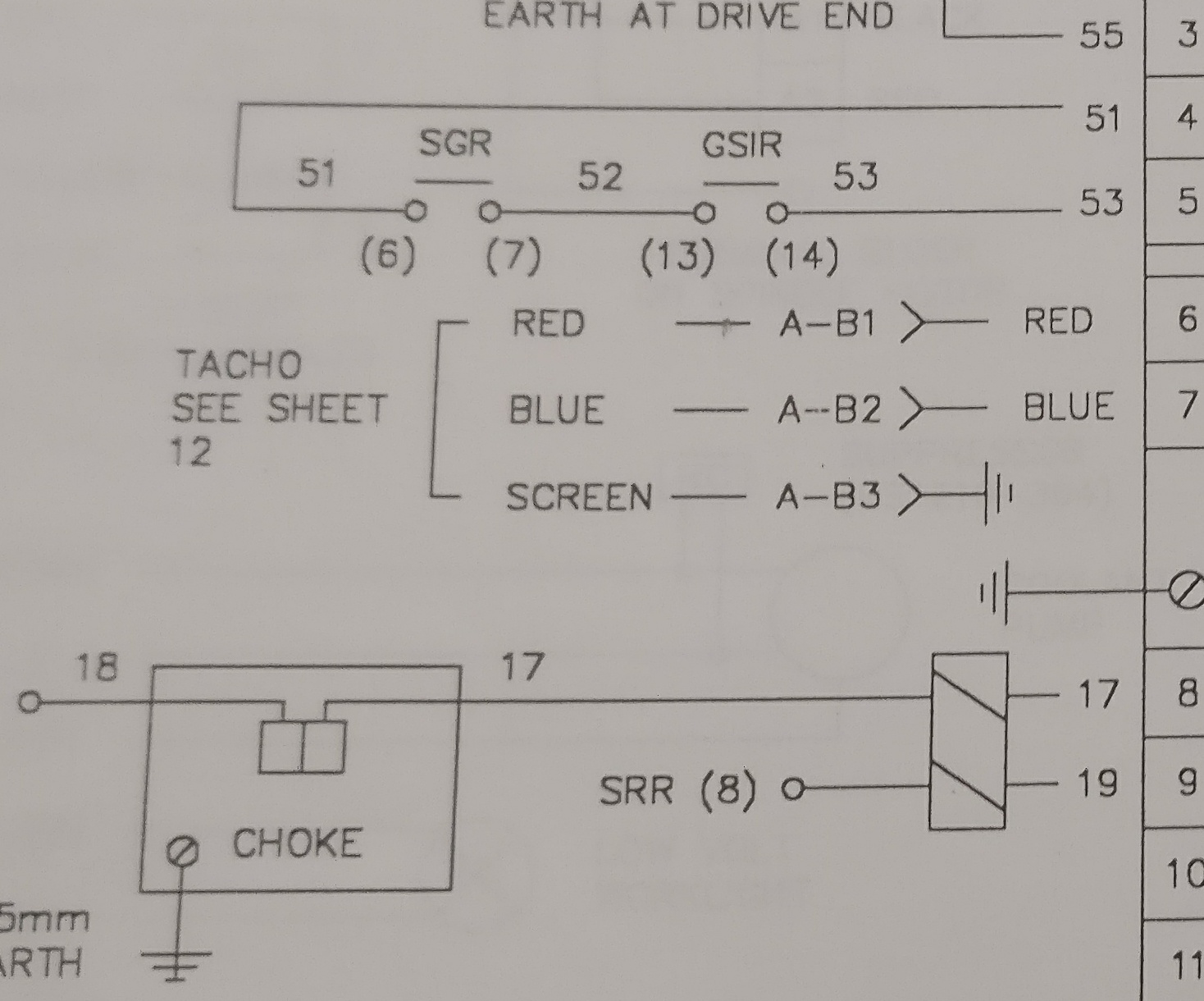

Do I need to switch the Guard Spindle Interlock Relay (GSIR) too?
- IMG_20170708_115647_01.jpg (327.55 KiB) Viewed 22936 times

Re: Mach4 Conversation - Gecko G540 - Smoothstepper
This is fixed now.
It was an error in the Mach configuration.
The Gecko Drives the spindle perfectly.
What a relief!!
What a relief!!

So I decided to do the conversion to Mach 4 also. I started hooking things up last night and I think everything is making sense except I am a little confused and cautious with the spindle board. If I look at the writing on the spindle board pin 1 says +10v, pin 2 says min (ground?), And pin 3 says I/P (0-10v?). Is this correct? Before I started unplugging all the original hardware I was probing around and came to a different conclusion, but now that I have dug into this a little I found the writing on the board which I now can't confirm (because the original hardware is no longer in working order). Any help is appreciated.
Also, it appears my homing switches are 2 wire... They never go to 0v but instead are below 10V when not homing and 12v when homing. Has anybody tried wiring in a MOSFET to get a true on/off signal?
