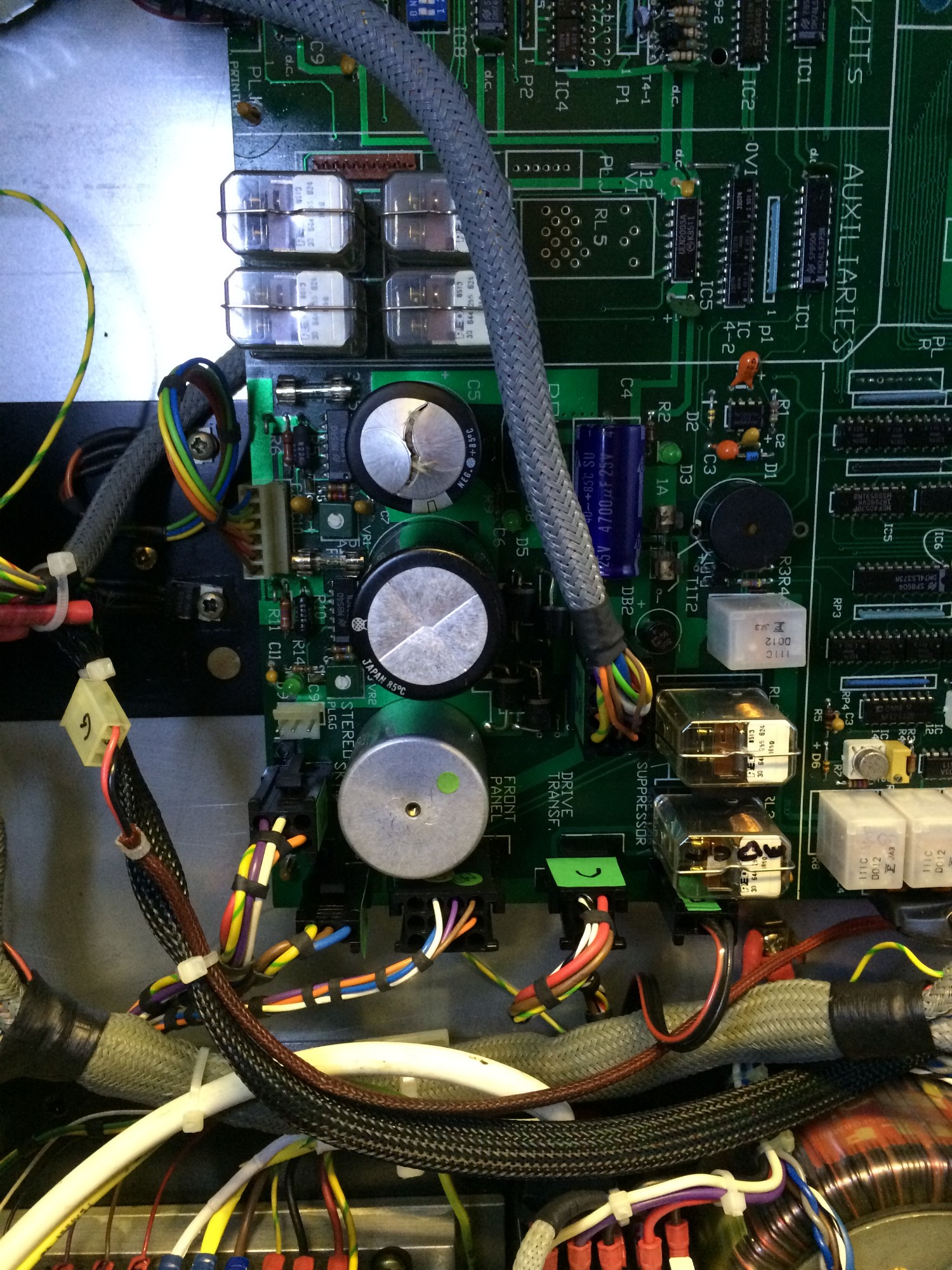

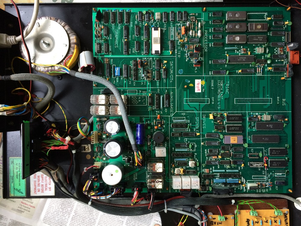

Here is a view of the complete set-up in the old drawer, and then in the new cabinet.(a few weeks ago before wiring complete)

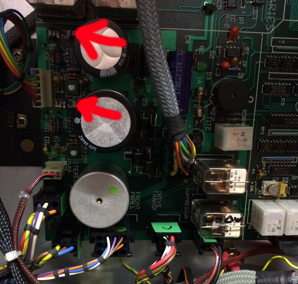

The last one shows a close up of the problem area, (fuses removed)
Its fuse F2 & F3 which are both 3.15 Amp time delay ones.
Cheers, Roy

However after turning the drives off this morning & then switching them back on, this capacitor has blown. !!!
Whats going on? Is it possible this capacitor was on its way out and causing the fuses to blow?
