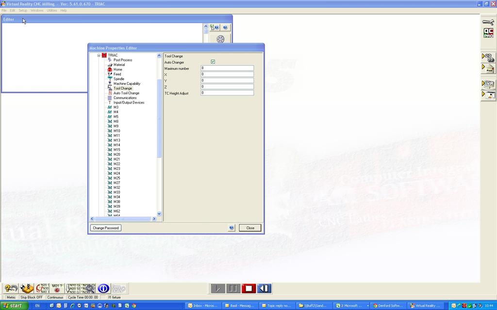

our machine does not have auto tool change
Re: Triac won't run programme
If you have a manual tool change then you should have a message telling you to change the tool manually.
Sounds like you have configured the machine incorrectly so it thinks it has a tool changer.
Go to the setup menu
Setup machine parameters
Password is "denny"
Click on toolchange and uncheck the tick box.
Password is "denny"
- screen1 (Large).jpg (56.53 KiB) Viewed 9536 times
Problem solved!!!
