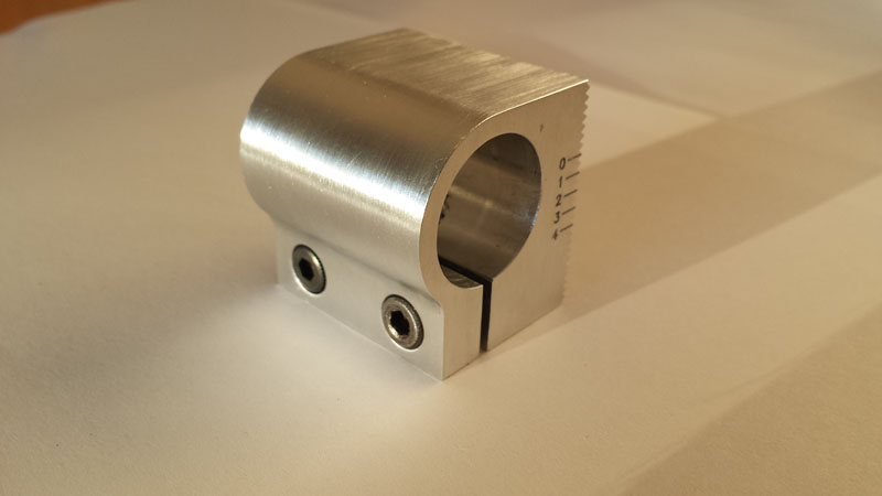

After much reading up on various other issues all of which were dealt with on this forum, I am finally up and running. Thanks to all who contribute to the forum your help is greatly appreciated.
Below is a picture of the first job done using the Triac.
