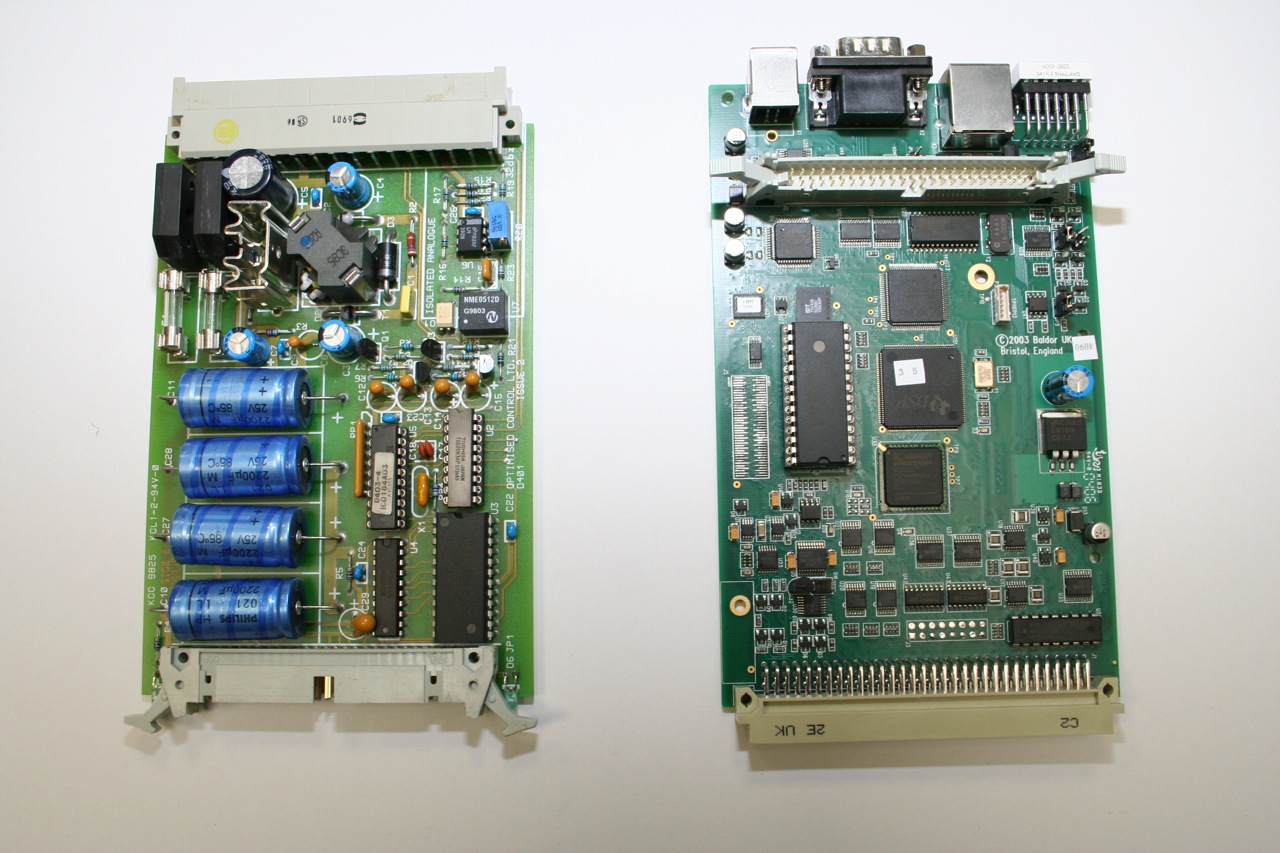

Hi again, we have removed the bellows and covers and cleared the machine of all debris. we have checked the boards and ribbon connectors and cannot see anything wrong. The Y and Z proximity detectors are working in reverse, manually operating them causes the lights to go off on the debug board.changing the software limits I can drive the axis over the switches but they do not operate. the machine was upgraded to the balder control. I have attached photos of the circuit boards

Post by Denford Admin » Thu 08 Mar , 2012 18:13 pm
Do you mean they don't change state in the debug I/O or they don't work when homing ?
If they only change state when you manually place some metal in front of them but not when the axes are driven over them, then either the metal actuator on the axis is too far away, or something has altered the sensing range of the proximety switch (either old age or supply voltage is too low/incorrect)
It is probably the voltage to the prox switch is too low from the Baldor (5V) and needs a 12V solid state relay driving from the prox sensors.
Have a look at this post - there is a specsheet for the switches if they are the same as yours...
viewtopic.php?t=2621
