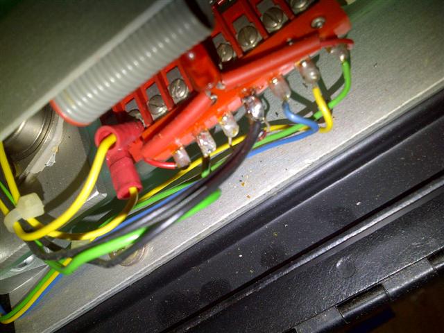

Re: Triac power problem
Ok,
I have tested the voltages with the wires disconnected, and between pins 4 and 5 I get approximately 7.8Vdc when spindle speed was set at 1000rpm. It then steadily decreased until the machine faulted out.
When I connect the wires back on, the voltage is not there.
I am guessing that this is what you expected to happen?
Any ideas why?
Here is a pic of the terminals on the fanning strip.
I really appreciate the help guys
Any ideas why?
- IMG-20111115-00045 (Small).jpg (53.89 KiB) Viewed 8269 times
there is one other thing to try on the fanning strip.
You can manually run the spindle by removing the wires from 4, 6, 7, 8 and 9.
Then get a PP3 9v battery and connect it up to 4 (+) and 6 (-). and take 8 and 9 to a switch. Turn on the triac and close the switch, this should give you near full speed.
PS. have you removed the jumper wire you put on the main contact strip.?
- CNC Apprentice
- Posts: 35
- Joined: Wed 09 Nov , 2011 17:17 pm
- Hardware/Software: Triac '87 converted to mach3
Orac '85 converted to mach3
Hi angel-tech,
Thanks for the reply.
I have just tried that, and still nothing at all. Does tis mean that I need to look for a replacement Brown&Pestell drive because this one is caput?
Paul
Paul
