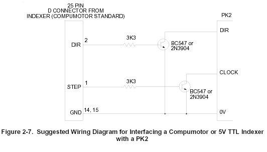

Hi Steve and thanks for your input.
The stepper drives are still the original PKS Digiplan SD2 items driving the original motors. They are interfaced to Mach3 by a simple transistor array (see attachment) though I will be changing this to an opto-isolated creation if I can sort out this distance loss issue.
I have only tried the measurements over 12.7mm as my Imperial DTI is limited to around 1" range. I could experiment with larger distances but would have no way to accuratley measure them. For example at 127mm I wouldn't be able to get 0.030" accuracy. I suppose I could fasten my digital caliper to the table and have a go with that.
Spindle is currently disconnected and is not wired into either supply, though the Lynx08 motor controller still energises when the panel is powered up.
As the Lynx08 comes on with the main contactor it would be difficult to do what you sugest, though I could do the opposite and remove the supply from the Lynx so it cannot have an effect.

add 100nf caps on all inputs, i had problems with added and lost steps before adding them.
I use the same transistor buffers and have had no problems since adding the caps.

The capacitors would be a ceramic bead type so it does not matter which way round they go.
Fit one end to the ground wire the other to the input of the PK2 unit.
What is probably happening is that when the transistors are switching on and off the voltage is not a clean switching level and the change could be registering twice. This could cause stalling or the addition of steps.

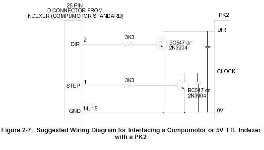

As far as the capacitor modded circuit is concerned, is this what you mean?
Also, considering the old age and delicate nature of the PKS Digiplan SD2 units, are we pretty safe installing these capacitors?
Since posting last someone pointed out the error in my maths as I have lost around 20 pulses togive the error recorded. Is there still a chance noise could lose this many or is it looking more like mecanical backlash?
...Sweep
...Sweep
- digiplan interface cap.jpg (17.13 KiB) Viewed 25516 times

Your diagram shows where I would try placing caps. along with short well screened cable this must help.
Angel-tech was suggesting adding caps in the same way yo the inputs of the e-stop and home inputs of the controller.
