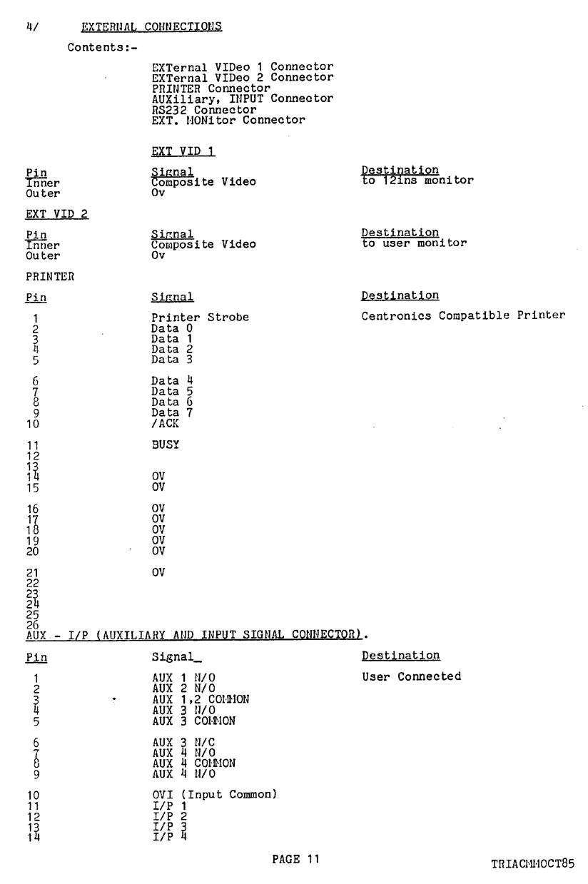

There is a guy asking about the ATC connection details (to the 15pin connector at the back ?)
viewtopic.php?t=875
I found some original working drawings and put them in the Download section , but maybe you're manual is clearer ?

Post by dwynkoop » Wed 11 Apr , 2007 17:10 pm
I dont have a atc, but here is the auxiliary input page. Its the same as your link, but has all the pins.
